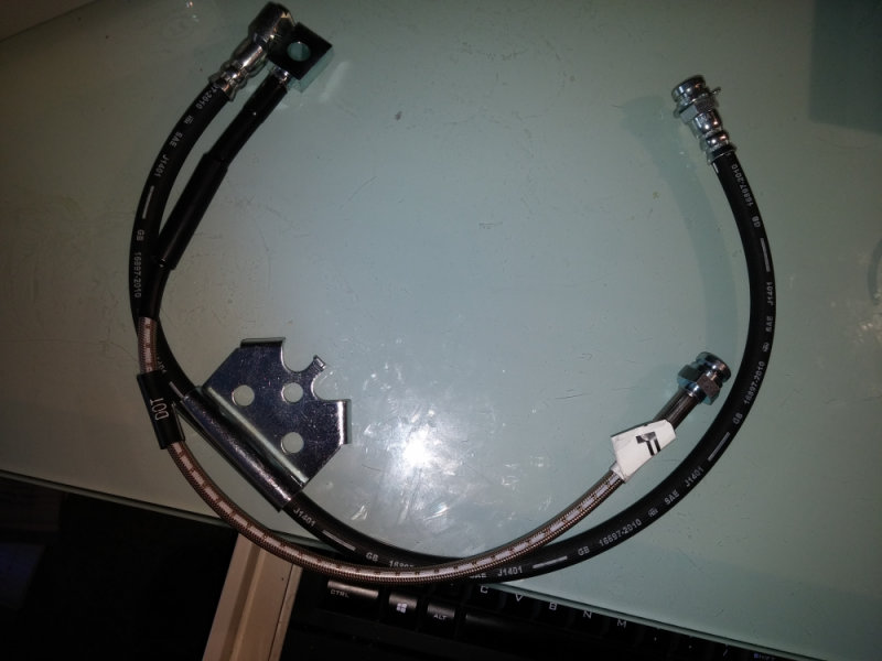

Oh and I've done that for years as well on sports and vintage exotic cars but ... looking at the installation on this vehicle I don't think I can make this work properly without that center securing bracket clamped to the hose. It keeps a lot of bad things from happening to the hose. IMHO the hose could even do with being an inch longer on the body connection end. It's stretched pretty tight at full lock.

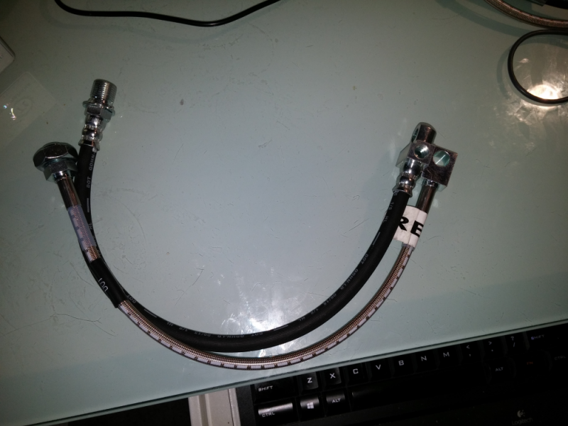

The russel stainless hoses are shorter than the stock ones because they route differently than stock.
OH? I took a shot at the Russel hoses thinking they themselves might be misinformed. But they did tell that they would not fit.
Those fronts are really a lot shorter? The rear one is not as much shorter but I don't know if the could work.
So do yours snake up and through the upper A-arm directly to the brake line union instead of running to the outside and around the upper ball joint to the front brake line connection point.?
With my left wheel all the way to the left it does reach OH and is about 1 " from the the A-arm but I don't know what it would do when that wheel was turned all the way to the right?

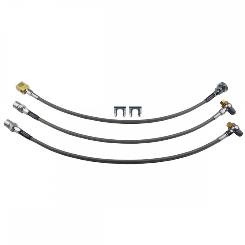

Inline can make the hoses or you can just buy the pre-made ones the show in their catalog. They have them at 27" for the front which is an inch longer and my guess is that isn't a problem. Then use rubber lined hose clamps (a pair) to secure them to the top of the A-arm where the metal bracket did. $25.00 For the rear they sell a drop line that is 18" for $25.00 They even have a 1/4" version instead of 3/16"!
The fronts have the round banjo head and Earl's sells the proper square one 9977031ERL. So you can just pick you own end fittings instead and them pick the designated hoses separately. It's more money that way but you get it pretty much exactly right that way. Check their catalog for hot rod stuff. They have everything except for the Earl's square banjos.
I could use my Russell rear hose but it's a 3/16" hose, so is my oem. I got these as an open package buy for $26 but I think I'll send them back and do everything exactly like I want with the Inline stuff and Earl's banjos. You can also utilize any ones hoses with their solutions outlined in their catalog as they specify total length with fittings as well as the hose length required.

Thanks for that. The Russell kit I got has fronts that could never do that and I wasn't comfortable with the potential for interference by going through the A-arm as it looked like a lot of rubbing could occur, so I used Inline's adapters and the new line will route just like the OEM one and get secured right under the upper ball joint on the outside of the knuckle. I'm working on a cushioned hose clamp solution now for that.
There are three 3/8" holes in the OEM securing bracket which is quite robust. I'll have another look today but I doubt you need 3 bolts there. So I think a pair of clamps should do the trick.
It turns out only one of the three holes are utilized. I wanted to find out the bolt size and thread but I'm concerned about removing it at full lock and then being able to get it back in. In my present situation I cannot take a wheel off to do this. :grumpy:
