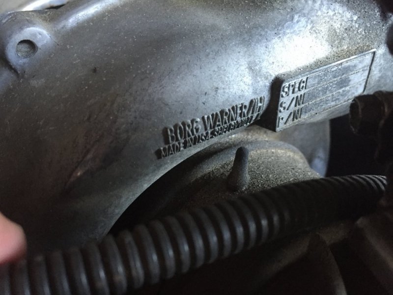

I think this is the stock GMC Turbo.
Yes that looks like a stock GM-8 by the spec tag.
The ATT and tune would be excellent for you. The only reason I ran a Holset is that it was given to me for some work I did.
