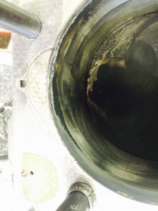

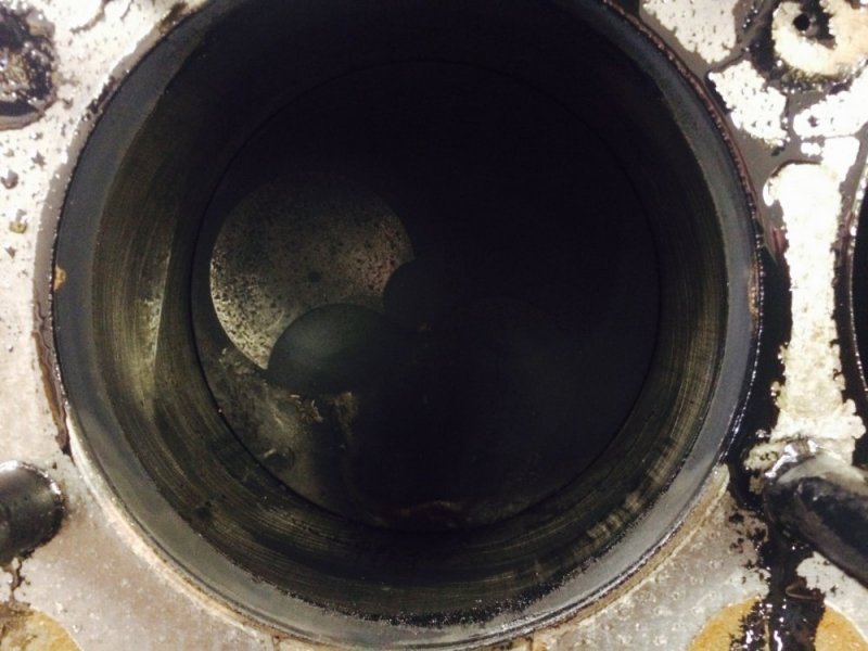

Update: I was planning on pulling the engine this month to put a stock camshaft in but a fragged flexplate forced me to pull it a couple weeks early. I was tired of the shaking/imbalance that I can feel while driving this and the cam seemed like the biggest wild card so I figured I'd swap a stock one back in. Also I found out later that this cam likely isn't giving me more power and may in fact be costing me power down low....so much motivation to try a stock cam. This afternoon I finally got it torn down further. I noticed that most of the exhaust pushrods had been rubbing on the heads due to the 1.6 ratio rockers. I really didn't want to disturb the head gaskets but I am going to do it right and pull the heads to clearance them rather than risk getting metal in the engine. I really was curious to see in the chambers too to see if all was ok with the precups. Yup the precups seem ok, but wasn't ok was the pistons!! Apparently I've been getting contact between my intake valves and pistons!!:eek::mad: Also the edge of #8 is partially melted. So good thing I tore it down the rest of the way. New pistons and intake valves are now on the shopping list. I guess despite me checking piston to valve clearance the 202 cam and 1.6 rockers are NOT compatible. I'm really starting to regret ever having the notion to put this cam in. Regarding the melted piston, I got an injector pop tester so I'm going to see what that injector is working like. It's probably just getting too hot from the junk manifold design but we'll see if there's more going on. image.jpgimage.jpg

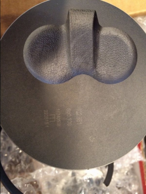

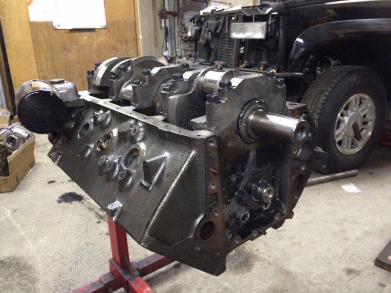

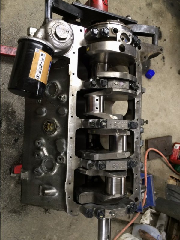

Finally making some progress on the reassembly of the engine. Last night I got the main bearing clearances measured (all good even after having the crank polished again) and the mains torqued. I also got the STOCK cam installed to replace the Delta cam. Then today I had a package from Leroy waiting on the step when I went home for lunch. The new pistons sure are pretty! Between the anodized piston crowns and the .010" shorter compression height, I think my combustion chambers are going to be much happier. Oh and the piston top says "0.100", but I measured and they are just 0.010" shorter. Now that I have all my parts it's time to get this thing back together.

Noticed the K style oil filter adapter. Now is a good time to do yourself a *HUGE* favor by calling Leroy and buying a remote oil filter kit.
Oh I didn't know he had a remote oil filter kit. Hmmmm
