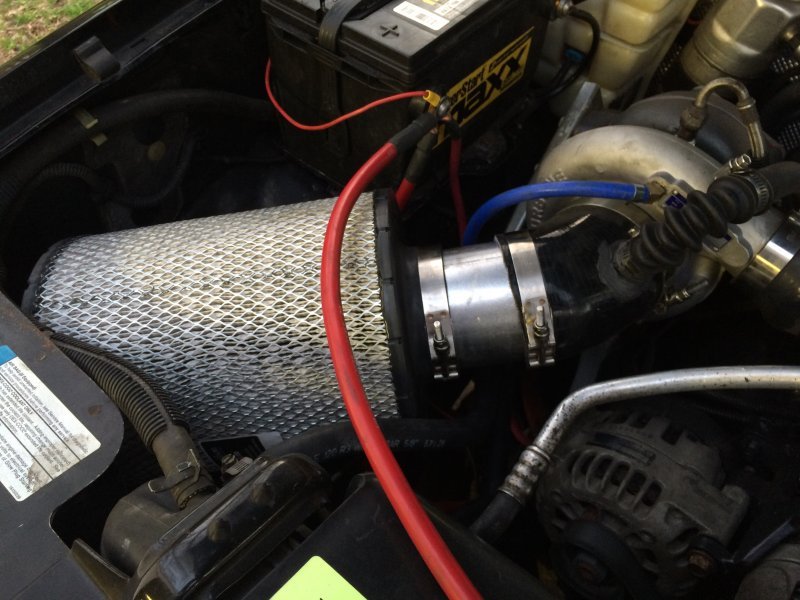

Ok this a real hand on the forehead moment but I'm going to share just so others don't make the same mistake (and also so you don't think I was crazy before....). You know the shake I have been complaining about? Well I finally found a lot of it. Apparently my intake was crammed against the fender and core support so hard and the setup was so robuat that it was transmitting vibrations right to the body!! I don't know exactly why I was getting suspicious, but I decided to try removing it to see what would happen and it is mich better now!! I think I may still have some weak motor mounts that are allowin the engine to shake, plus I may have some inherent shake from my cam/hi pop injector/precup setup, but it feels more comfortable now. I cut 1.5" off the tube and it fits in the hole much better now. You can even see how it started to crush the filter in the pic from the stress that was on it. D'oh!! :facepalm:

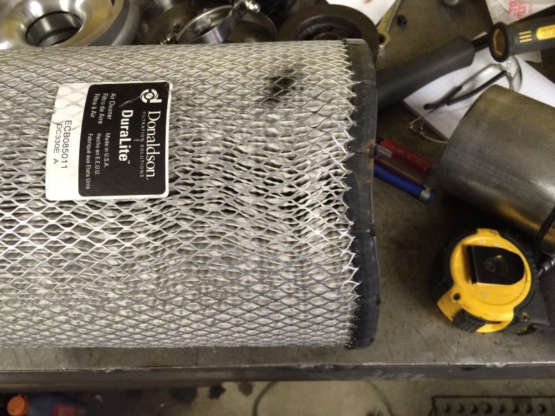

On a related note, I've started to make plans on how to do my airbox. I think I've figured out a way to run the filter 90 degrees to the turbo and that should really help the fabrication of the airbox. I will start a post when I start doing that. image.jpgimage.jpg
On a related note, I've started to make plans on how to do my airbox. I think I've figured out a way to run the filter 90 degrees to the turbo and that should really help the fabrication of the airbox. I will start a post when I start doing that. View attachment 45006View attachment 45007
I never would have even thought that would cause enough vibration to feel having it pinned like that. Good job and finding and fixing that. :smuggrin:

I wouldn't have thought of it right away either! Now maybe if I had tighter mounts it wouldn't have been an issue, but oh well. Someday I'll have this thing all straightened out....
Use a silicone cobrahead 90 deg. for that longer runner when you do it there is actually more flow with it than the full 4" radius every little bit helps.

Oh, I didn't know you could get a silicone cobrahead.....unfortunately I have already ordered all of the parts for the intake. I will keep that in mind though in case I want to change it in the future. BTW, any progress on your 4" downpipe with a cobrahead?
