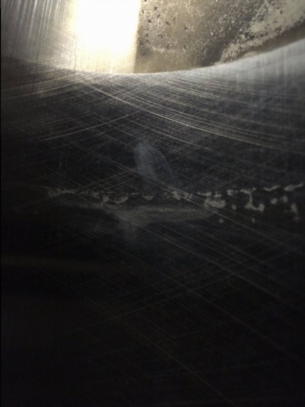

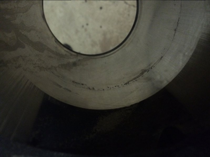

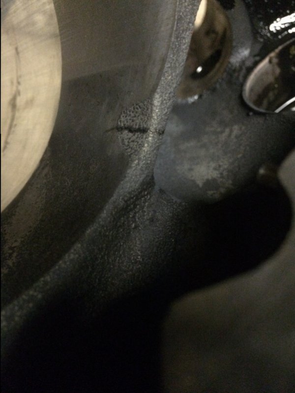

Did you ever figure what broke that lifter guide, or?
Ok thank you. When I mounted the IP to the engine I used the indentations on the old gasket as a guide. I measured the gap on each side of the stud and set it based on that. I should be pretty close but it could certainly be off. I also suspect an injector or lifter but since it changes with the tune I'm leaning more toward injector...which makes me happy since I am not a fan of pulling a valve cover on our diesels.
Nope I haven't really looked into it further to see why it happened. I did look at #8 cylinder closer though and I'm not sure how savable the block is. It has a crack starting at the bottom which could probably be rectified by cutting that section out and then chamfering, but there are also some weird marks on the cylinder horizontally that look suspicious to me. image.jpgimage.jpgimage.jpg
