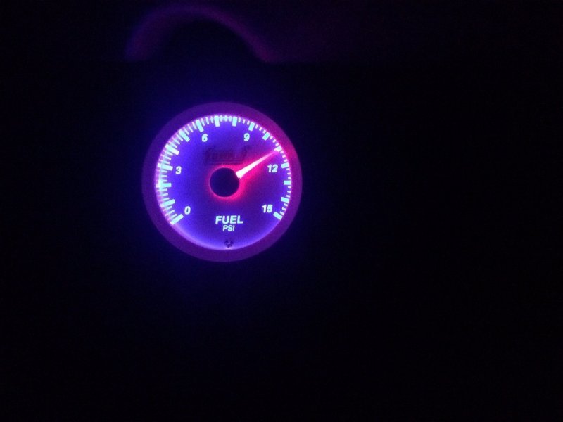

I forgot to mention the new fuel pressure gauge last night. It's just a summit brand gauge but so far I'm happy with it. Based on what I had read other people say seemed to work best for them I set my pressure to 12psi. I may have to bump that up because it drops when accelerating and I'm not even getting in it yet. Here's a quick vid I shot this morning on the way to work. It's a silver gauge like the rest of my gauges but the illumination is sure different from the others....

Sounds great Nate, also love the gauge. I'm sure I read it before but it escapes me, what LP did you end up going with? Really need to do mine. I don't even prime to 9psi where you drop down to. Congratulations on getting it all back together and running.
Thanks SS. It's the Raptor 100 that Leroy sells. I'm very pleased with it so far. Last night to prime the system I opened the water drain and then turned the key off and on a few times but it was taking too long. So I jumped the relay to make it run constantly and that did the trick in no time. It is nice and quiet...I think it's quieter than the stock pump and certainly not louder, so that's nice. Plus it's mounted a bit further back now so the sound shouldn't matter at all.

That pressure is just about right. Couple more #s ^ and you'll have it. Sure is nice to see 9-10 psi under hard accel.

I think I'll leave the pressure as-is for now. Once it gets a few more miles under its belt so I can start dropping the hammer a bit, I'll see what the pressure does at WOT and then figure it out from there.
