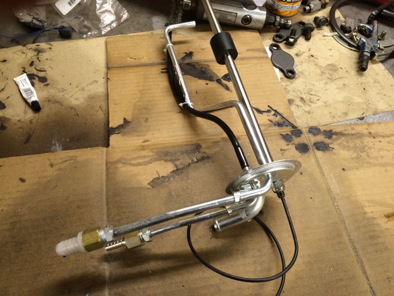

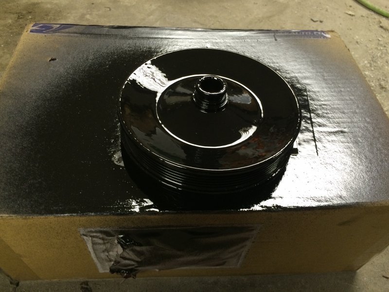

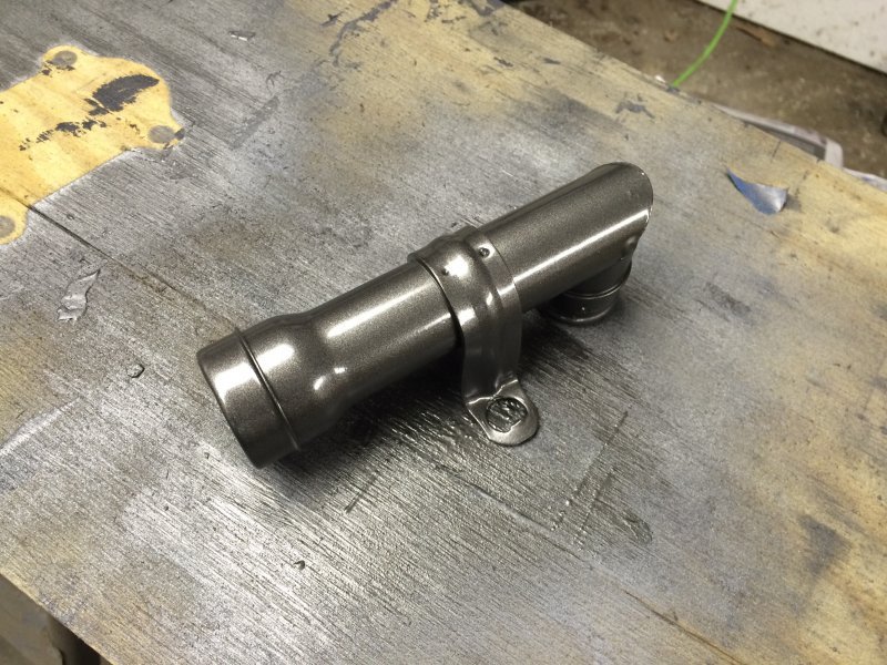

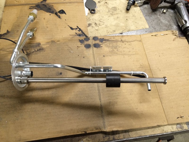

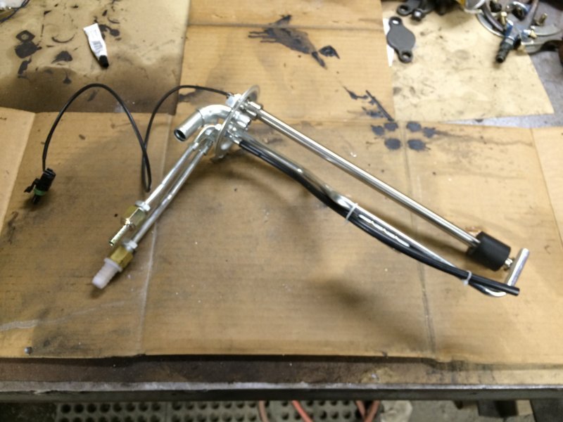

A little progress tonight. I finally found the oil fill tube where it was hiding (which was in a box that I looked in at least THREE times before! :mad:) so I threw a coat of cast iron on it too. I tell you what, the more I see it, the more happy I am with the color! :D I also cleaned up the power steering pump pulley and threw a coat of black on it. Finally I did all my mods to the fuel sending unit. I put Leroy's Metrum Rod on it and installed the barbed fittings for my new fuel hoses. image.jpgimage.jpgimage.jpgimage.jpgimage.jpg
A little progress tonight. I finally found the oil fill tube where it was hiding (which was in a box that I looked in at least THREE times before! :mad:) so I threw a coat of cast iron on it too. I tell you what, the more I see it, the more happy I am with the color! :D I also cleaned up the power steering pump pulley and threw a coat of black on it. Finally I did all my mods to the fuel sending unit. I put Leroy's Metrum Rod on it and installed the barbed fittings for my new fuel hoses. View attachment 44593View attachment 44594View attachment 44595View attachment 44596View attachment 44597

Are going to run a Raptor or ?. I just remembered to ask when I saw the FSU fittings. Have you got the FSU back in the tank?
Yeah, I bought a Raptor from you last fall and it's going to finally get installed this week. I didn't install the FSU yet, I was going to do that part of the install tonight.
Oh and I love that color, Kind of more what I had in mind for mine. I think I might have to go buy a can :)
OK just asking cause in pic the Metrum Rod looks long. Did you test fit it?
As always if you have questions feel free to call me.
Yeah I test-fit it last night and I have about 3/16" of clearance to the bottom of the tank with the o-ring in place. I appreciate your on-call status, thanks Leroy! However, I feel like you may be using that as an excuse as to why it's taking so long to get the P400 done..... ;) Oh and now you're going to repaint parts of it??? Mmmmm hmmmmm.....very fishy.:D

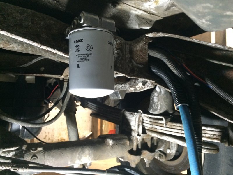

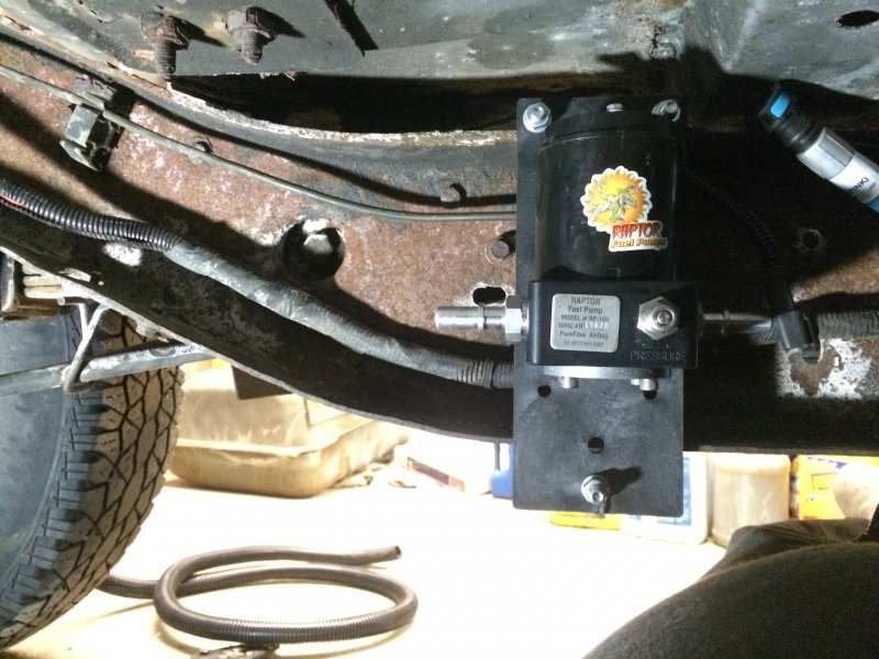

Finally got some fuel supply work done. The tank is in, the remote filter and Raptor are mounted. I just need to get some 1/2 NPT x 1/2 barb futting to finish that part. image.jpgimage.jpg
Nice! How will that pump effect the fuel return flow if at all?
I have no idea, maybe Leroy can speak to that? I bought a roll of Goodyear biofuel rated 5/16" hose so I can run an all new return line in addition to the new 1/2" supply line. The original lines were getting pretty crusty so I wasn't far from a leak.
Thats a sweet looking setup Nate! I'm a bit jealous, but I can't complain, as my OE Delco pump seems to be taking care of business for now. Like the Raptor. :)
Matt
Matt
Thanks Matt. Yeah if I didn't have these parts already I probably would have just put the engine in with the existing fuel system in place since mine was still working ok. These parts certainly would have been on the wish list though, so it's nice that it will be done. Besides the extra fuel flow and pressure, the peace of mind of a new fuel system will be nice as well.
Won't affect the return rate of fuel as long as PSI at IP is set to 9-15 psi (on DS4). Not sure what would happen if you keep bumping it up though.
