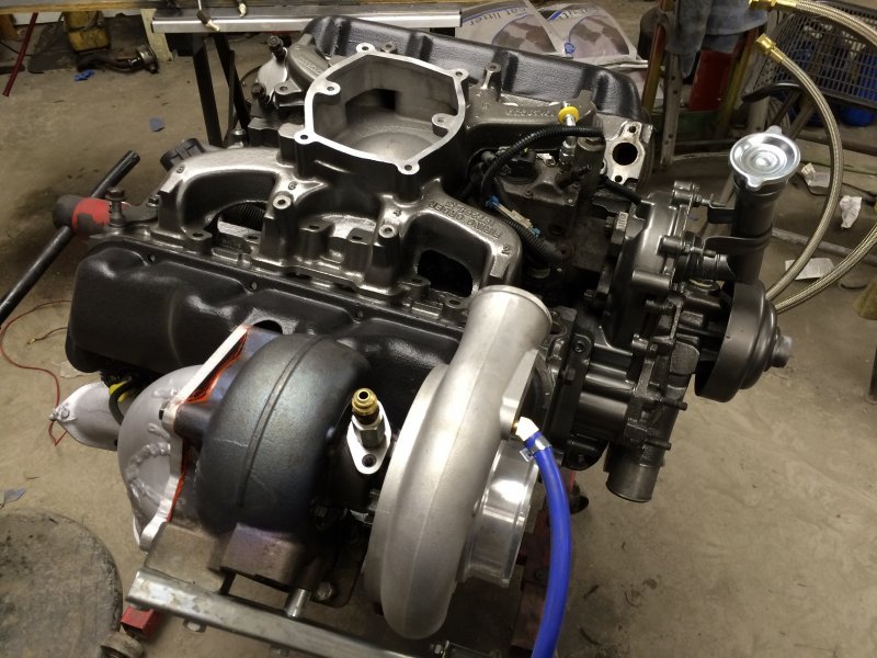

I worked on the new HX40 so it was ready to install later. You can read about it here. http://www.thetruckstop.us/forum/threads/my-hx40-install.43856/page-4

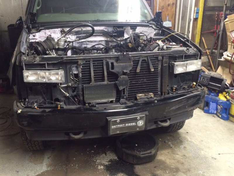

Since we all love pics, here's the only one I have to share at the moment....my faceless Tahoe. Billy Idol anyone??? :smuggrin:faceless.jpg

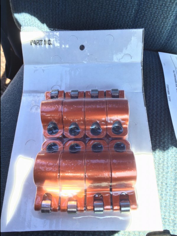

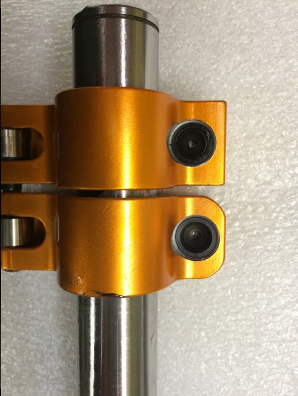

I spoke too soon. Looks like the 8 replacement rockers they sent me are 1.5 ratio where as the old ones are 1.6. Notice the difference when side by side on the shaft. The new rocker is the one with rounded corners and the original is the one with square corners. image.jpg
I spoke too soon. Looks like the 8 replacement rockers they sent me are 1.5 ratio where as the old ones are 1.6. Notice the difference when side by side on the shaft. The new rocker is the one with rounded corners and the original is the one with square corners. View attachment 44697
Man, that really sucks, hope you get it straightened out with them sooner than later. I would be losing my patience with that company about now.
Were the old ones damaged? I thought all that was needed was new spacers.
This is looking to be a bad winter to build an engine.;)
Ha you're not kidding it's a bad winter for that!!

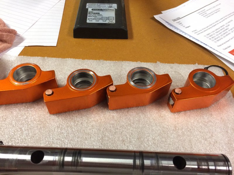

Well it's a little complicated....at first I sent my rockers in to be evaluated because of the galling. HS and I both agree that was due to the coolant in my oil. So I paid $100 for new shafts. After that Leroy and I discovered the spacer issue. Once I knew there was an issue with the middle rockers I looked at them again and the galling was more pronounced on the middle rockers...so Leroy managed to get them to agree to replace my middle rockers. So while the galling happened due to a problem of mine, the spacer problem made it worse for the middle 8 rockers. They said I was OK using the existing ones but I told them that since this truck is my daily driver and our camper hauler I would feel better knowing the worst rockers were out of there. Unfortunately they didn't have any in stock so they had to make 8 new rockers which would take a week. I told them it was worth it to me to wait. So I don't have a really strong case to jump up and down and throw a fit...they could have flat out told me no that they wouldn't replace any rockers just change the spacers but they kept their end of the bargain and made me 8 new rockers. It's just really deflating that they are wrong. I really don't want to wait another week for new rockers again so I hope they have a quicker solution this time. We'll see.
Here's a pic of one of the sets of rockers. You can see more galling on the middle 2 though all of them have it to some extent.

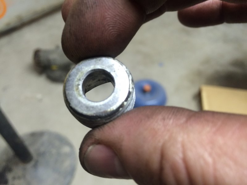

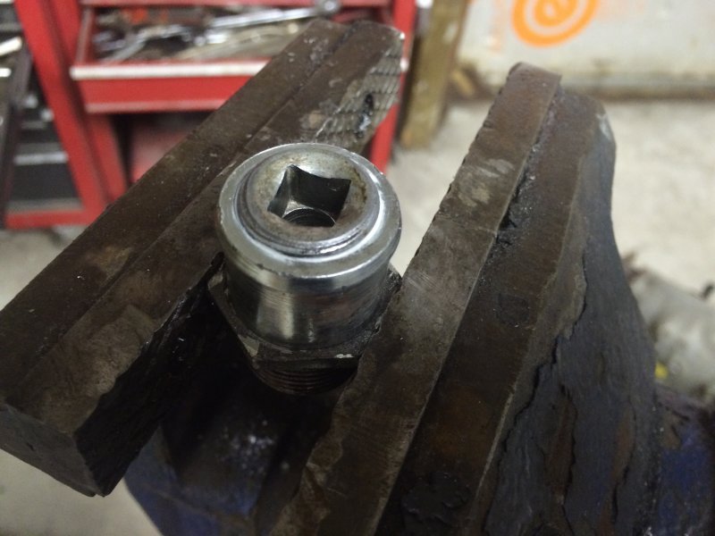

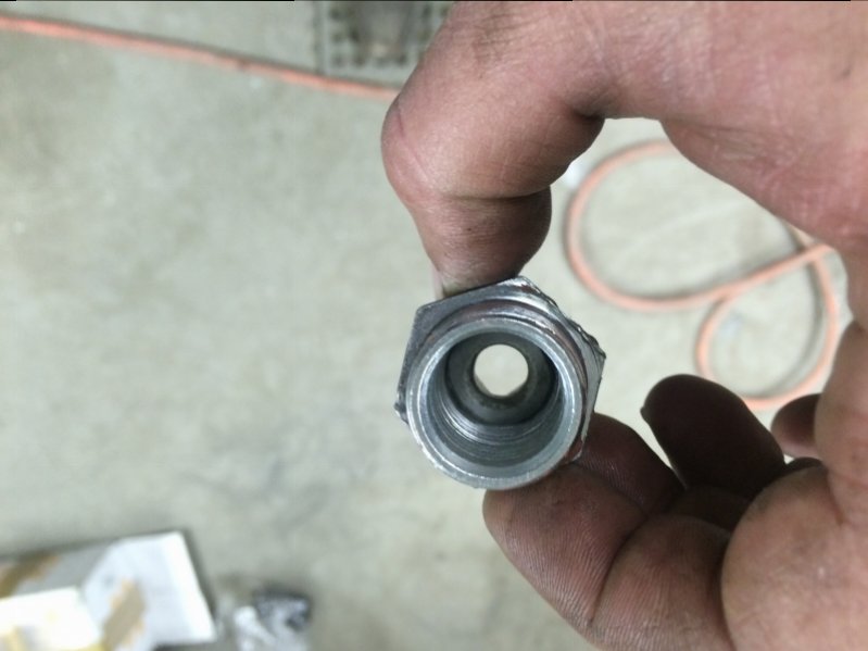

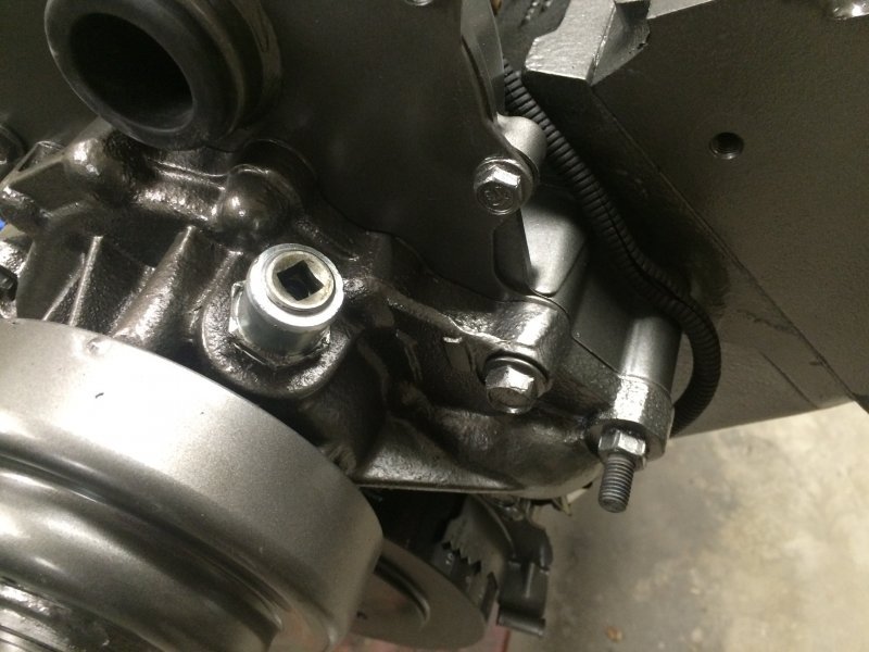

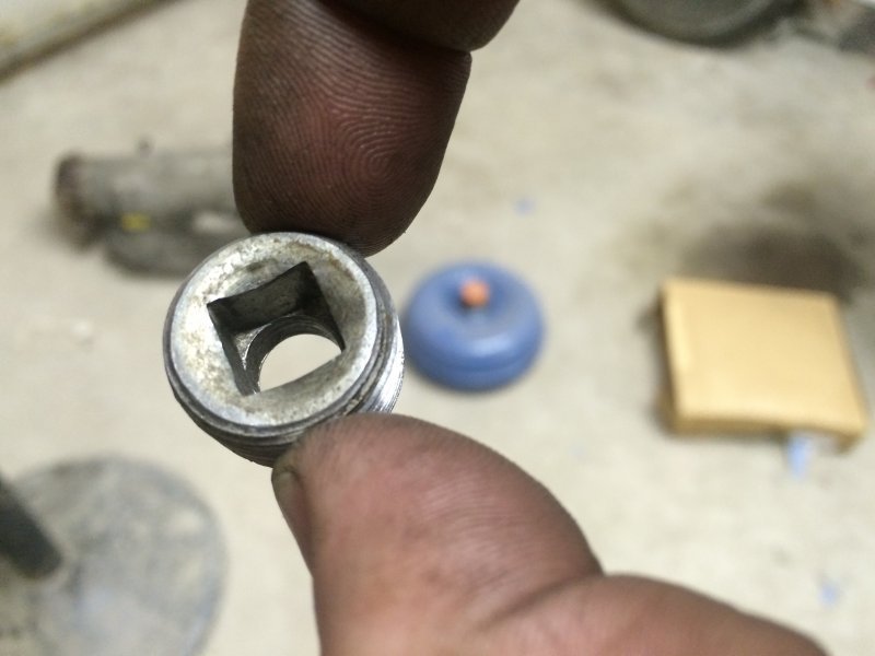

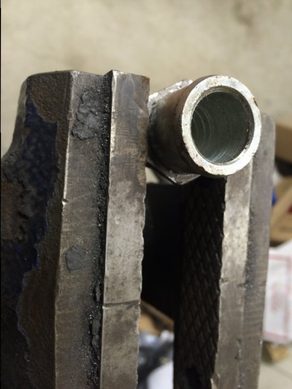

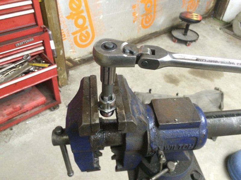

Well I managed to not just throw my hands in there and actually get some stuff done tonight. First I took the opportunity to make the coolant bypass restrictor I hadn't made yet. I tapped the fitting on the water pump with a 1/2" NPT tap. Then drilled a 3/8" hole in a 1/2" pipe plug.

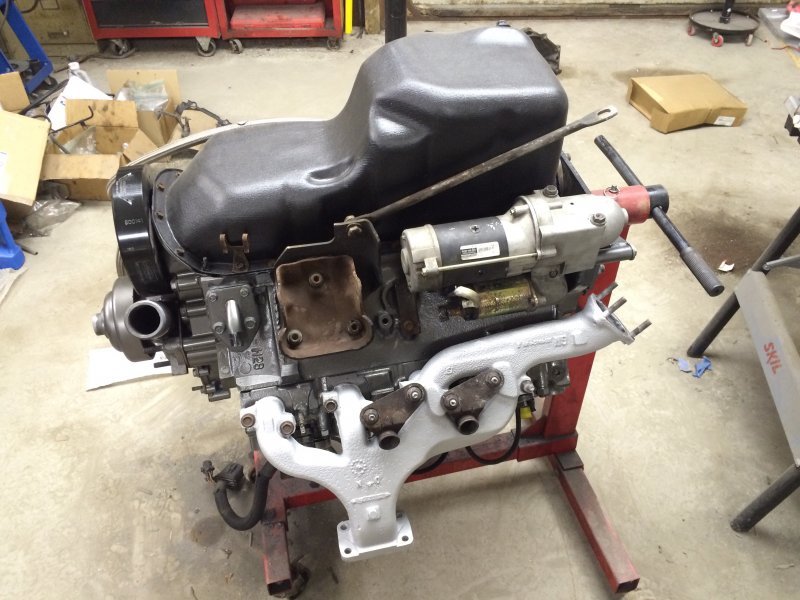

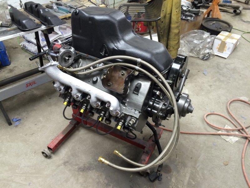

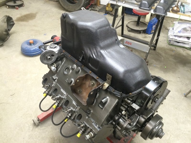

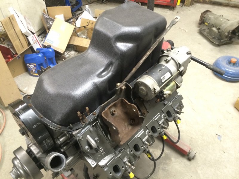

I had planned on not putting any sheet metal on the engine until I had the rockers on but decided I was tired of waiting and might as well spend the time putting the bottom of the engine on. So I put the oil pan, starter and motor mounts on. FYI, the motor mount bolts are SAE on a 97 but Metric on an Optimizer. Luckily the exhaust manifild bolts that came on the Optimizer that I wasn't using were a suitable substitution. I could have put manifolds and oil cooler lines on but ran out of "want to" for tonight.

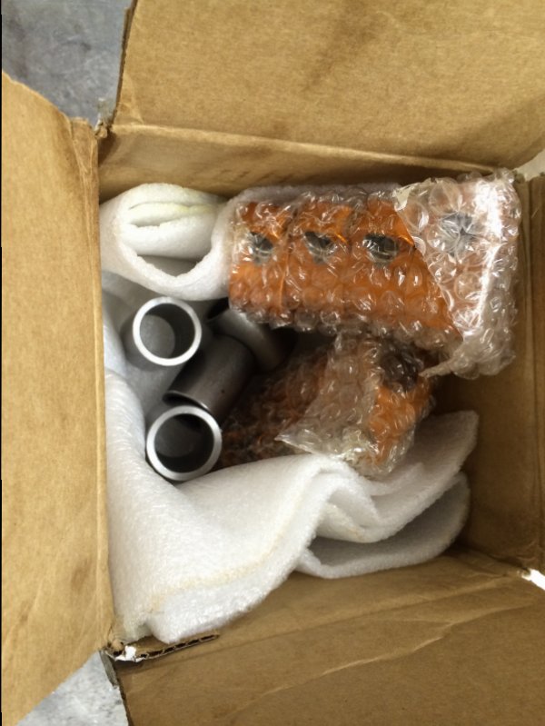

Just got an email from Harland Sharp. They are going to send me the 1.6 rockers today with a return label for the 1.5 rockers. If it all goes to plan I should be ready to rock again tomorrow night (pun not intended).

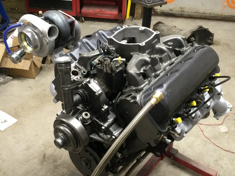

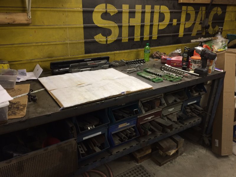

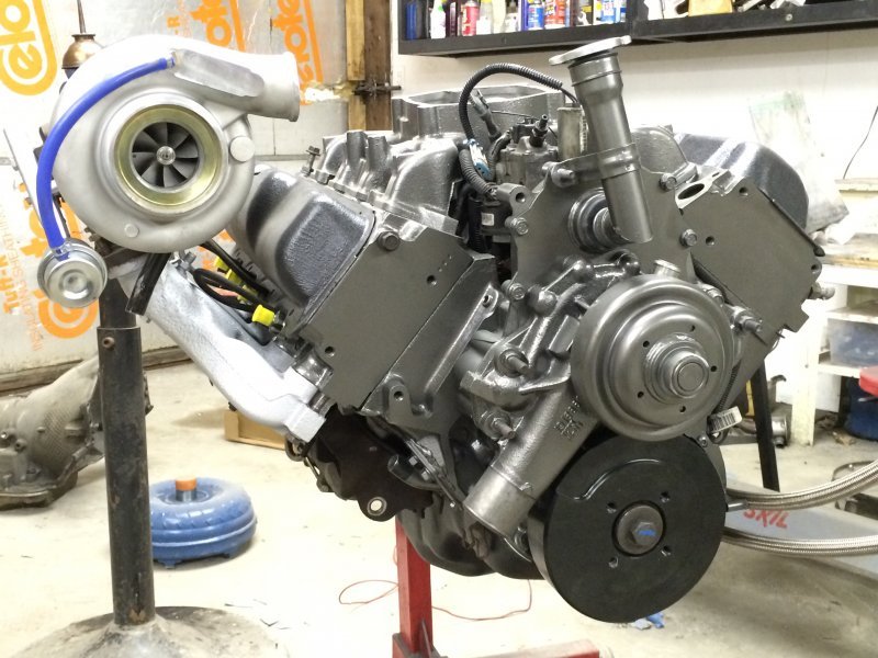

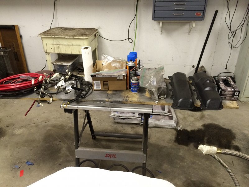

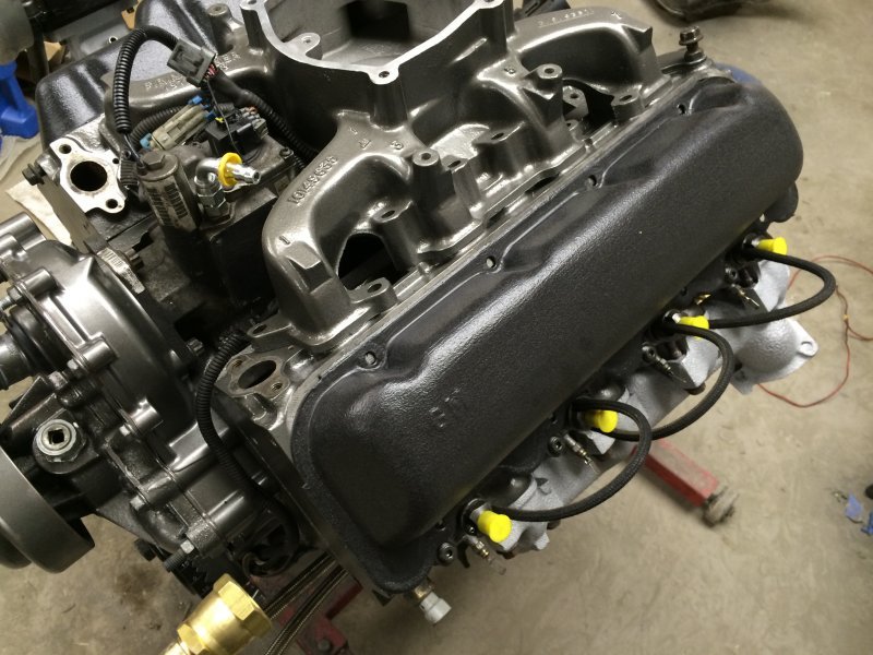

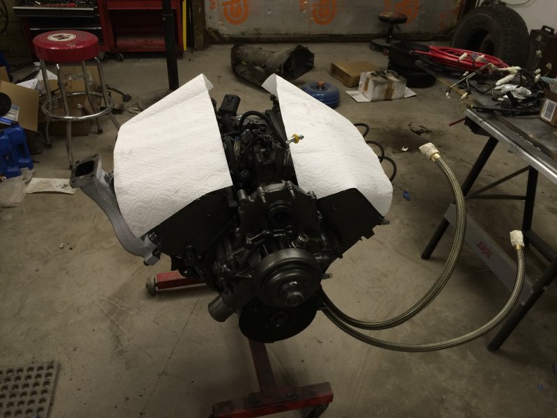

Ok I'm all prepped for the arrival of the arms tomorrow. I put the oil cooler hoses and exhaust manifolds on. I have the workspace cleaned up and tools & supplies all laid out. Tomorrow after work my brother and some pizza are coming over and we're going to finish buttoning it up then lay it in the framerails. I could drop it in by myself but it will be nice having an extra set of hands to guide it in so the new paint doesn't get all scratched. I'm still hopeful I'll get it fired Sunday but I won't rush it. I still have to figure out where I'm going to remote mount the FFM and then make the bracket to do so. I want to hang it off the AC bracket but we'll see how things look once everything else is in place.
Oh yeah I almost forgot I couldn't resist setting a few pieces on the engine to see how it's going to look he he. Tomorrow should be a good day, fingers crossed!!
image.jpg image.jpg image.jpg image.jpg image.jpg image.jpg image.jpg image.jpg image.jpg
Looks real nice, I love the color, it will be interesting to see if that noise reduction paint on the valve covers, and oil pan works or not.
