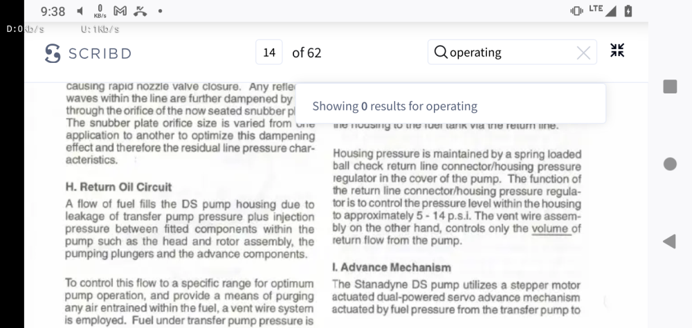

The last training books I saw (afaik others here too) that were the Stanadyne training literature said 8-14 psi is proper range for ds4.
I asked before and will again:
The different spec you mentioned: please post pics of the specs and the manual they are in Including the identifier for that literature because there are misprints.
I sell no parts. I sell no services. I get no pay from any vendors (infact they get paid by me- haha). I have busted parts sells guys on multiple sites for misrepresentations. The link posted earlier in this thread for the lift pump-
I HIGHLY QUESTION IT being the best choice. Can’t say it is horrible- but there are cheaper options and there are other options that cost more on day one but have better return on investment imo.
I do have a habit of investing too much in some situations but like my Hummer with db2- it was more economical to just keep replacing the EP 158 by AC Delco, which while toted as the best factory style lift pump- is too low output for the ds4 unless you get one that an individual store will do lifetime warranty because it barely meets bottom spec when new and within a year or so falls below.
So, from a fairly obvious air intrusion problem to maybe fso, to in dash electrical short, firing the parts cannon continues with a pmd & resistor before installing the already purchased fso and still not doing what both Stanadyne say is task #1 of installing clear line in place of the ip return line to examine for air intrusion (bubbles) or other contamination then reading pressure/flow at ip inlet… Am I up to speed?
Again- please show the specifications you mentioned at the beginning of this thread as they are completely incorrect at too low and too high. I stopped by the local Standyne authorized shop to check on his supply of injector shims and had him pull up the numbers- he verified what has been in my book from the 1990s:
8-14psi
8-14psi
Ah yes I am familiar with the Stanadyne shop pitch. The shop is not allowed to give information which does not match the GM spec, for example the EP158 PUMP spec is 9.5 to 14 so that is what you tell the customer.

I am perplexed why you are stuck on the 8-14 psi operating range spec to insist anything else is wrong.
You say some engineer told you that. That without proof, is called "hearsay"
But then other authority sources and fact contradict you. For one the DS4 test spec is 5 psi + or - 1%, REGULATED so that contradicts your 8 psi claim
Second the stanadyne-ds4-service-bulletin-sb-500r2-pdf (500r2) at Section Three speaks to a test on the test stand for fuel delivery is to raise the inlet pressure to a "minimum" of 16 psi and check again.
I remember that the DS4 service manual specified the operating range was 5 to 18 psi.
I could have recalled wrong but it could only then be 5 to 16.
But I am fairly sure it was 5 to 18. It really is not important to keep on about it.
This is a revision of the service manual that speaks to the purpose of the return valve is to keep housing pressure between 5 and 14 psi. Other service bulletin speak to how the return valve should be able to waste up to 3 psi and be in spec.
Other diesel 6.5 sites speak to guys getting Hp4601 pumps to run at 18 psi the early ones., now they claim 16 psi max.
Just because you say some engineer told you something does mean he is right or if he knows if he is right of wrong, especially when there is no proof in writing.
Anyone can go download the manual, which is the rebuild procedure.. It is a newer revision, that is missing the "operating range" inlet pressure statement which was on the page with the black and white pictorial of the pump. https://www.scribd.com/document/334125089/Stanadyne-Ds-Pump
The 500r2 service bulletin would not speak to raising the pressure to a MINIMUM of 16 psi if the upper limit might not be 18.
I would not tell someone they are "wrong" without written proof, and not just "hearsay" as proof.
I am not going to pay $150 for an EP158 that won't perform well out of the box even new. I am going to use a true positive displacement pump that can keep 15 psi at idle or wot. There is no problem with aeration in the IP and you can not make a diagnosis there is or was. The DS4 is a self bleeding system with adequate line pressure.
This thread is about why it might be suddenly hard to start, which is now will not start without fluid. I am waiting for a new PMD, which seems to have sent by Amazon as a USPS shipping partner 50 miles in the opposite direction first, and has it appears turned it around. Yet except for the start issue it runs perfect. Otherwise it is likely the Fuel Shutoff Solenoid which is hard to get to on a Van.
As to the rest of your post I have little of any idea what you are talking about. The flippant example about low oil makes no relative sense.
