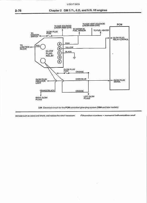

That makes sense. The connector on my glowplug relay only as 3 prongs as well as the relay. My 95 has 4 prongs and my friends 93 has 4. The connector on mine seems a little bit loose too. One of the fusible links coming out of it has wire showing right before the fuse part. No telling how old it is or anything. Just thought it maybe had the wrong relay or something on it. The GP light usually comes on for 8 seconds or so then goes off. Will thanks for the info! I was gonna go with the Bosch plugs but I'm probably gonna go with the ACDelco now. Thanks for the info! I will try and look at the wiring going to the glowplug relay and see if I can figure out what's going on and fix it.

Well, how many prongs is a 93 supposed to have? And what exactly do you mean by a dumb relay?
Iirc the 93 should have 4 pins.
Dumb means not as much input control like on newer ones that use the ecm also to control.
Imo the older simple systems are far better. If it isn’t getting signal to turn on and it should because it’s cold outside and engine is cold - either bad connection or the 2 wire sensor is bad. Nothing else.

Count the wires in the harness going to it.
Oh okay that makes sense. So not trying to sound dumb here but where is the two wire sensor that may not be bad?

Again but no so relevant to the problem: the connector is different on 1994+. As you appear to own several years it's important to understand they are different. 1993 is 4 pins per the one I am looking at off my 1993.
Does your GP relay have 3 pins? How is the GP lamp acting? You are doing the work so I can only guess at how you decided the GP relay is bad. Keep that in mind with the following suggestion.

Thanks for the info! My GP relay has 3 pins and the light only comes on for a out 6 seconds and sometimes 8. But it only comes on once. I'm ordering a spare pmd on payday (Friday). I have been looking at getting a scan tool and adapter thatd be able to read ECM data for this truck and for my 95 6.5. I apologize for not being super knowledgable on diesel stuff. I know way more about gas engines.

So when I put a test light on the glowplug controller, there is power to the positive side but none to the ground. No power to the fusible links either. Is that something within the fusible links or something within the glowplug controller itself that is bad? Not getting power to glowplugs either. Is it possible that my controller just isnt grounded properly? Is it supposed to be grounded? I have two fusible links on the ground part of it.
One is ground, one positive, and ECM ground to "turn on".
