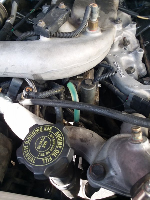

The line you are replacing with clear is out top front of ip next to the fuel shut off solenoid. Factory piece is about 4” to 5” in an upside down ‘U’ shape.

I put on the clear piece of tubing. No bubbles. Noticed my glowplug relay connector was loose so I plugged it back in. Still getting intermittent code 36 and 29 is back. Still getting white smoke on startup but it's not constant white smoke all the time. Only for a few seconds or if I rev it a few times then it turns black.
