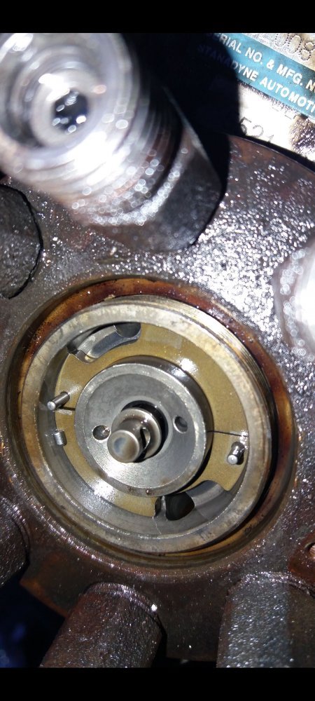

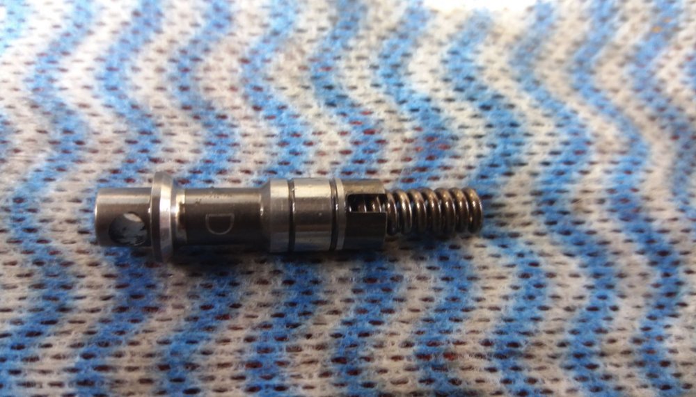

Heard thank you guys again you’ve been a huge help so farThere is a very small gap in the optical sensor, in thin layers any fuel is optically transpare

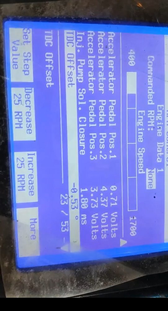

And the higher the RPM, the less fluctuation? Is it stable at 1300 rpm? Tech2 can set the desired speed.
yes it’s smooth and holds firm once I give it throttle up until about 1900 wheee I can hold it for a second then wants to take offAnd the higher the RPM, the less fluctuation? Is it stable at 1300 rpm? Tech2 can set the desired speed.
I think I found the leak it stems from the fuel filter housing at the rear just a steady leak of fuel about a drop every other second so I think that ring seal is one of my issues along with maybe the fuel shutoff o ringDid You remive the intake manifold and run the engine to find those fuel leaks thats under the intake manifold ?
Or better yet, go to the parts store and get about four foot of fuel hose, 30R9 rated for diesel fuel. Just replace the hoses thats under the intake manifold, then start the engine and look for leaks.
Report back Your findings.
