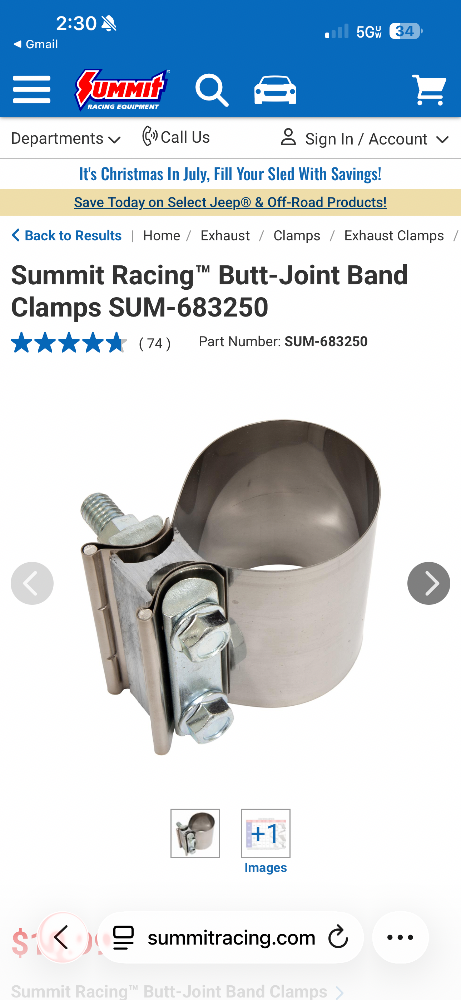

Here’s a couple pictures showing the flex pipe and stainless elbow but I’m going to use band clamps when they arrive from Amazon and it’ll look better also.The outside muffler clamp will be taken off.I also have some thermal heat sleeve coming from amazon also to wrap the flexpipe.
Here is the types of clamps I like to use on such as that.
Thanks Marty for posting that.I used the same band clamps to attach the exhaust tip and elbow upon each muffler and it’s definitely a clean look overall.
