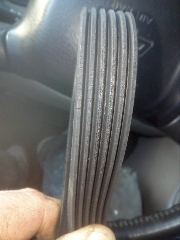

OK guys looking for some suggestions. I've developed a pretty good belt squeal/squeak. Thought it was the alternator because it was seized up slightly when I pulled the engine. It freed up and rolled OK. So when I developed the squeal I first changed the alternator no joy. Then the idler pulley nada. Lubed the bearing on the tensioner still no joy. Put some belt dressing on and it quiets up for a couple of seconds and comes back. Water pump and power steering pump are all that's left and they feel fine. Thoughts?
Check belt alignment 1st. Is it a new belt or old one? I know I had problems on mine, and it ended up being the power steering pulley was an 1/8 inch shy of being flush with the shaft. Pressed it on the rest of the way and no more chirp.
I don't blame the belt. I saw how cold it is there right now. Stick me outside in that crap and make me work- I will be squealing too!
Glad you're u got it and it was a cheap fix. I would be tempted to soak that belt in some oil for a month in the corner of the shop, then try it again. But sometimes I can be chea... frugal yeah, frugal.

I honestly not had good luck with belt dressings. Used them before to quiet squeals just to come back. I've also ran into issues with the use of cheap belts.
