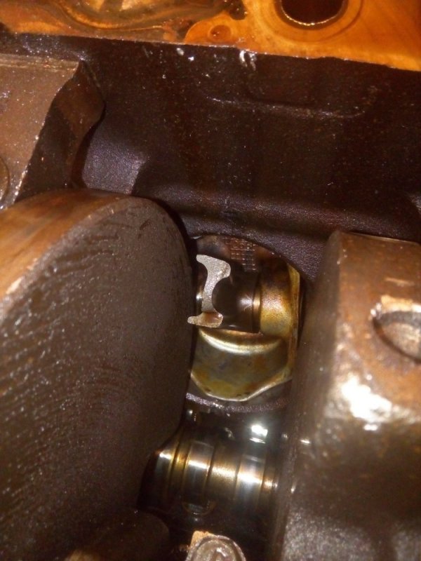

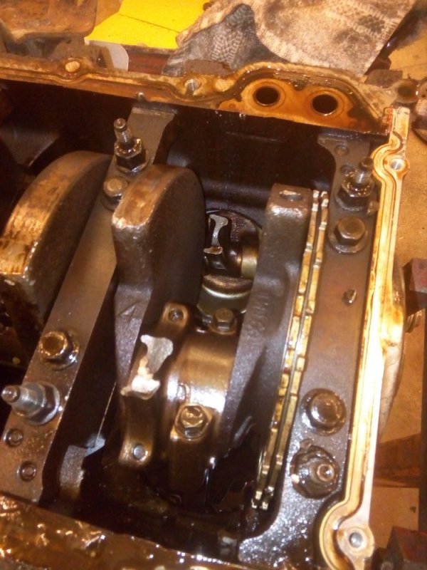

Check out the one next to it.. Rod cap blow off?
Powdered metal rods caps with fracture style parting surfaces. Fractured.

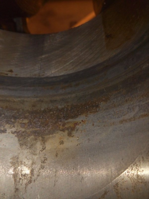

Rod cap was fine. I'm wondering if it hydrolocked. Pretty weird cylinder rust. Feels like abraded metal where I took the picture. Wondering if the cylinder wall cracked.IMG_20170118_110125.jpg
Good possibility. Freeze up, head gasket leak? Or electrolysis but usually that's a problem with wet sleeve engines..

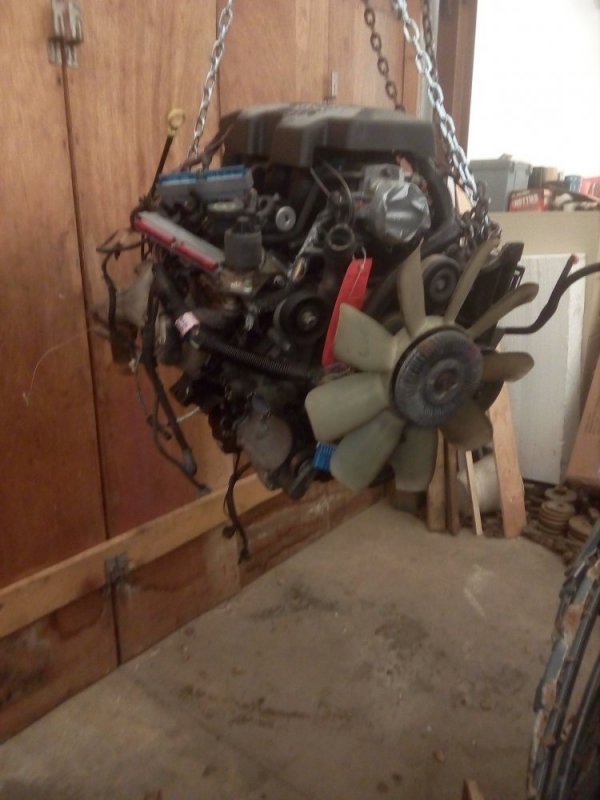

Yeah you better round up a gently used 5.3
In that one pic it looks like the bare crank journal with only two bolts left.o_O
