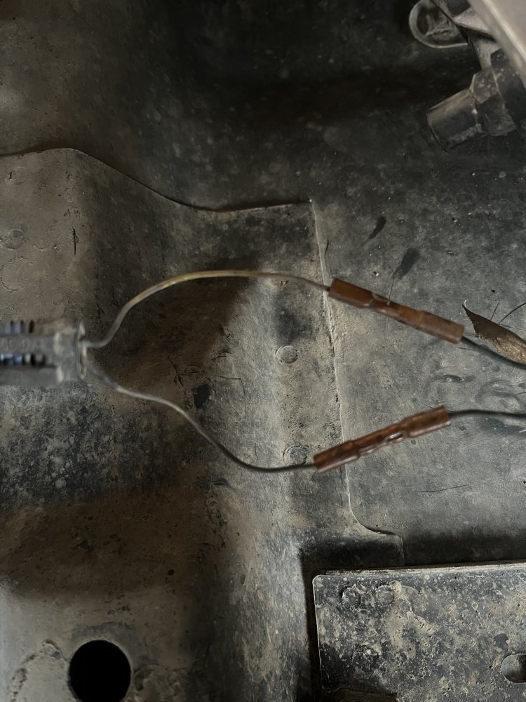

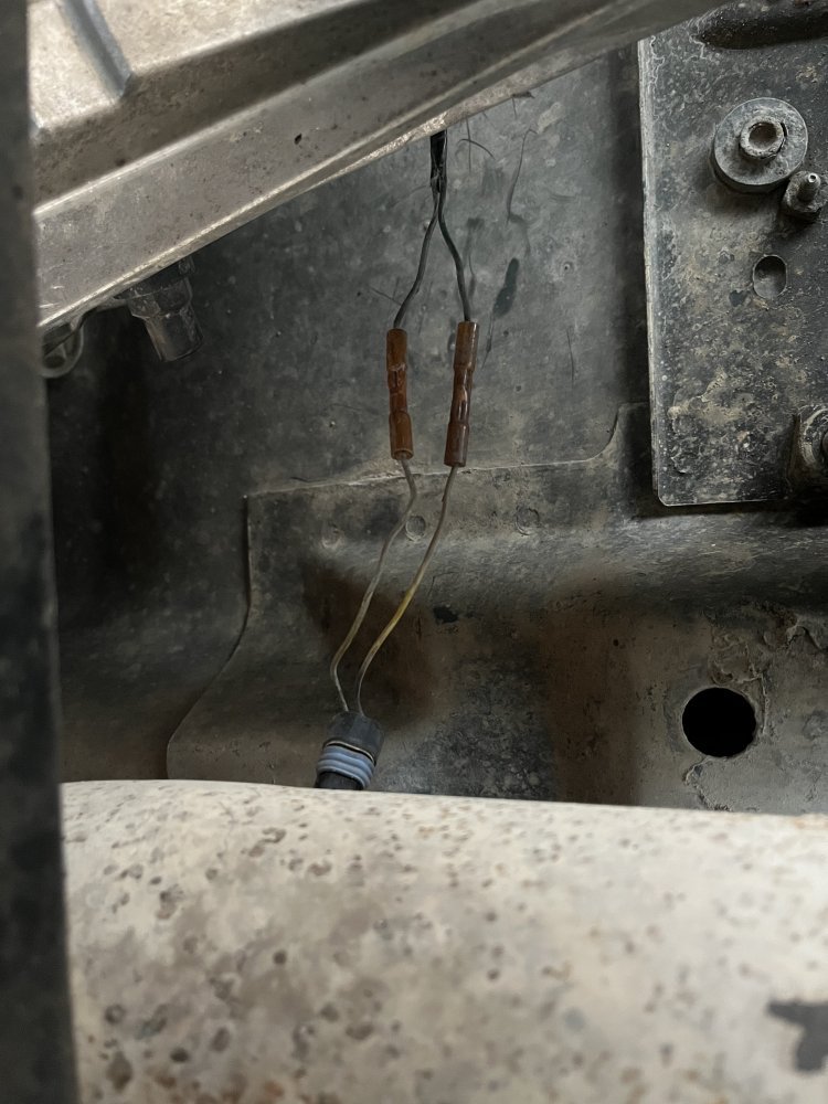

I did inspect the wiring today. It would be impossible to incorrectly install the plugs due to the lengths of the leads. It was apparent that there was a prior repair as there were crimps in place:
They were shrink fit crimps which had not been shrunk. I cut them out and installed new ones, but no difference.

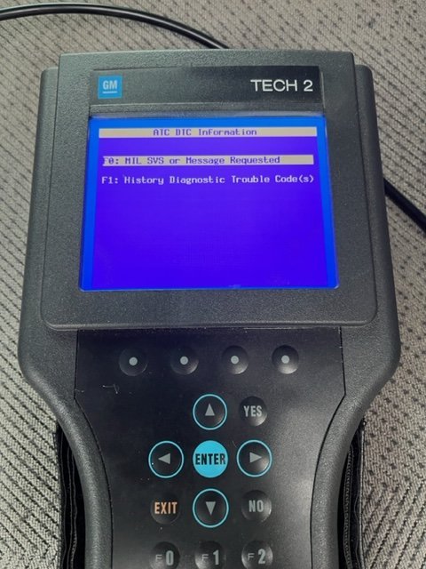

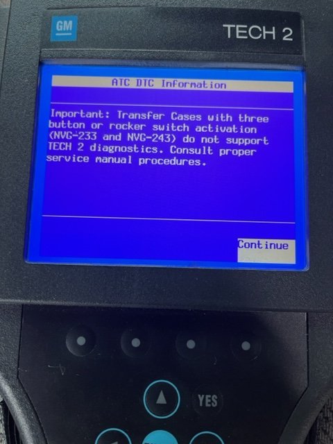

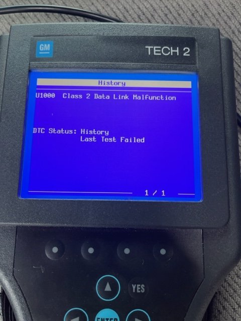

Data Link Malfunction would tend to point to a wiring/TCM issue, one would think. I wonder if @THEFERMANATOR or @Rockabillyrat have any words of wisdom on the subject?

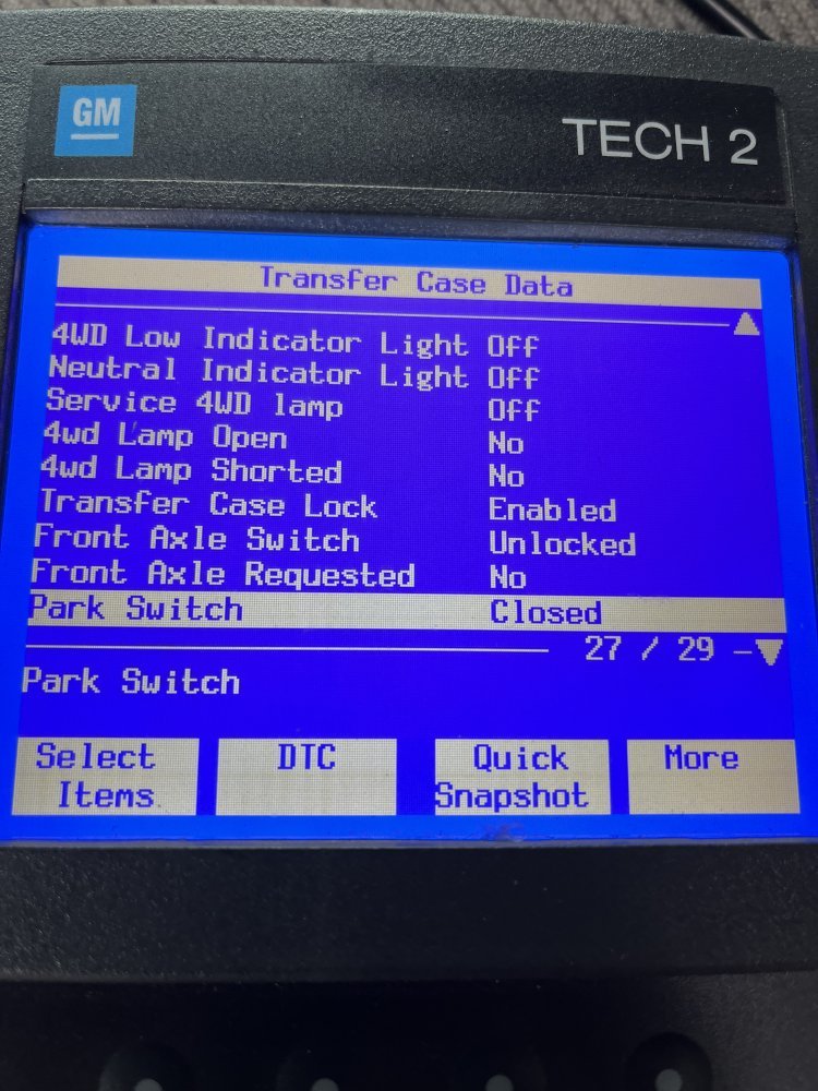

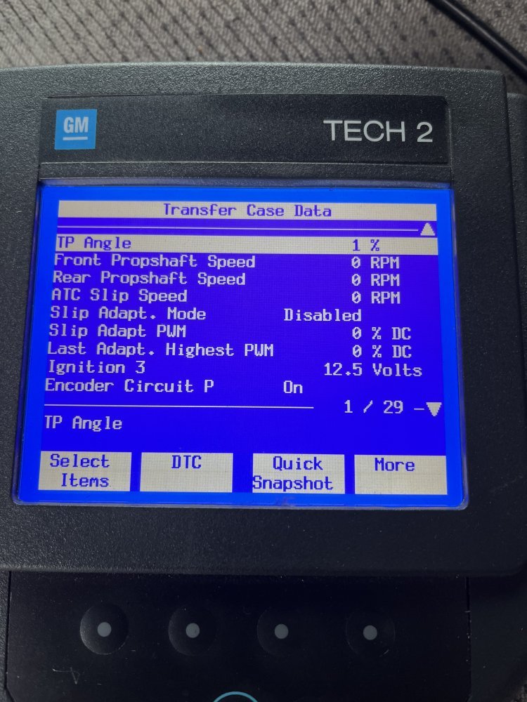

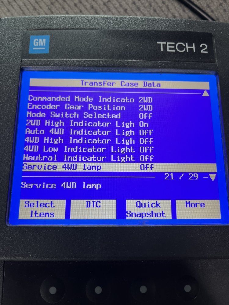

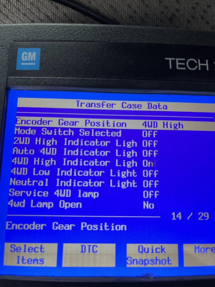

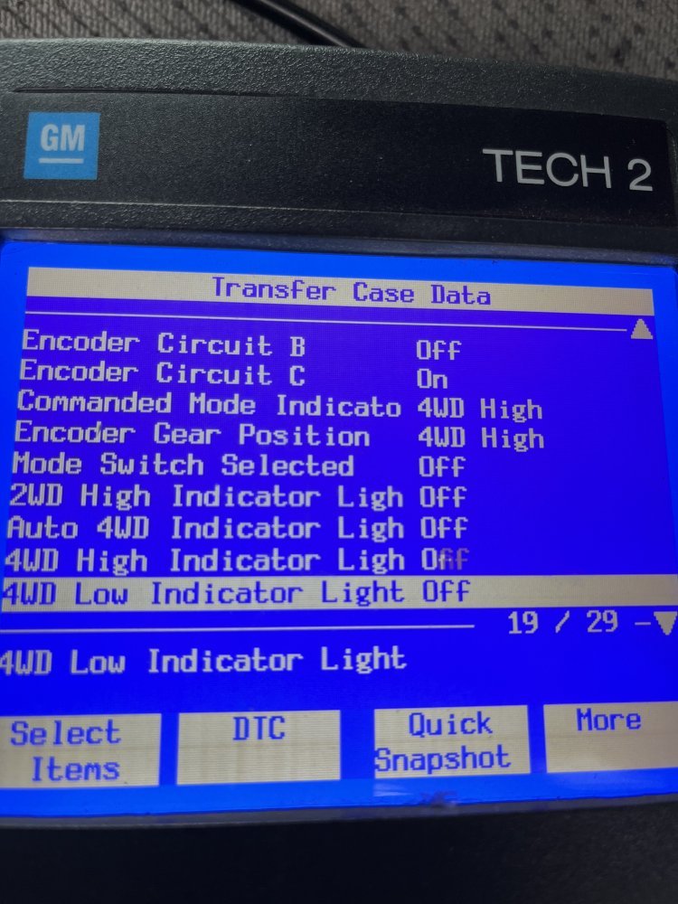

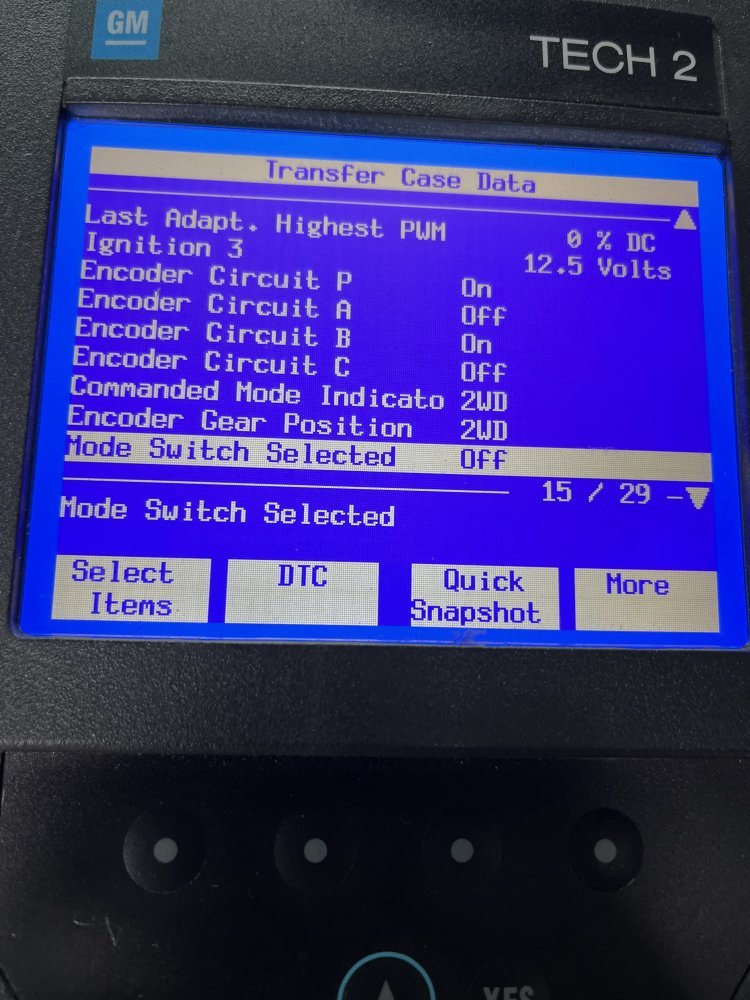

While I have that data link malfunction, I do get data on command positions.
In this pic I commanded 4Hi and it shows encoder position of 4Hi, but notice the 4Hi indicator light is flickering just as it does on the button in the cab.
1CC3FC51-6908-40D3-8B42-49BF50358A16.jpegA35FAAFC-B9C4-4CB5-B463-DCABFD571D16.jpeg356EA3F8-426F-4E19-B2B7-20EE57AC75E0.jpegC134ED27-88B9-4F46-B3CB-716A213121C8.jpeg7B290064-83C0-403F-B207-22BD358C6E81.jpeg8607CC6E-5CA5-4564-9A30-8CB49D0EE859.jpeg
But were you getting data on the transfer case, not just the switches? It looks like all data on those screens pertained to the switch positions.
