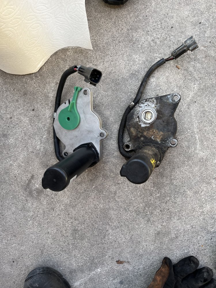

Interestingly enough, the ground was the first thing I checked years back. I ran a solid copper jumper from battery to undercab location. Stripped all the wires and reattached. I thought I had that issue fixed. But I might not have. I couldn't find a good video showing how to test with a meter. Until now.
I didn't test with any meter or anything. Just went right to the source. Just fixed my 4wd. It was the ground. I followed one of the vids above. Pulled off fender liner on drivers side snd tapped into black wire. Stripped the sheathing and wrapped a new stripped wire around it. Then taped it good. Ran a new wire to firewall ground. Started truck and it worked. I am shocked because years back that was the first thing I fixed. I thought I fixed I guess.
But I'm glad. Have not test driven it yet, but it shifts into 4wd and back into 2wd while idling in driveway. It has to work. Everything that is replaceable is new. Except for tcase control module.

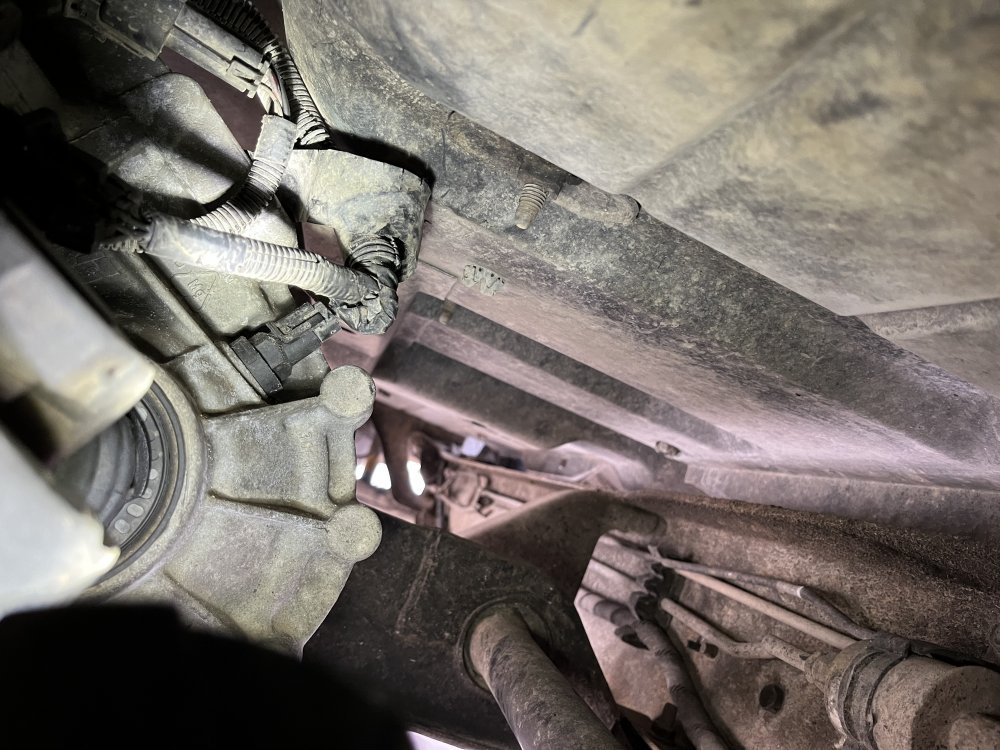

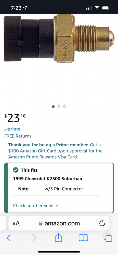

Bit cold this am, but got underneath to check for the above shown switch on the transfer case. Based on the roller ball design, I would expect it to follow the indents on the shifter in the transfer case. Could not find anything in that area. What I did find was a switch or sender on the output shaft of the transfer case to the front differential. Not sure if this has anything to do with shifting:
