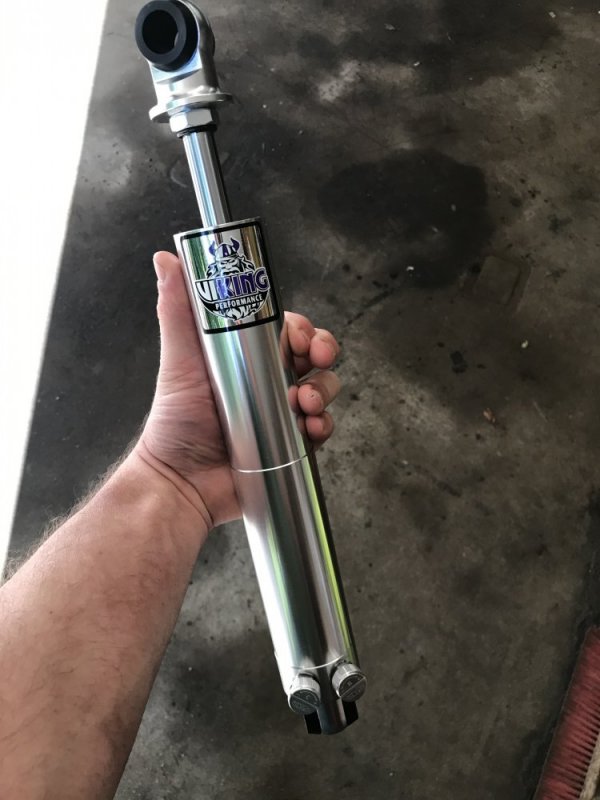

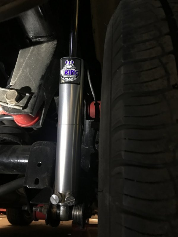

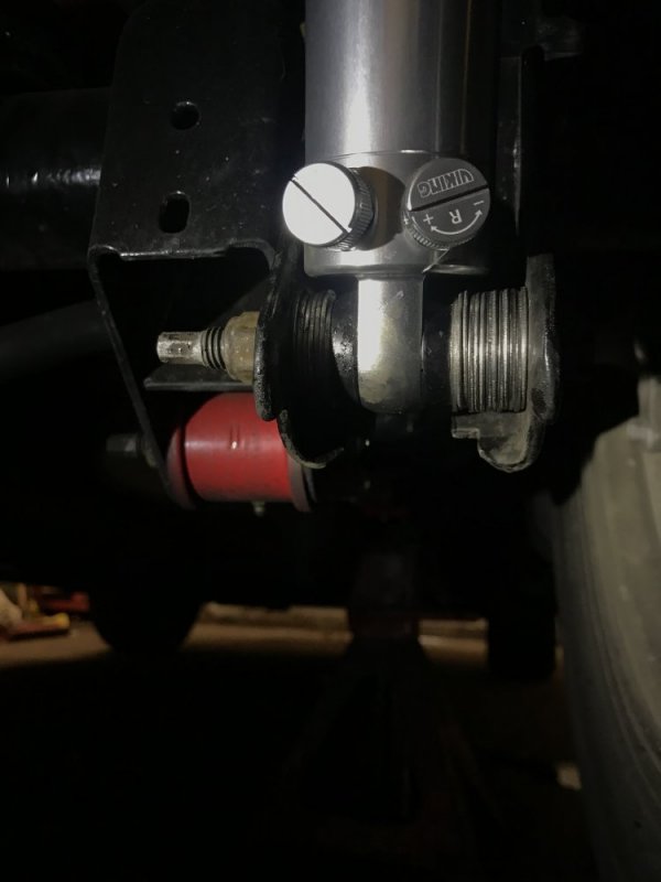

I have been really hating the ride quality of the Envoy since lowering it and installing the Belltech rear shocks. You can buy Belltech/KW adjustable shocks for Trailblazer SSs, but they’re $700, and that seems ridiculous to me. While researching shock options for better ride quality I stumbled on a TBSS owner talking about using Viking double adjustable shocks. More research showed that they were started by some ex-QA1 people that wanted to focus exclusively on double adjustable shocks. By making just those, they would have fewer variations and be able to charge less for them while still maintaining high quality - sounded good to me. They didn’t have an application for a TBSS or Envoy listed in their catalog so I called them with my specifications. They wanted to know length of the shock at ride height, bolt shank diameter and length of the sleeves in the ends of the shock. With that info they said I wanted their D220 Warrior shocks. They were $380 a set. Still not cheap, but at this point I was ready to pay that to get something I could tune to improve the ride. Today I installed them. They’re REALLY nice looking pieces.

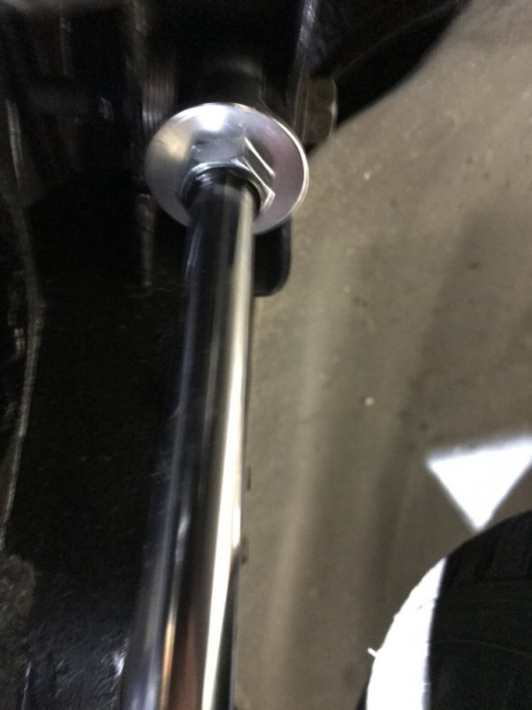

I bought a bunch of stainless steel 1/2” washers to use as spacers for now - I’ll get some stainless steel tube to make spacers later.
The instructions come with recommended settings based on how you’re using the shocks.
291C7E86-6BB8-4D92-B204-65F19FC4EE14.jpeg2A80B814-7FBE-46F9-B8B1-1EB9C8DDF539.jpeg8D3D7EED-80CA-4403-98E2-E83A07ABE594.jpegA55AA460-2D33-4CCD-A2EE-2A0ED18E4EF9.jpeg
Since I’m going for more ride quality I chose 1 click for compression and 3 clicks for rebound. So far I’ve only driven it a couple miles around the block, but it’s already riding significantly better. That makes me so happy! It sucks sinking a bumch of time and money into a vehicle and not being happy with the result.....every time I was bouncing over a bump it ticked me off, now I should be much happier during drives. These will be much appreciated on our upcoming road trip this coming week. As I use them more I may start playing with settings even more. I also want to call them and ask them their thoughts on shock boots since I daily drive mine on our winter roads. They’re based in Minnesota so they should be familiar with that.
