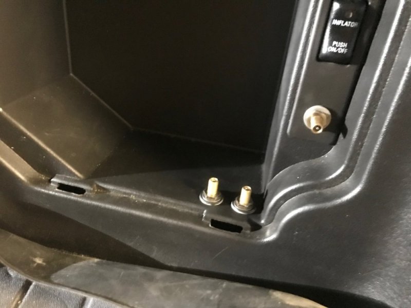

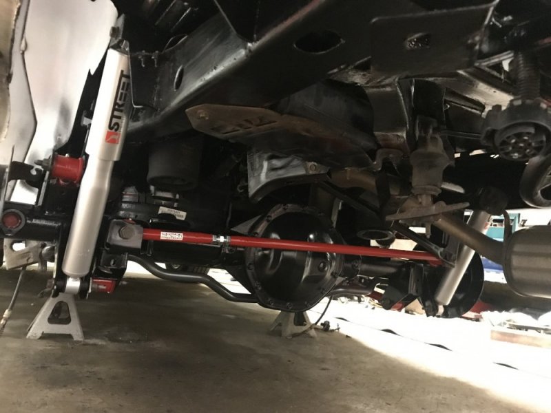

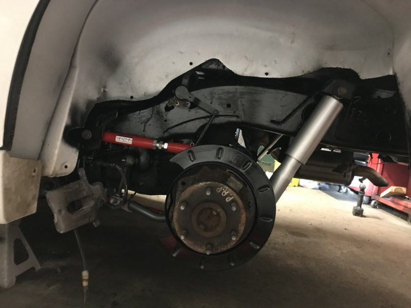

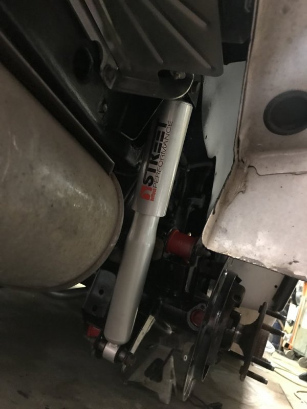

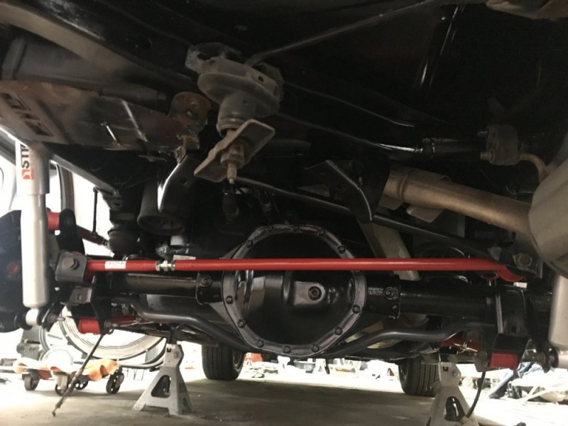

To finish off the rear I made some more changes. A while back the factory compressor crapped out. It would still run, but the solenoids wouldn't open to allow air into the bags. At that point I still wanted to keep the air ride suspension for a couple reasons: 1. I had already invested in new air bags. 2. I liked the idea of having the rear ride height adjust automatically (especially since I am planning on towing our trailer with it). 3. I just like things to be the way they are intended to be. So I did some research and it looked like a lot of peoples' problems stem from buying reman'd compressors - the thing that went wrong originally with the compressor is fixed, but then the next thing goes wrong. A new GM compressor was stupid expensive, but there was a place in Germany selling brand new compressors on eBay....and since the original compressor was made in Germany, this seemed like a good option. If the original lasted 11 years, I was happy with the idea of another 11 years. So I bought that. And it worked great.
Fast forward to the rear suspension rehab and when I plugged the compressor back in, it wouldn't turn on. So to get it back on the road I rigged up the air fill that I had previously rigged the first time the compressor failed. A couple days later I tried plugging the original compressor in and it turned on....ok, so the new compressor failed. I plugged the new one in and it turned on too! Weird. Ok. So I start hooking it up.....and it stopped working again, plus the fittings were stripping out. Ok, I'm done with the air suspension. I should have just done what everyone else does and put springs in it. I guess that's why everyone else does it. So I got the Bell Tech lowering springs and a pair of Air Lift bags so I can add some extra load carrying capacity to the rear as necessary. I put the fill valves in the cubby for the air system so they would be out of the way but readily accessible. I want to rig up a working compressor so I have on-board air to fill the bags, but for now I'll just use outside air.

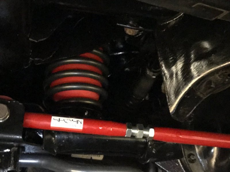

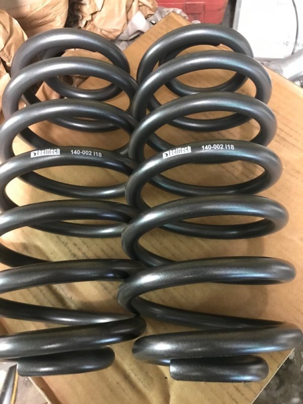

When I originally installed the springs it sat about an inch lower than it should have for some reason. It was also lower than I wanted it. So I bought some 1" spacers also from Bell Tech and installed those under the springs. I don't have pics of those installed, but here is the stance I ended up with.
Right now, the front end is 1/4" higher than the rear. That will be addressed.....

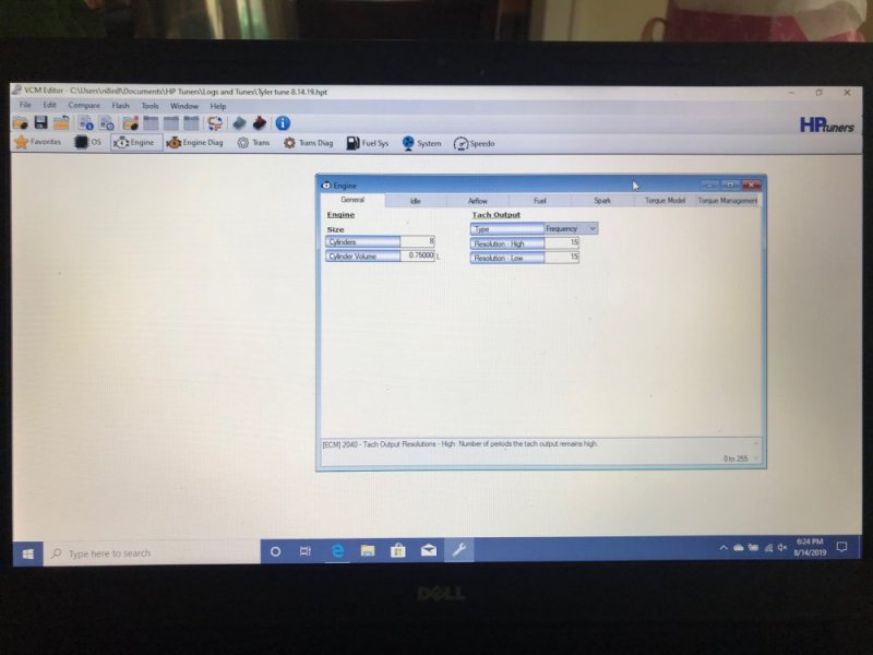

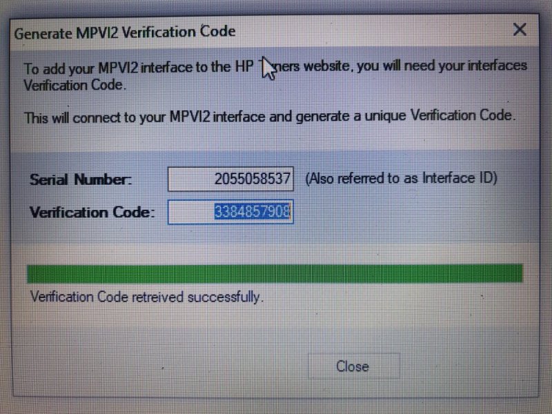

Next thing I needed to do was start playing with the tuning to get ready for towing. I mostly wanted to play with trans stuff, but I'm also interested in playing with the engine tune. My tuner uses HP Tuners and said he didn't lock the tune so I could play with it if I wanted. So I bought HP Tuners to do some messing around. So far I've only played with the torque converter lockup a little. There's more I want to do, but I haven't had time to play much. I did do one data logging run and it's really interesting the data you can see! More to come on this I'm sure.

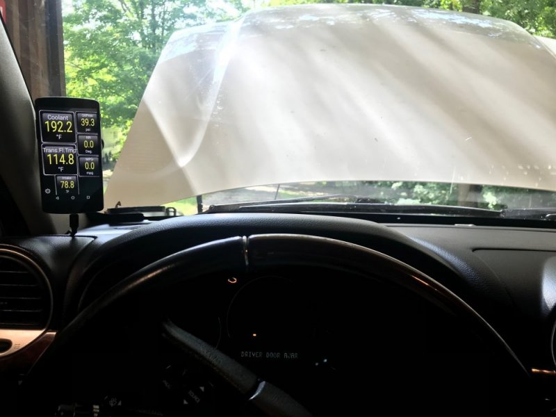

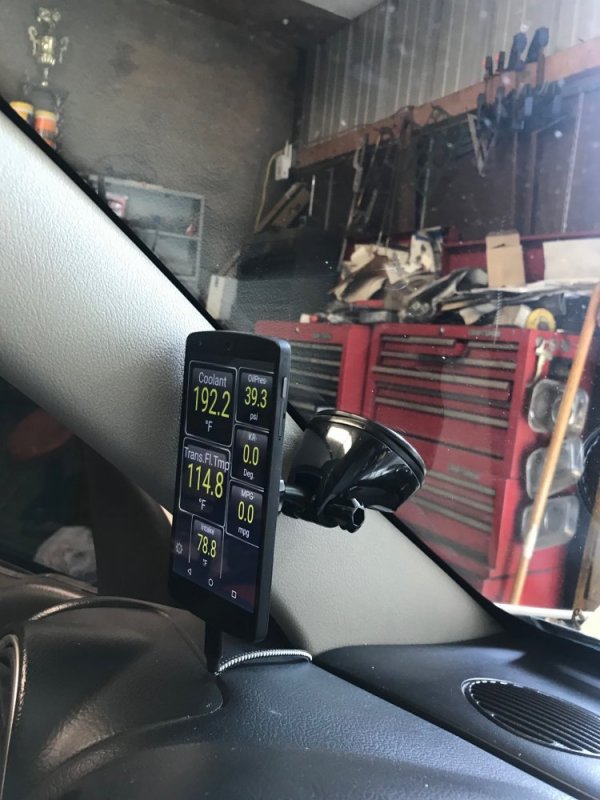

And after the data logging I saw some things I wanted to keep track of real-time...…plus I wanted to monitor transmission temperature. An nGauge would be perfect, but the $400 price tag isn't. What I did instead was get a used Google Nexus 5 for $50. I downloaded the Torque Pro app that lets you configure the gauges you want to monitor. Then I got a windshield mount and wire in a USB power supply in the dash. Now I have multiple gauges I can monitor, plus do 0-60 and 1/4 mile stuff if I want. It's a pretty neat tool to have at my disposal. More of this to come as well....

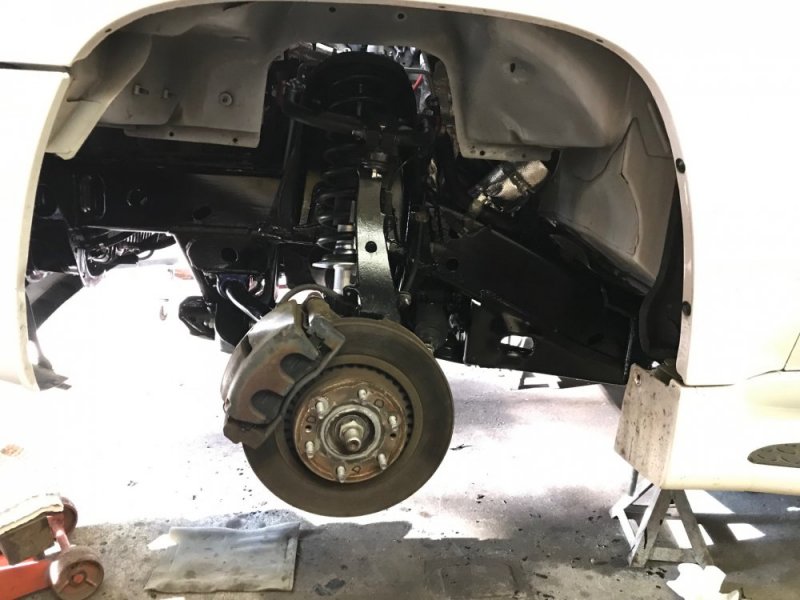

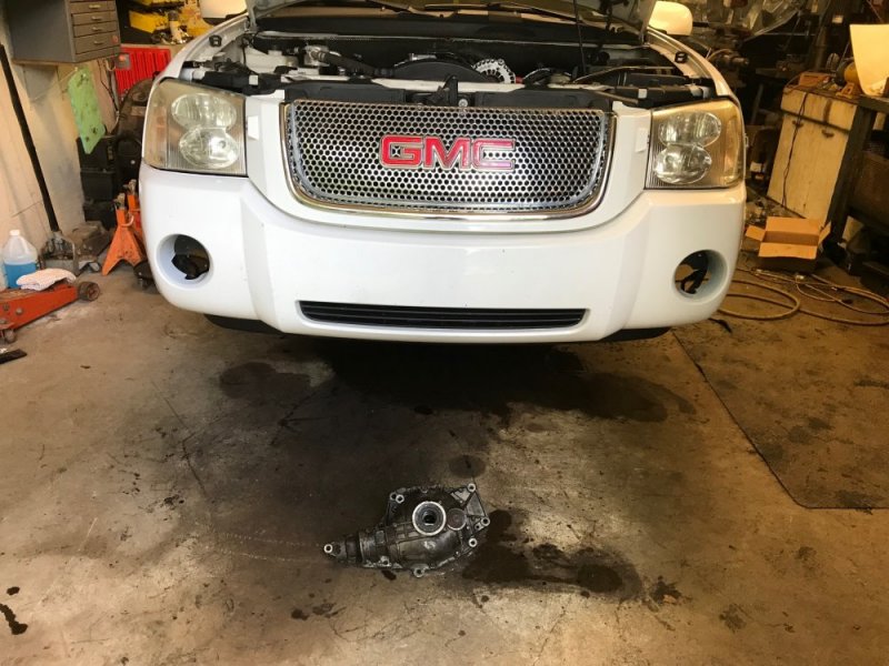

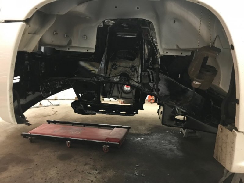

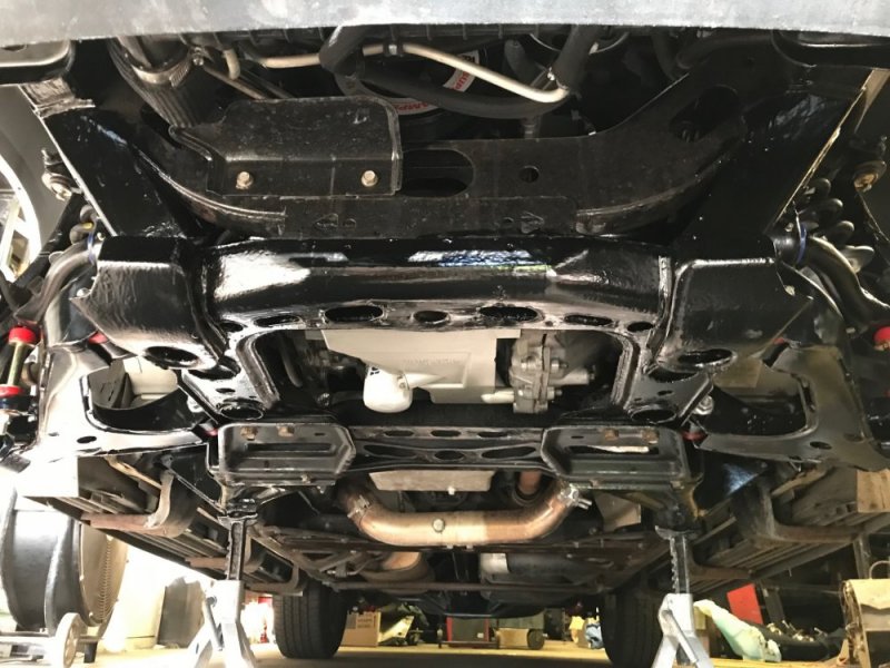

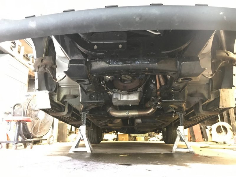

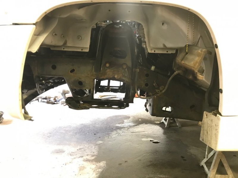

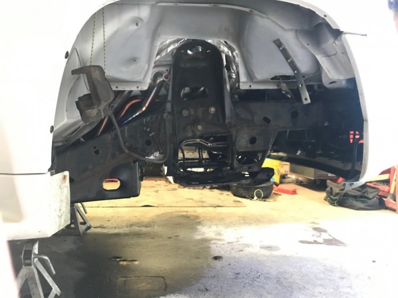

Time to upgrade the front to match the back. The main driver for this was doing the diff swap so I would have 4.10 gears front and rear. You have to tear a significant amount of the front apart to get the diff out, so I figured that it made sense to upgrade the front suspension at the same time. This project would also contain the typical de-rusting and rust preventive painting as the other areas have had. I took Friday and Monday off of work with the plan being: Friday - teardown/wire wheel/paint prep, Saturday - paint, Sunday - assemble.
Here's what Friday looked like at about 2:00 in the afternoon. Yes, you have to remove the oil pan to get the diff out. Ugh.

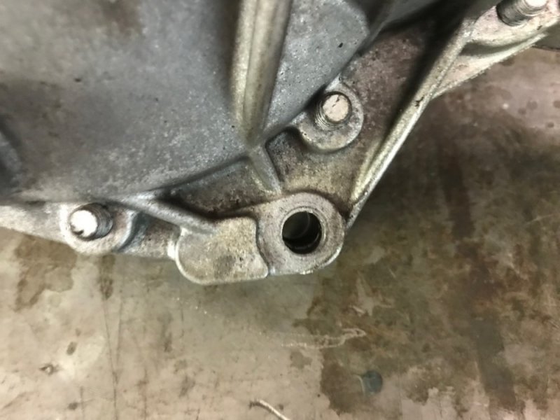

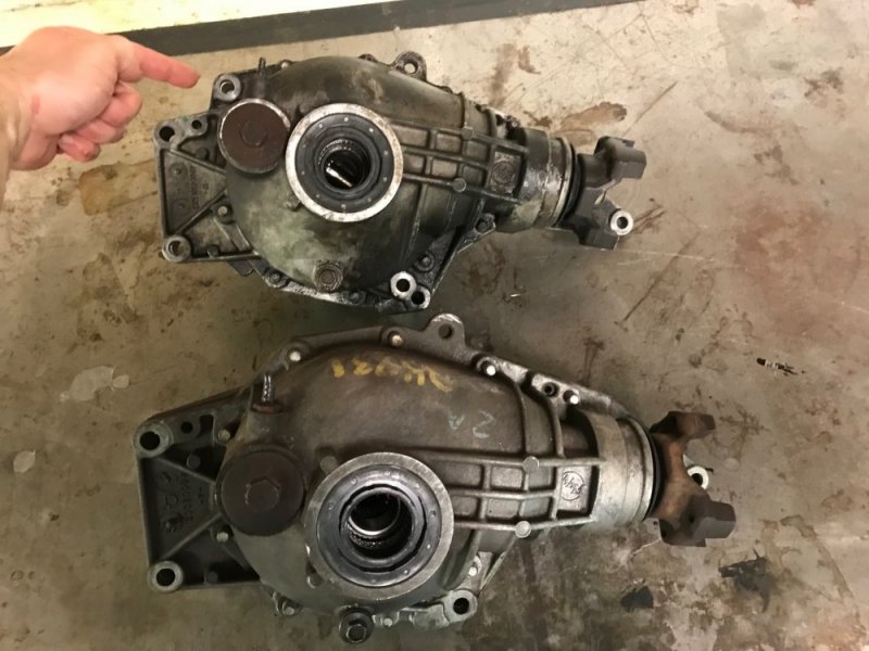

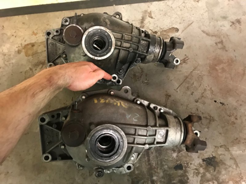

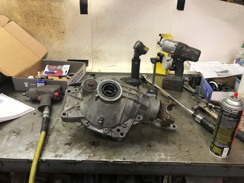

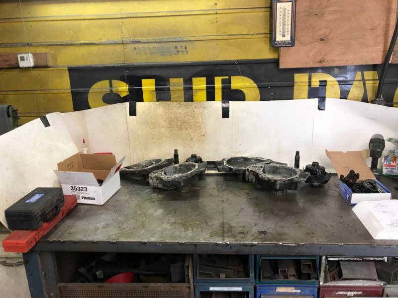

I'm going to sneak one more post in. This is where the weekend fell off the rails..... I went to put the diff I purchased with 4.10 gears in and...………………...the bolt holes didn't line up. Dammit!!
I knew there was an interchange to be aware of, but I misunderstood what was being described. Once I had them side by side, I saw what they were talking about. In the pictures below, I am pointing to the holes that are missing in early differentials.
So I did some searching and decided my best course of action was to take the 4.10 gears out of the one diff and install them in my original 3.42 diff. I ordered a rebuild kit from Summit and hoped it would show up in time to keep me on schedule. Then I disassembled both diffs.

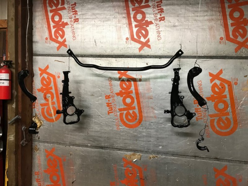

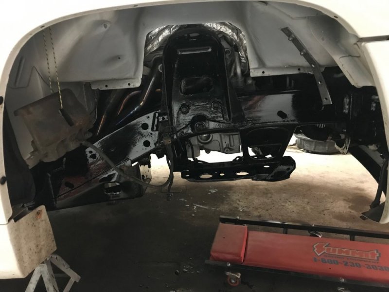

So I regrouped..... Friday after I ordered the rebuild kit I wire wheeled the frame and the suspension parts I was reusing (the knuckles, sway bar bushing brackets and the strut links).
Saturday was paint prep day. I applied the KBS Klean degreaser and then the KBS Rust Blast.

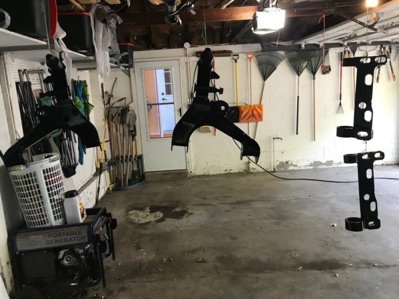

Sunday was paint day. I painted the new AC Delco lower control arms, the reused suspension parts and the frame.
I didn't receive the rebuild kit Saturday. Fed Ex was showing a delivery date of Tuesday. So rather than waste a vacation day I went back to work Monday and took Tuesday off instead. The kit actually showed up Monday afternoon so Tuesday after work are started assembling the diff to get a jump on Tuesday. I honed out the existing pinion bearings to make getting the pinion shim selection easier. I was pleased to get it set up right the first try! These 7.2 IFS axles are strange since you don't have a cover to work through, but they are nice that there are adjusters on both sides of the carrier rather than shims. I used my GM manual to set it up, but I also found a nice thread on setting a 7.2 up that was a nice supplement to the factory manual.
Tuesday morning started with final assembly of the diff. I had it ready to install by 9:30.

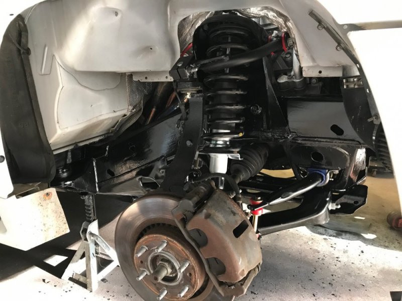

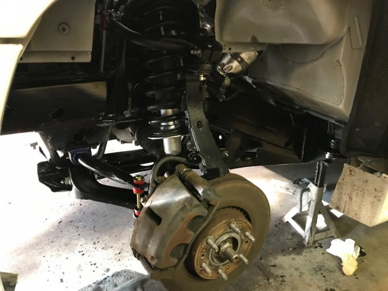

After that it was diff installation time and suspension assembly. It took longer to assemble everything than I thought it should, but I got it all together and back on the ground before dinner. I assembled the suspension with Prothane polyurethane bushings in the lower control arms, DJM upper control arms with poly bushings, Moog problem solver outer tie rod ends, Moog polyurethane sway bar bushings, Prothane sway bar end links and Bell Tech struts with the existing springs and new Moog strut mounts.
The struts have selectable collars on them for setting the ride height. I installed a collar set that would drop the front .5", which should have been perfect based on where it was sitting before (the cast iron 6.0 already dropped the front a bit, but it needed just a little bit more...). And the stance was pretty much right where I wanted it. The front measures 31-5/8" at the wheel well and the rear measures 31-7/8" at the wheel well, so 1/4" rake. I wouldn't mind if the front settles just a touch more, but at least I don't have a Carolina squat!

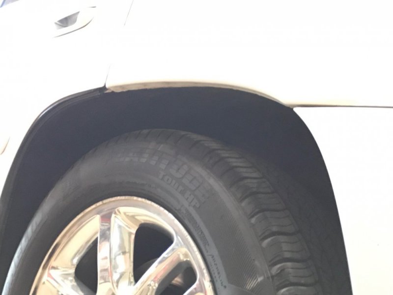

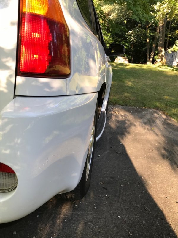

Another thing I was pleased to see was how the DJM arms kicked the top of the front wheels out flush with the wheel wells.
I think I need to get some spacers for the rear now to get them flush with the body.

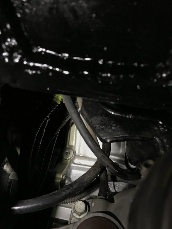

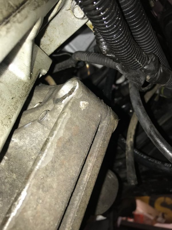

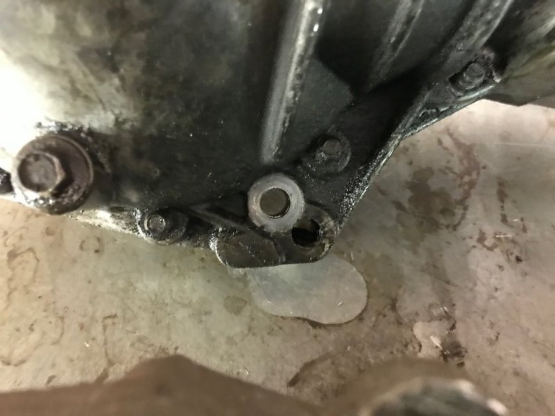

When I started the truck I had a check engine light. I ran the codes and it said there was a fault with the cam position sensor. Hmmm. Maybe I accidentally disconnected it when I was rooting around in there? I rolled under the truck and found that I had pinched the cam sensor harness between the block and oil pan. Dammit! So Wednesday night I worked on that. I hadn't gotten the harness between the pan and the gasket, but it was crushed in the gap between the pan and the block that the thick LS gasket makes. I was able to pry it out and I found one of the 3 wires had the conductor exposed and some of the strands were broken. I cut the bad section out and soldered in a new piece of wire. That took care of the code. Then I installed the inner fenders that I hadn't gotten to Tuesday night.

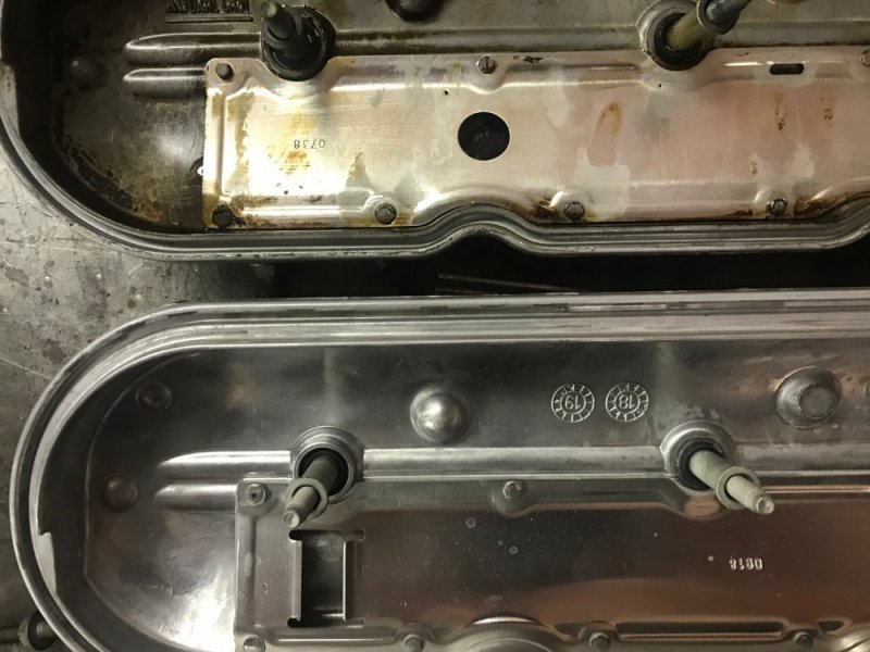

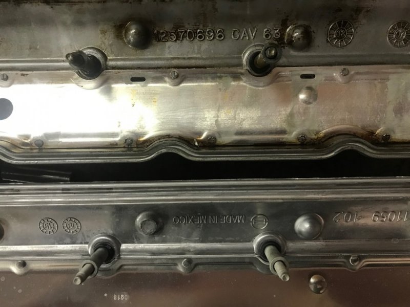

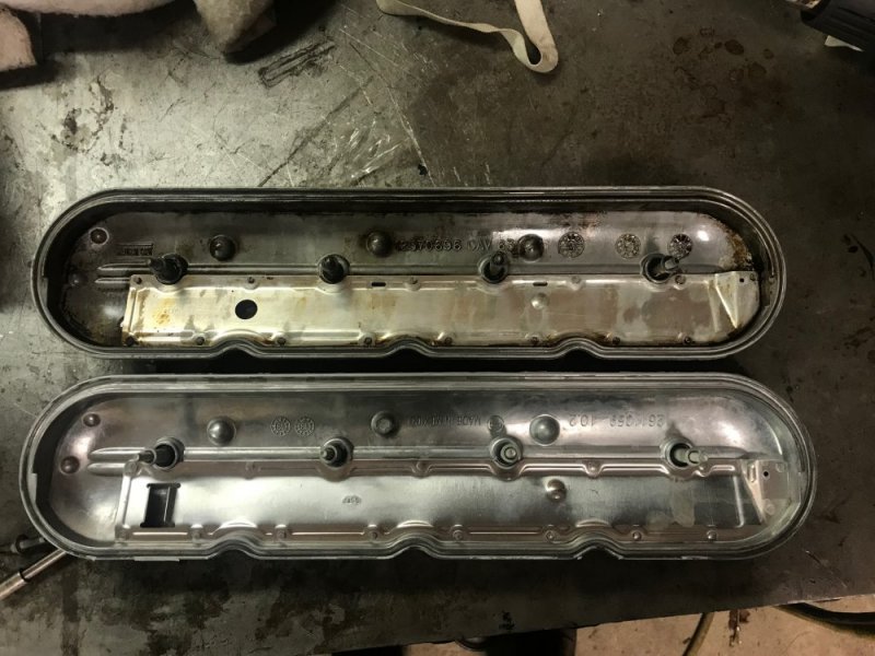

The last thing I did Wednesday was paint the new driver side valve cover..... I have still been having some oil consumption issues and at least some of it has been getting sucked into the intake via the PCV system. I have read about some LS engines having this problem due to the design of the valve cover. GM designed a new valve cover in 2010 I think it was, so by changing the valve cover you can fix the problem in a lot of cases. I bought the redesigned valve cover (PN 12570427) and put some of my leftover engine paint on it after cleaning it.
Here are some comparison pics. It isn't drastically different, but hopefully these small changes do the trick.

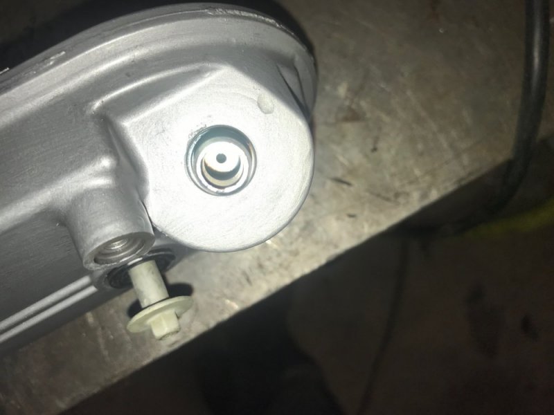

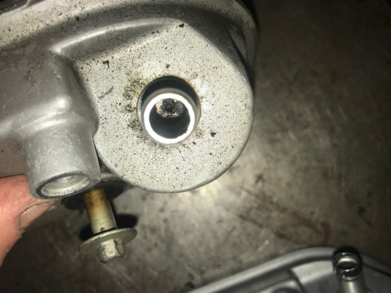

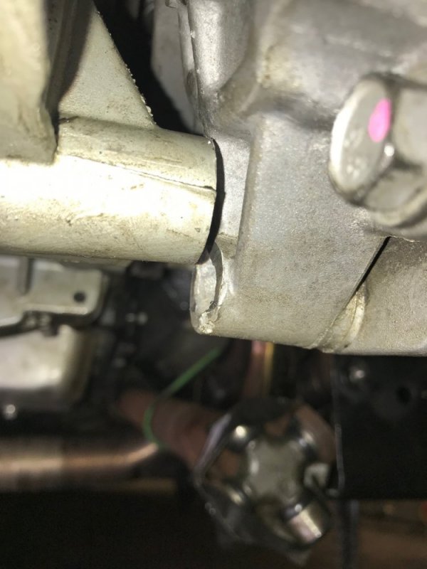

The plugs were installed at the machine shop so I wasn’t familiar with how it was installed. According to the manual there is supposed to be a sealing washer on it, but when I removed it there was nothing. Then I remembered the 5.3 block so I removed that plug and there was no washer there either, but it did have pipe dope on it. So I applied the GM thread sealant on it and reinstalled it. Hopefully that’s the last of my oil loss problems.

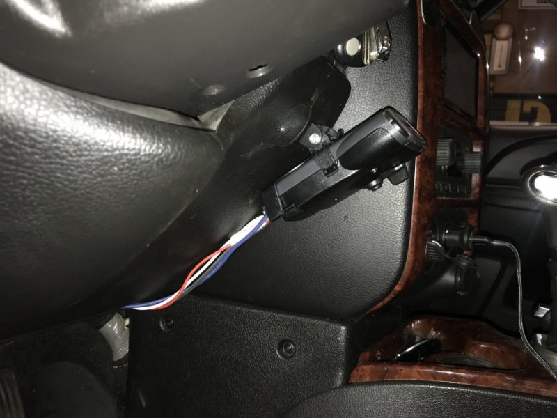

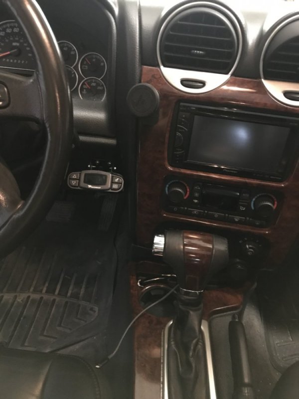

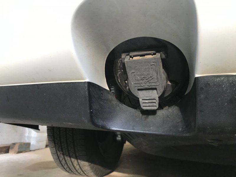

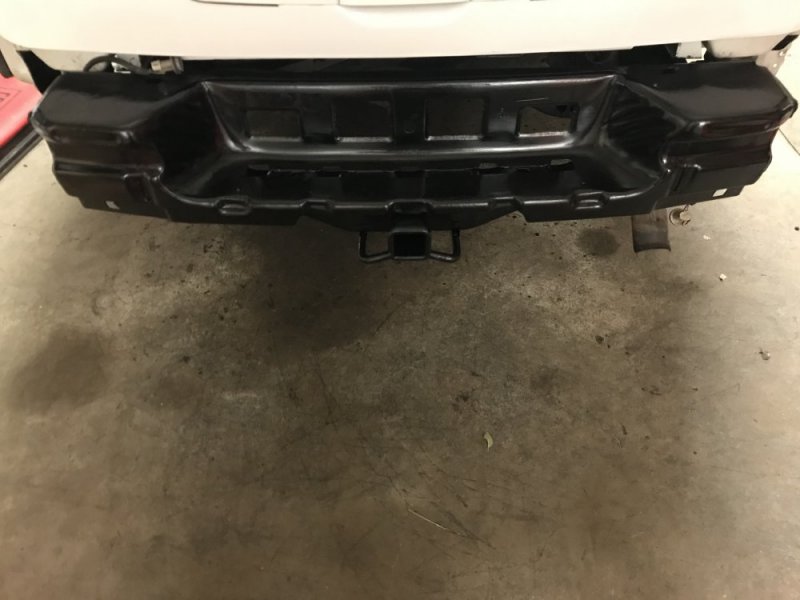

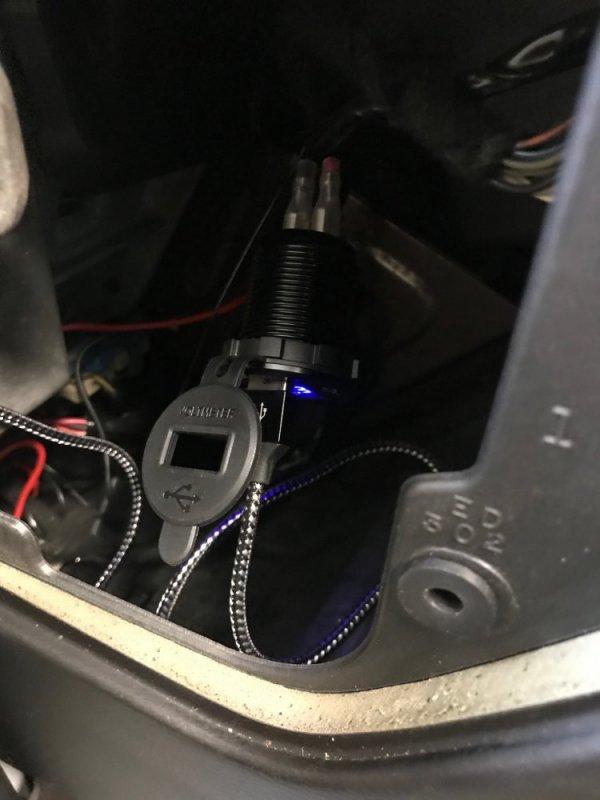

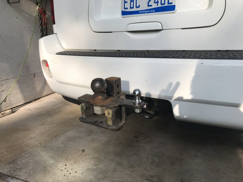

Next I started working on stuff to get it ready for camper hauling. First I installed the trailer brake controller. This is the first vehicle I’ve had that already has the wires run for a controller....the 7 pin plug is even factory installed. Nice. That makes it so much easier.
Then I set the height on the hitch. Surprisingly it only needed to be one hole higher than the Tahoe.
Just about time to hook it to the trailer and see how it does. 😬
View attachment 57977View attachment 57975

Grab yourself a little bit of the black wire loom, did this when I installed a aftermarket controller on my father-in-law's F150 and it looks much sleeker than the rainbow of wires. Another trick I have done was drill a small hole in the kick panel, put in a rubber grommet and run the wires directly in hidden by the case of the controller. Of course I can't find pics of either of these (stupid photo bucket issues).
