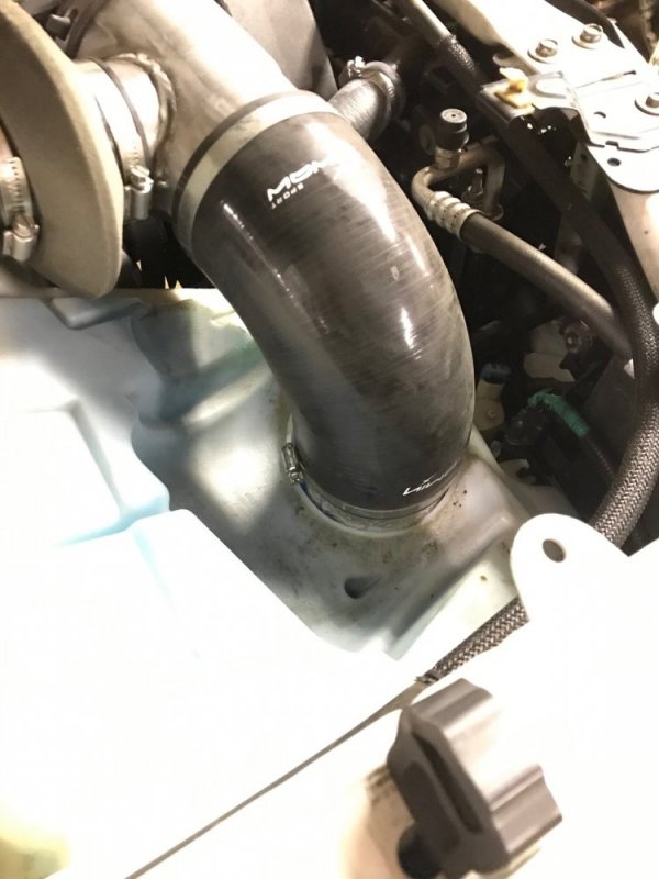

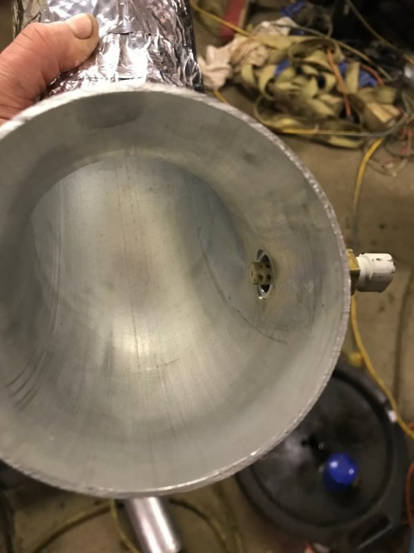

This weekend I did another update that I've been putting off for a while - finally installing my improved cold air intake. Last year I was having trouble with the air filter getting soaked with water. I installed the air intake bypass valve to prevent me from sucking water up through the filter. I never did suck water in, but occasionally my filter would get soaked, like after getting a carwash, and if I gave it a bunch of throttle the engine would bog, even with the bypass valve. Not an ideal situation for sure and something I figured would get worse in the winter with slush and any water that would get on the filter freezing. I have had all of the components to install an improved intake, but haven't made the time to install them.....I finally made the time this past Saturday. This is what the "improved" intake consisted of: I bought a 4" diameter aluminum elbow with long legs and cut one of the legs short. Then I had an aluminum bung welded near the filter for an intake air temperature sender. After that I wrapped it with DEI Tunnel Shield and aluminum tape to help prevent the tube from getting heat soaked. I bought a new AFE air filter that was slightly smaller, but had a conical filter built into the end cap for extra air.

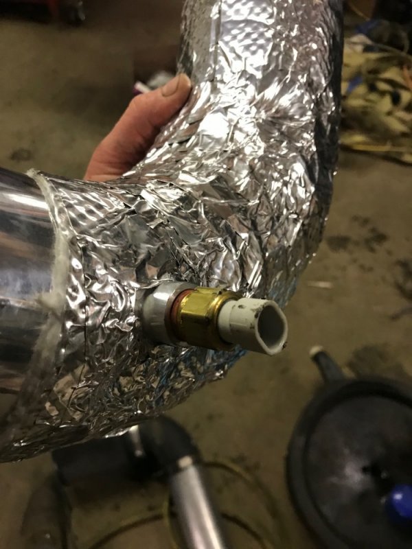

Here's the IAT sensor installed:

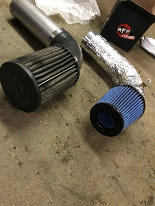

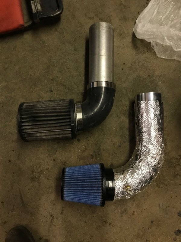

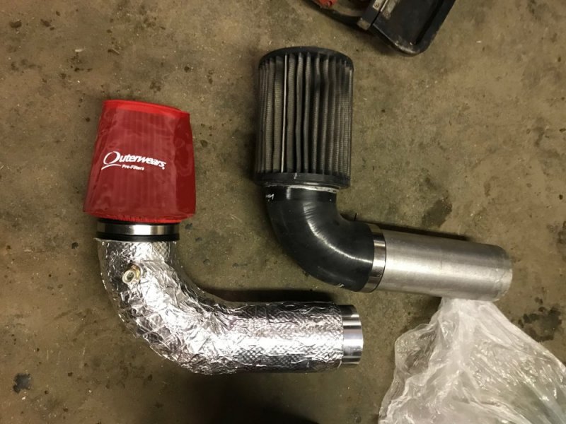

Here is the new intake next to the old intake:
And here is the final piece of the puzzle: a water-repellant Outerwears pre-filter. This should keep the water from getting onto/into the filter in the first place. It's a nice snug fit on the filter.

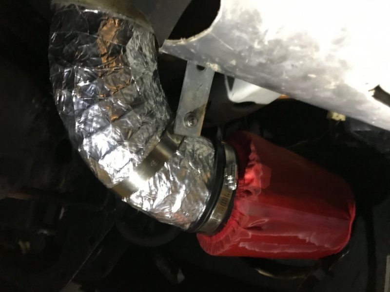

I installed it in place of the old piping and it fit in the old space the same though the radius of the pipe was slightly larger than the radius of the silicone elbow - the smaller air filter made sure it still fit.

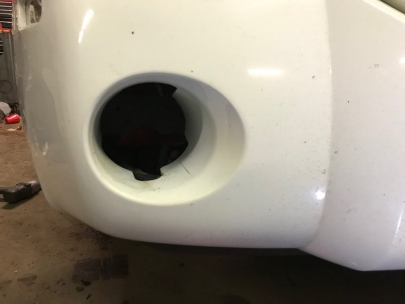

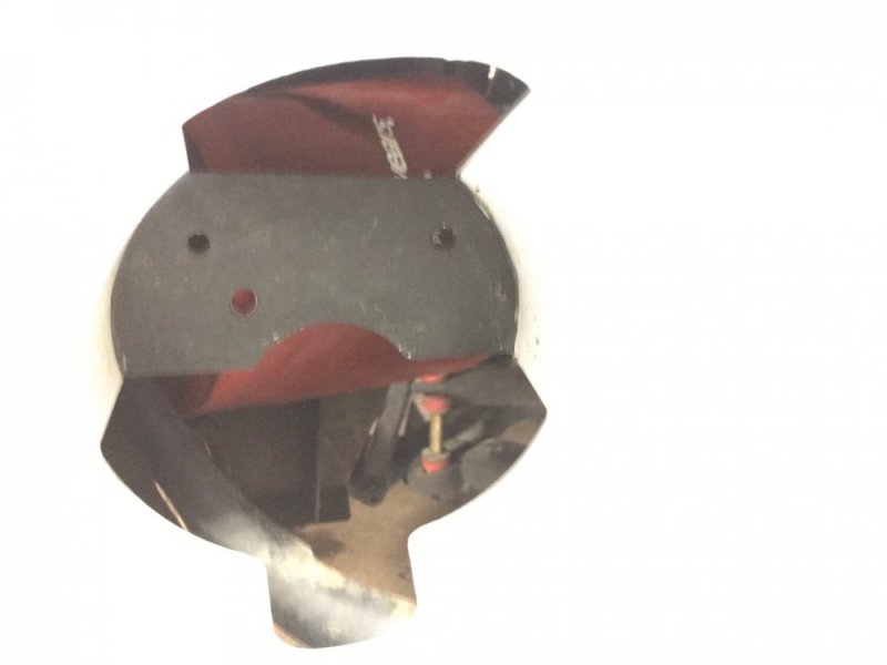

And I'm still sucking air through the fog light hole. I want to make a plug for the hole for the winter months so it will be less likely to get blasted with slush and snow, but that part still isn't done.

I understand why the filter is where it is, but just scares me. Sooo- snorkel! Nice cold air up high too and in the summer time actually colder air than next to the hot asphalt. Less dirt to ingest too.
I will admit not as smooth looking as the fog light hole, but your the guy to make cool things happen so I bet you could make a street snorkel look good!
full width 1/2” high “hood scoop” at the cowl?
I agree with you that the low intake is a bit scary. I'm still not a 100% fan, but it's the best compromise at the moment. I like the idea of a cowl intake, but I'm afraid of the extra noise inside the cabin - I noticed an inside noise reduction when I changed from the factory intake location to the fenderwell intake. As I was reading your comment I too did think about a low scoop at the cowl....maybe if it was a scoop rather than just a tube into the cowl it would be quieter? Also, when doing the installation this weekend I noticed that there is a lot of room between the grill and the cooling stack - maybe I can make some kind of a tube that sucks are from behind the grill into a box. Or maybe I'll just drive it into a pond, hydrolock the engine and cut my losses.....I'm honestly getting tired of working on this thing.
Whoa! starting to get burned out on a project means time to just drive and enjoy- which should be easier now that the ride is smooth!
I think maybe that is the skid steer or Tahoe I hear calling? Haha
The snorkel was a joke, but I am old school fan of a hood scoop as my hummer attests. Mine is just for the radiator instead. But the aerodynamic look of that ride- just cant picture a single side scoop looking right.
yes the full width at rear of hood would work, but would increase the noise and drag.
maybe naca ducts on each side of the hood like the Ferrari F40? A 3” on each side would have more than enough to feed an airbox and keep the noise away at the front of the hood.
Or a pair of scoop ducts (or just one atop the passenger fender) curved to match the contour and about 2" high at the high point and about 5" wide overall, one on top of each fender, up front near the grille so they can catch the airflow and ducted to an airbox containing your new filter/intake. Or your idea of capturing the air higher and in front of the cooling stack and ducting it over to the new filter/intake.

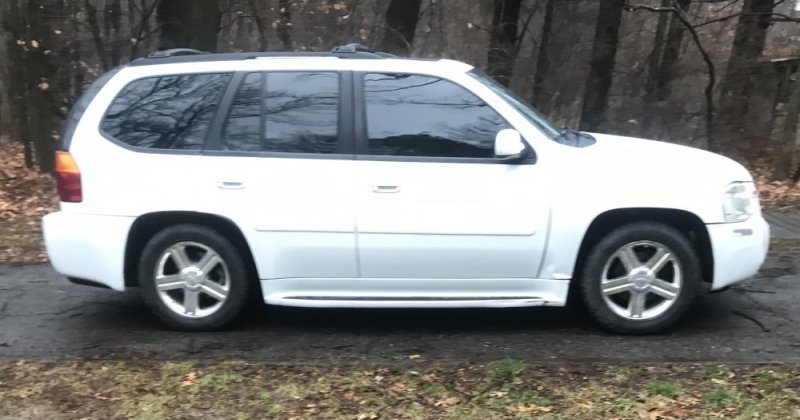

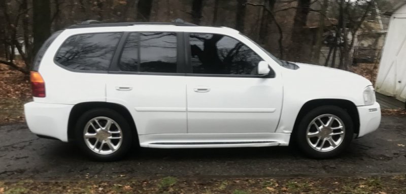

Had some fun with the Envoy tonight. Joined in a little mini parade to help one of the kids in the family celebrate his 11th birthday! It was a lot of fun and I think he enjoyed himself. It should be a great memory for him for years to come. Oh and sorry about the crappy quality, I couldn’t download the video so I had to record my screen 😅
I picked up another set of wheels last night so I can have my summer and winter tires premounted for easy swapping. I’ve been eyeballing the 18” Trailblazer LTZ wheels for a while because I liked that they had a nice 5 spoke design rather than most wheels for this platform have a symmetrical spoke design. I found a nice looking set locally for a good price so I bought them. I just installed them (with the tires that came on them) so I could see how they looked. I honestly thought it would be a more significant change than it is. I think what would make them look best is to plasti-dip them black and also do the chrome grill - that would match the rest of the black trim and tinted windows. In fact the GMC wheels could probably benefit from that as well.
Envoy Denali 18” wheels
Trailblazer LTZ 18” wheels
