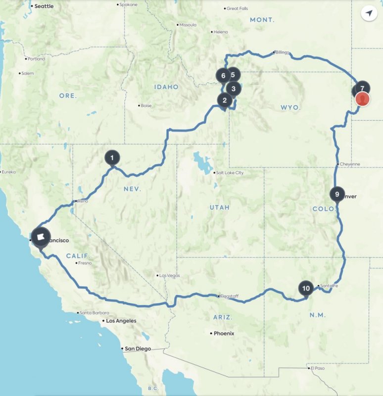

If your curious here is current planned route (currently in SD, headed to CO tomorrow):B349B70E-6A2D-4E09-BAD4-84D7FC42266C.jpeg
May I suggest, since you appear to he in Rapid City, that you just stay on US 385 south of Hot Springs instead of swinging west on US 18. You'll get to see some beautiful country as you drop down through the Buffalo Gap National Grassland and into the Pine Ridge area around Chadron and the Nebraska National Forest. When you hit just north of Alliance, it is more than worth the 3 mile cut over to NE 87 to see Carhenge, which was one of the best places to watch the total eclipse of the Sun in the US a year ago for both duration and clearness of the sky. I was there, along with nearly 15,000 people from all over the US, Canada and Central and South America to watch it. Keep going south on 385 as it skirts the western edge of the Nebraska Sandhills, then cut over NE L62A and drop south on US 26 thru Bayard, cross the North Platte River and stop at the most famous and iconic landmark along the Oregon, California, Mormon and Pony Express Trails, Chimney Rock. Continue down US 26 to Bridgeport and catch 385 south to Sidney, NE - founding home of the famous outfitter, Cabela's (recently acquired by Bass Pro Shop :mad:). Then drop south on NE 19/CO 113 into Sterling, CO and catch I-76 into Denver. A little bit longer distance and a couple of hours more time than I-25, but well worth it and quite doable in a short day of driving.

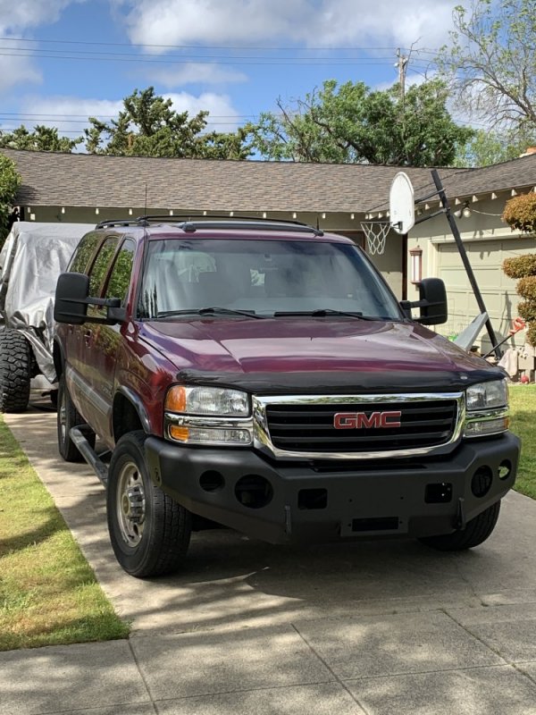

Recently I ended up taking the Westin tube steps off and going with some AMP research steps I picked up used for a good price. The wife is happy and I like the way it looks too.
And I picked up some trail Ready bumpers front and rear from a guy that ended up not using them. And I took the opportunity to swap the front grill for one from an 06 Sierra. It’s a little more squared up than the round bubble grill. I’ll attach some pics.
I installed my dsp5 switch on the dash and ran the wires through the firewall. Now I just need to upgrade the ECM and wire it up then load up ferms dsp5 Lbz tune. Hope to finish that up in the next few weeks.
Next up will be wheels and tires. Probably after summer. I picked up a set of h2 wheels. I also installed the PDM with tpm so I’ll get the tpms sensors when I mount new tires. Currently looking at Continental TerrainContact A/T in 285/70r17. We’ll see how that goes. Ok time for some pics.
