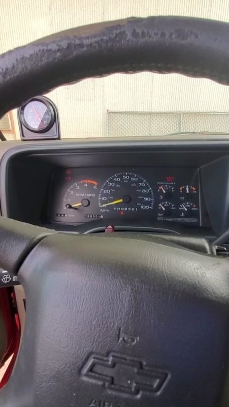

Truck shut off this morning after warming up although it seemed like it died sooner than normal. Unfortunately I did not have the scanner connected to the truck so I don't know what the actual temperature was per the ECM. The check gauges light came on and then the battery light (Brake light has been on since I bought the truck) The truck started to idle lower and as soon as I moved the pedal and let off it shut off. I was able to get it to start again but required me to give it throttle while cranking. At that point it would not idle and shut off as soon as I released the pedal. Over the past few days I cleaned multiple connectors with electronic cleaner and a wire brush also checked the grounds and found nothing unusual. In order to set the timing it has to be above 170 degrees. It wants to shut off above 170 degrees so I'm forced to keep my foot on the throttle to get it to idle at about 1000 RPM while watching the scanner my act timing will fluctuate around 3.5. it will drop down to 3 and go to 3.9 is it possible I have the timing set wrong maybe it's retarded? I did remove the extension harness the other day and the truck acted the same with the pmd plugged into the pump.

I hate to say it... but it sounds to me like you may have another bad injection pump. Get it warm to the point where it stalls and is hard to start. Then pour a gallon or two of ice water over top of the pump. If it starts better then you have a bad pump. If it's still the same... DB2 swap time.
Can you post video to youtube and put a link here of it?
Description really sounds like fuel starvation, but hearing/seeing it can help sometimes.
Do the cold water test, but in my opinion- NEVER change an ip without doing fuel pressure test and being 100% no air in fuel or other fuel contamination.
What was result from clear fuel line? Can you show it in video also?
Your description sounds exactly like the video I posted with the 6.2 db2. Air in line was the only problem.
also before ip swap is use a fuel can with new fuel in it feeding directly to the ip to ensure any fuel supply issues aren’t the problem.
x2. The new IP is supposed to be rebuild. I think you still get a bad IP.
I thought you have source of a good rebuild IP locally?
That right there is the scary part of anything rebuilt. Rebuild alternator or starter fails soon after installing. Suddenly the remorse of not having paid more for brand new...
Most pump builders reused the H&R assembly because it can be around $750 for a new one. That's almost more than most rebuilt pumps cost. So it's not uncommon to have a "rebuilt" pump that has over 100k miles on the H&R already. With the age of these engines the pump builders are running out of good cores. If you want a good quality pump buy a new one from stanadyne. Otherwise get used to going through 3 or more pumps till you get a good one.
How much fuel is in the tank? Try a 5 gal can of diesel. Old fuel gauges (senders) don't always work. X1000 on clear return line looking for air.
Making sure that there is lots of fuel in tank should help.
There were a lot of members have this type of issue only to find out that it was caused by low fuel level.
