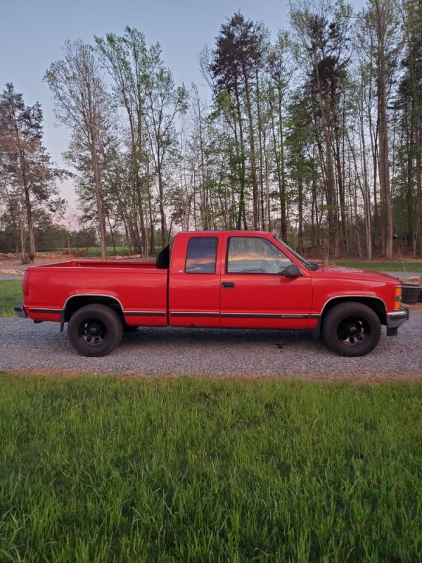

So I finally have some good news for this forum. I took a break with the truck because quite frankly it just pissed me off. Bought a set of new Bosch injectors about a month ago and finally got around to installing them today along with new return lines. Somehow found two injectors that were slightly loose but after replacing everything the truck seems to run fine and I've been able to drive it so far with no problems. Thanks for all the help from everybody on this thing hopefully she lasts for a while.
