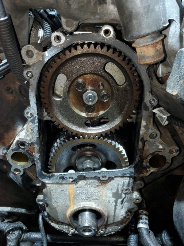

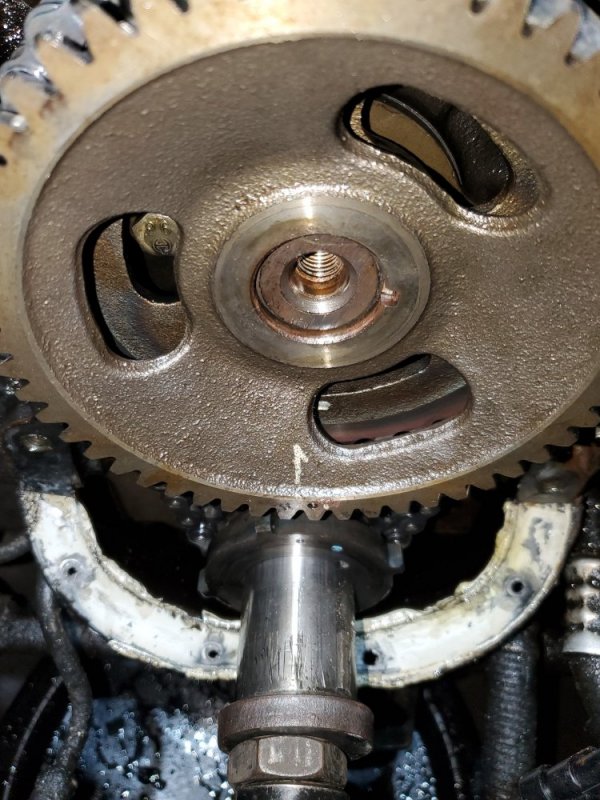

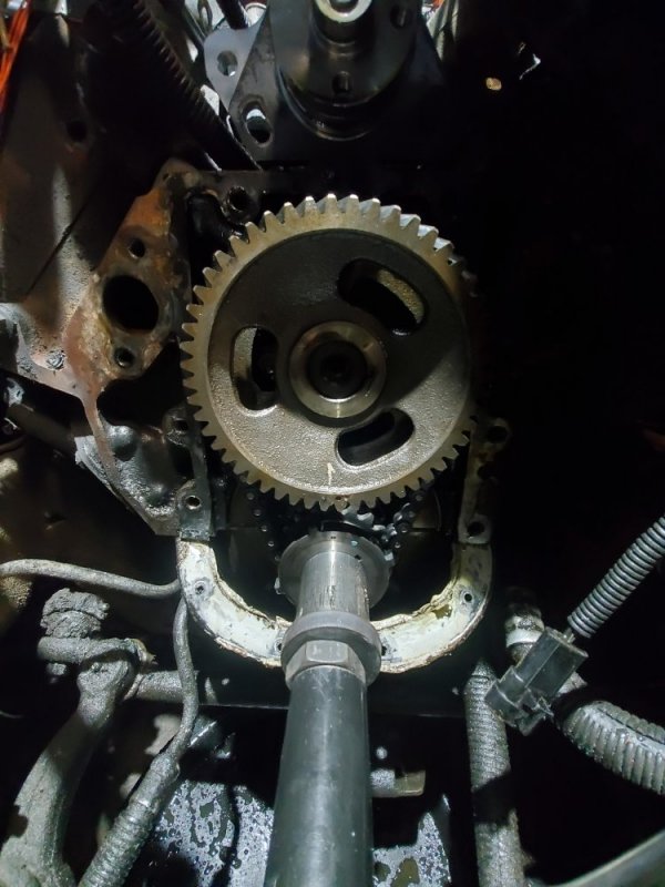

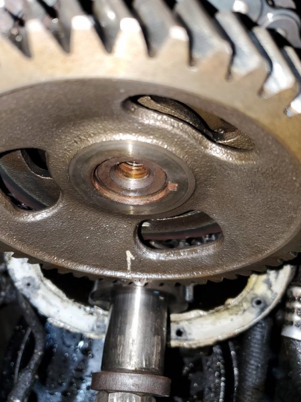

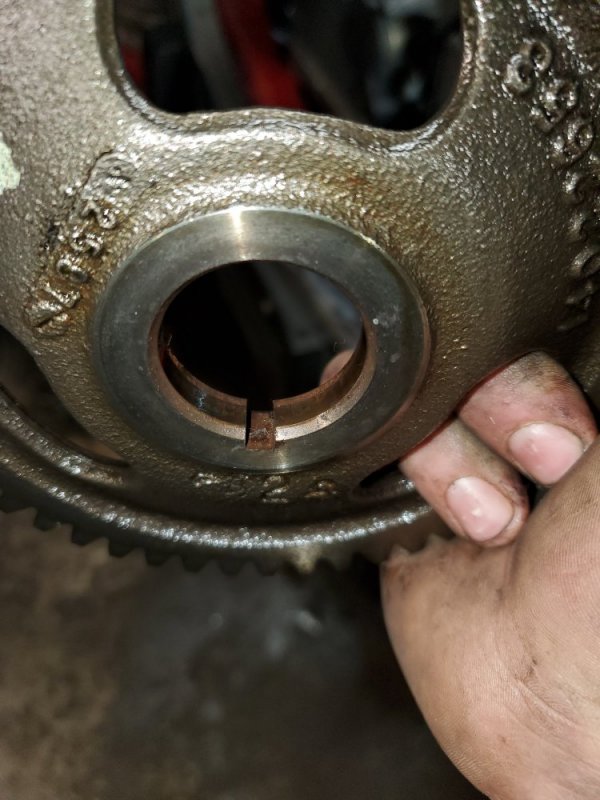

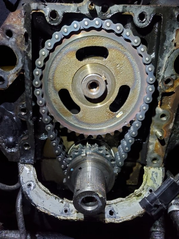

Howdy y'all long time no speak. So I finally found motivation to tear apart the truck. I was told to pull the cover and check the cam for a sheared key. I see nothing wrong with the cam so yet again I'm stuck. Unfortunately I paid no attention to the timing marks on the injection pump and the gear on the cam to see if they lined up but is it possible to have the injection pump mechanically timed wrong but timed properly electronically? The reason I was told to check the cam was because my TDC offset value keeps jumping around after the truck is shut off and restarted.

STOP!!! By the pictures you need to step back before you pull the chain off. You don't have the crank and cam timed properly!!! You are timing the crank sprocket off the IP gear and that's a rookie mistake.
This engine has two separate items to time with two sets of marks: cam and crank then cam and injection pump.
So you time the IP gear to the IP cam gear with the dots matching.
The crank sprocket and cam sprocket are timed by dots as well on the sprockets: ignore the IP gears to time the chain.
DO NOT ROTATE THE ENGINE WITH THE CHAIN OFF. Or you will bend a valve.
I noticed that I needed to time both sets and upon observing the pictures more it appears somebody has been in here before. Since I don't necessarily see anything damaged I am going to time everything and reassemble the pump and front cover to see what it does.
