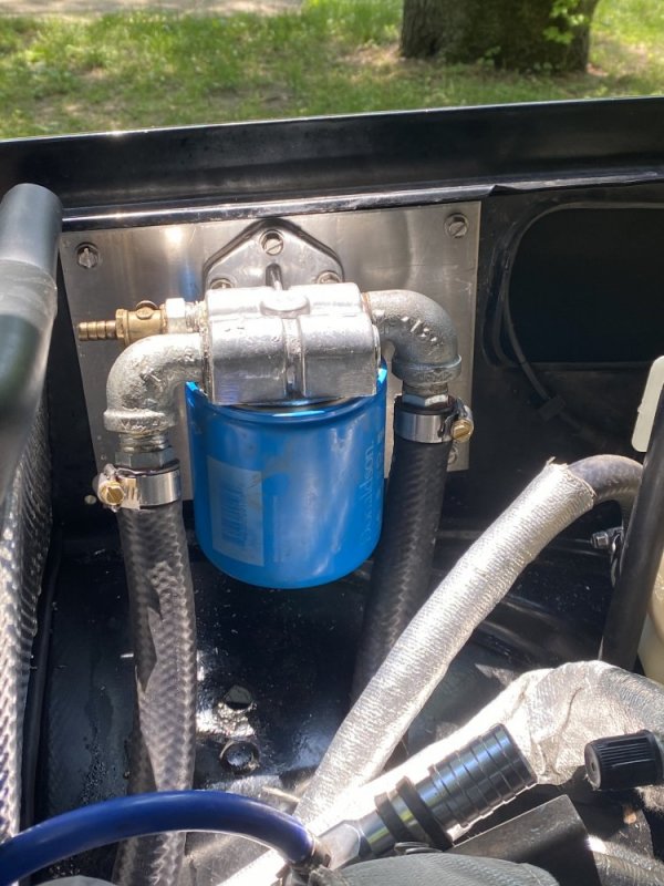

Last night I got the intercooler pump wired and the system filled with water. It took forever to get the pump to prime, but I finally got it to after pressurizing the system with a pressure tester. The next iteration with a tank in the rear will have a much more favorable plumbing situation and pump placement.
