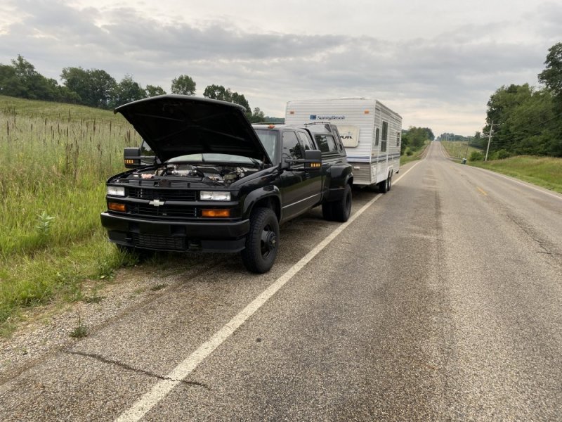

After we checked out of the campground on Tuesday, we dropped the trailer off to an RV frig repair place not far from the campground. They had the coil replaced and the frig was working on Wednesday. So last night (Thursday) after work, I drove down to pick the trailer up. I got 15 minutes in to the return drive home and the trans quit. I had cruise control set and the engine started revving up. I looked at the trans controller and it was flashing various codes at me. After trying to give it throttle a couple times to see if it had anything at all I threw it in neutral and coasted as far as I could. I just crested a hill and pulled over....unfortunately I scrubbed speed faster than I realized and didn't get it quite as far off the road as I would have liked.
I shut it off, looked up the trouble codes and then started the truck again. Nothing. The codes weren't very helpful. Then I could smell it - trans fluid. I looked under the truck and saw a red puddle. It was all over next to the trans. One of my new, effing expensive, looks cool but now I'm questioning if I did the right thing, AN hoses. EFF!! So I called a couple tow companies until I found one that could help me. They threw the truck on a rollback and the guy brought his personal truck to hook up to the trailer.

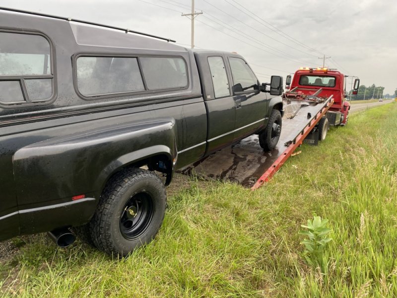

The shop my brother works for has a sister shop nearby so I had it towed there. That's still 40 minutes from home. My girlfriend drove down to pick me up. I got the Envoy loaded up and brought the trailer home with it. So dumb I have to keep using the Envoy to haul heavy loads home. Luckily it was cool out and I didn't have to worry about heat killing something in the Envoy again.
I'm going to get stuff together to patch the hose with some barbed fittings and regular transmission cooler hose, but now I feel I'm at a crossroads for a permanent repair. I used all this braided AN hose because it not only looked cool, but it should have held up for a really long time. However, it obviously didn't and now I'm realizing that if I get stranded, I'm SOL for doing a roadside repair. So maybe it's not the best choice for this application after all. Maybe I need to stick to off-the-shelf AT hose and barbed fittings? Maybe I need to make some hard lines for the trans? Maybe I messed up the hose when installing the fitting and I need to try it again and hold my tongue in my mouth a different way? I looked up the order and I see I used Vibrant hose and Russell fittings (just chosen based on cost and availability at Summit).......maybe there's some incompatibly issue there I'm not aware of? Maybe Vibrant hose sucks? So many questions and I'm not sure which route to go. I think I need to give Summit a call to see what they think and maybe even Vibrant. I just don't know what route I'm going to go, but I'm feeling pretty bad at the moment. I did all the work on this truck, and spent extra money to put all this new stuff on it so I wouldn't have problems.....and then what happens? The work I did failed and it wouldn't have failed if I had just kept it stock. I'm not a happy camper at the moment, that's for sure. What a kick in the ballz...... Oh and now I'm also hoping the trans isn't screwed. I had Schaeffer's All Trans Supreme in it, so I'm hoping that saved the trans. And oh yeah.....gallons of expensive ATF under the truck and on the road now as well. And a $250 tow bill. What an expensive venture.
