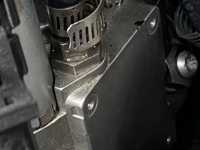

There is also some fuel wetness around the base of the inlet fuel fitting to the IP:

The leak at the ip is just that- a leak. Remove, clean, inspect, re-install. But that is NOT your problem.
it is sucking air in before the lift pump- (most likely)
If there is a bad connection or hole in the fuel line after the lift pump, it will leak out fuel.
When there is bad connection or hole in the line before the lift pump- the lift pump is creating a vacuum in the line feeding it. So wherever a hole is, it will suck IN AIR. So you have a “leak” from tank to lift pump that is allowing air to “leak” in.
There is one other possibility: the ip is allowing air to get pulled in after the primary pump. This is REALLY rare. The way to verify is put clear line between the ffm and the ip. If No air bubbles are ever found going into the ip, but they are coming out- the only fix is resealing the ip or if the head/rotor is damaged and creating cavitation-which basically means having it rebuilt or replaced. This is very rare, but can happen.

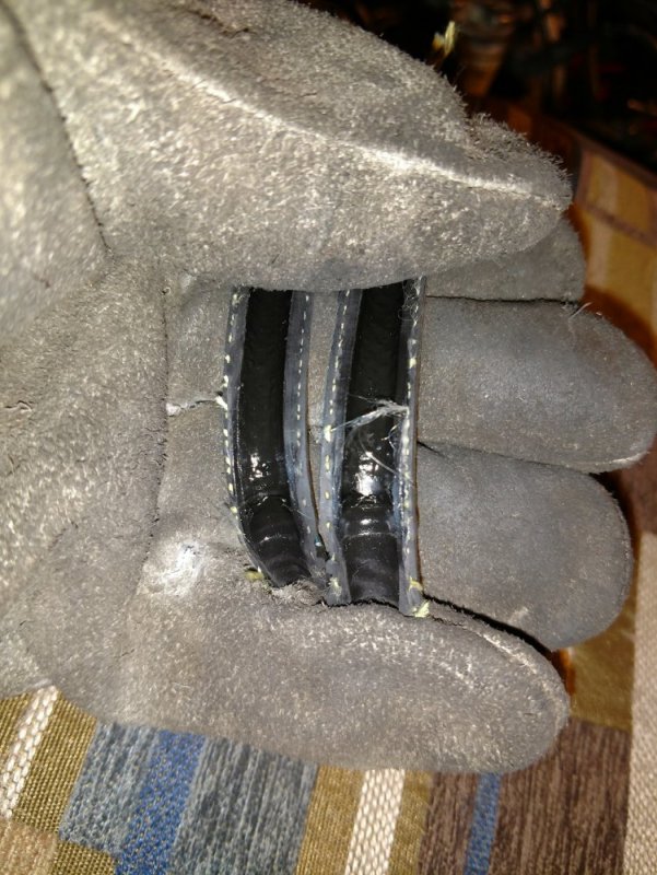

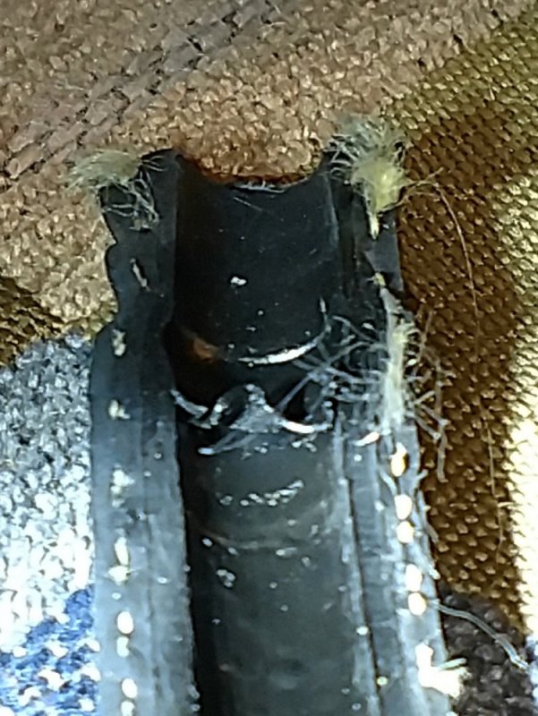

@Big T How old is the leaking hose? The hose from the FFM to the IP...
In general a leak on the LP pressure side wouldn't be a problem, but, kinking shut hoses and hose flappers gave me no end of dammed grief.
At the inlet of the IP so the pressure gauge was useless.
It’s from a FTB kit and is probably close to 10 years old. I will replace it. The hose from the tank to hard line is probably original, as is the hose from hard line to lift pump (Walbro FRC 10). I installed the spin on filter after the lift pump per instructions here.
Lowered the tank and removed the fuel lines. However, to the fuel tank the hoses have crimped on compression fittings that thread onto opposing nut on the pick-up/sender. The other end of the hose has a fitting compressed onto a hard fuel line that you cannot undo. The hard line has a compression joint further up the frame rail in front of the axle. I would have to order replacements for these and GM OEMs are in the $100 each price range.
How likely is it for a leak to be in these hoses? Should I first try replacing the hose from the hard line to the lift pump?
I’ve got some slight wetness on the fittings to the filter, but this is post lift pump. The hose from the hard line to the lift pump is brand new and is hose clamped on.
I guess I could ditch all this Walbro crap and go back to the stock in-line lift pump which has compression fittings to hard lines on both sides, thus less chance of leaks versus the Walbro with elbows threaded into the pump and hoses clamped onto the elbows.
