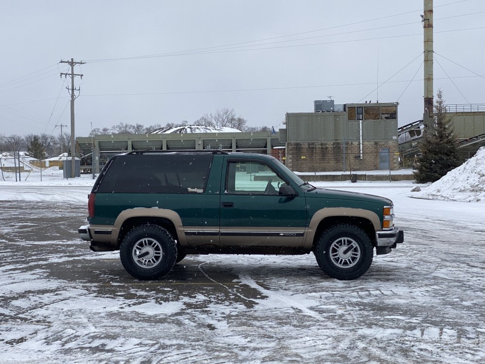

I went to the junkyard for some treasure hunting today and that enabled me to get a picture of it in the open and in the light. I’m still tempted to lift it a little, but I think I’ll just leave good enough alone and leave it stock height for now and just refresh the front end with stock replacement parts.
A guy pulled up in his Yukon XL Denali and asked if I wanted to sell the Tahoe, so I guess he thought it looks pretty good 😎
