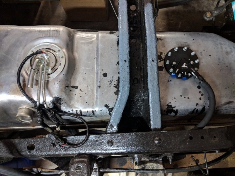

Hello. I worked with Mel’s old shop manager when setting this pump up. It is designed for a constant 25psi of inlet fuel pressure in all conditions. It has no surging at idle or part throttle. I’m not concerned about any problems with a larger volume lift pump - I’m trying to come up with a modestly proced fuel system that will provide the volume and pressure that the IP needs to put out maximum fuel - the current system can’t keep up so I’m leaving some power on the table.Hey Nate, any progress on your system? I haven't been on here in a while and I will admit struggling to comprehend everything that was talked about (my fuel system is stock and works for my needs right now, but I have talked to Conestoga about something better). Did you ask Mel if your pump was set up to handle 25psi input in low throttle/boost situations? Does it surge at idle/part throttle now? Or are you just concerned that it will happen with a higher volume lift pump? I apologize for my ignorance!
