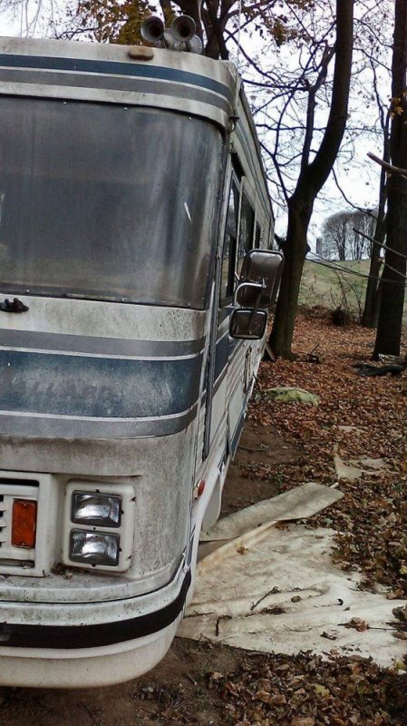

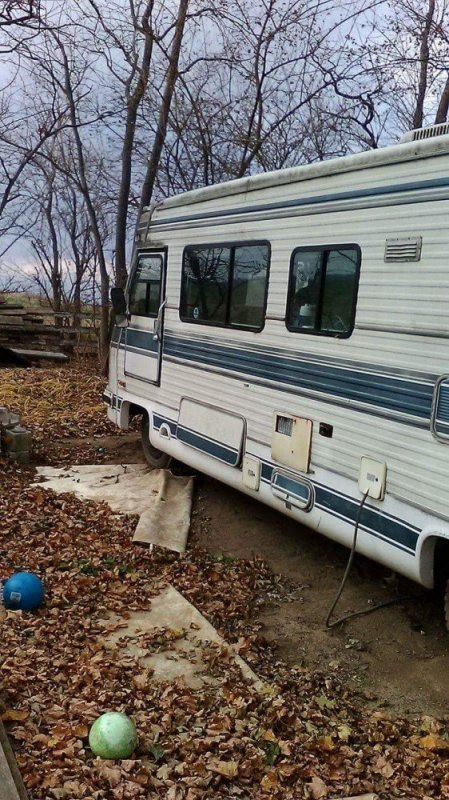

Well today luck finally landed on me and a buddy gave me a decent size rv. It was big block. My question is will the 6.2 have enough guts to move it, even if I can only run 45 or 50mph?
