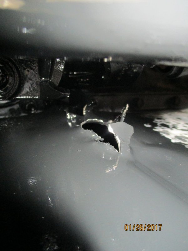

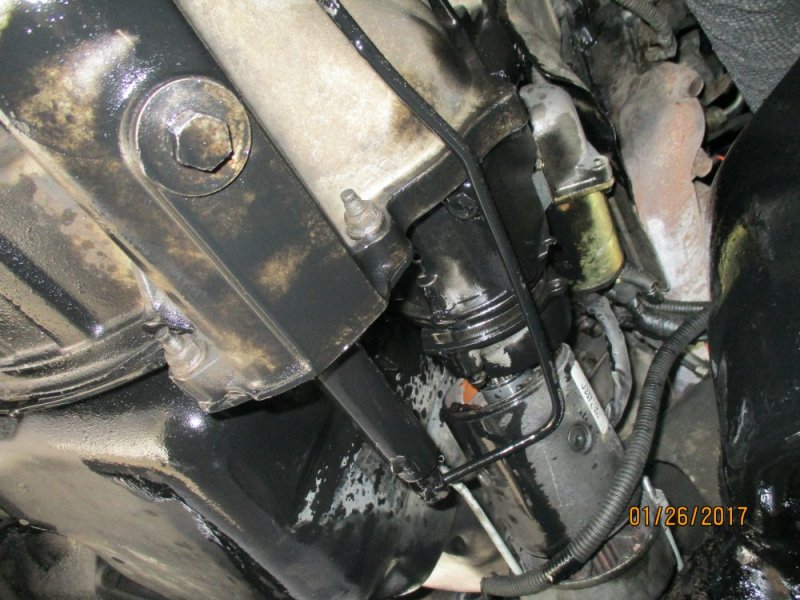

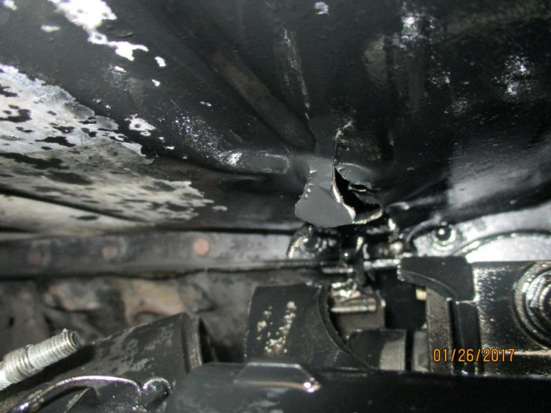

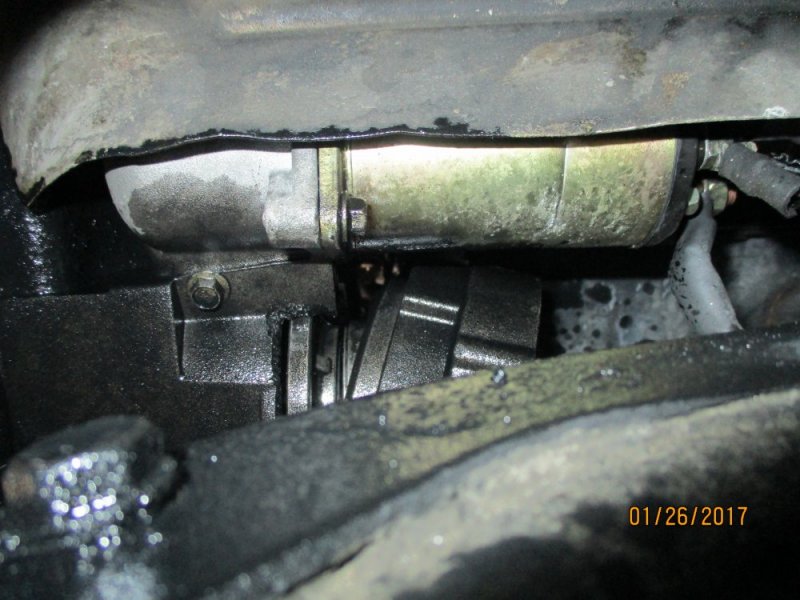

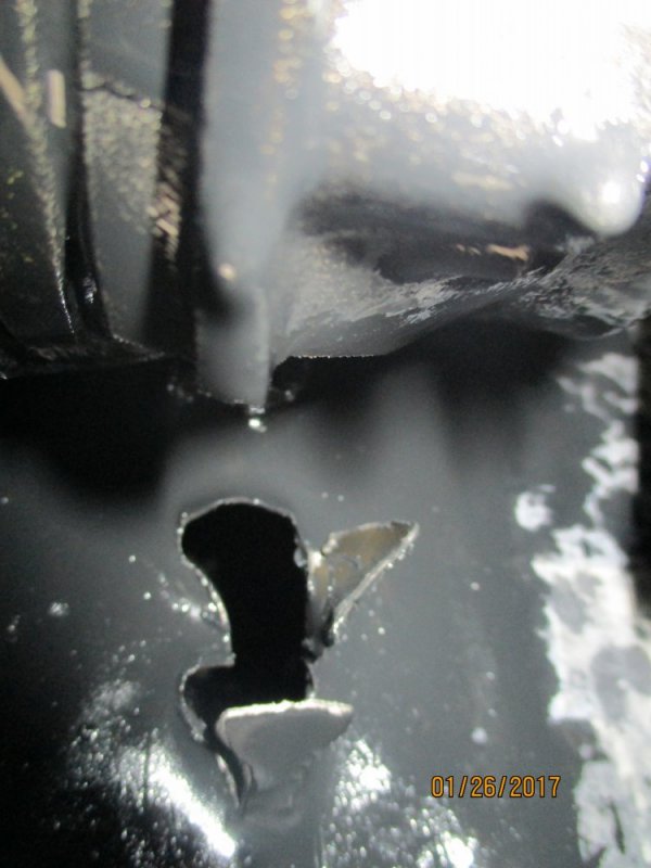

It finally happened. Nothing even exciting. Was just cruising down the road to work this morning, cruise set at 70mph, and what I can only assume is the connecting rod, decided she had to leave the party and wipe my brand new starter out with it. This was on my Optimizer 506 block

A injector would take the piston & smoke first me thinks... my bet is the block & crank is gone as well, the main caps can't stand to be knocked around much...
Looking forward to the tear down pics...
Rod bearing got squished and loosened up....
