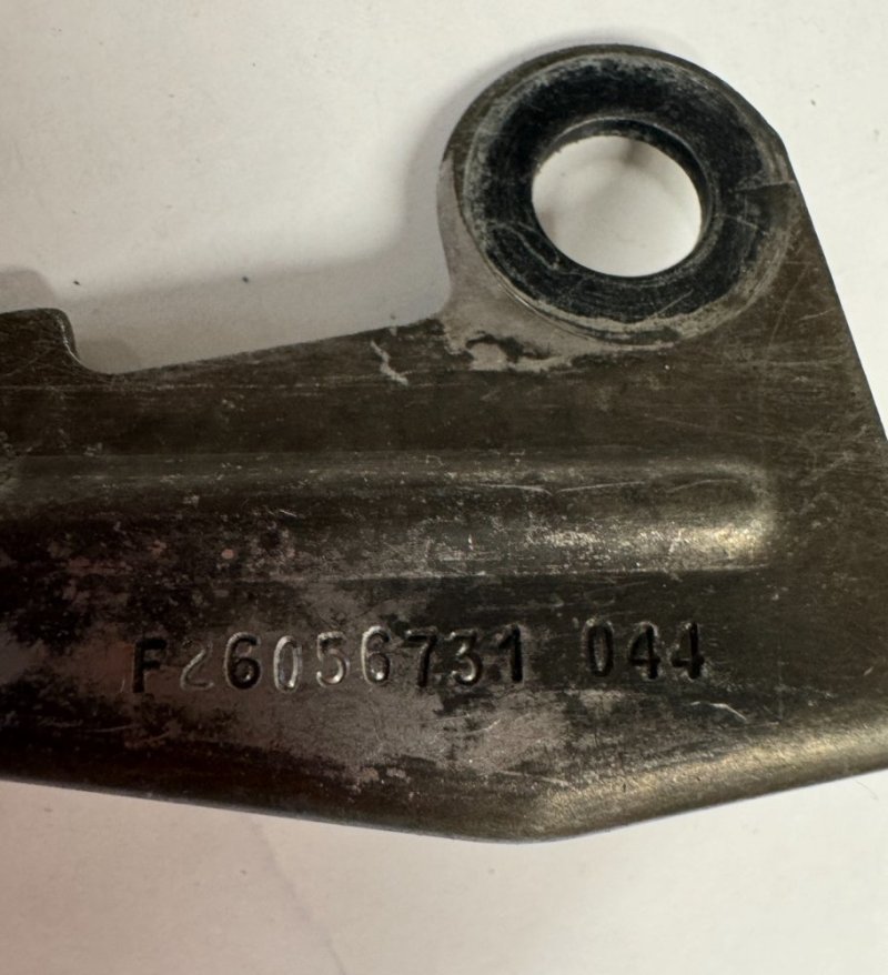

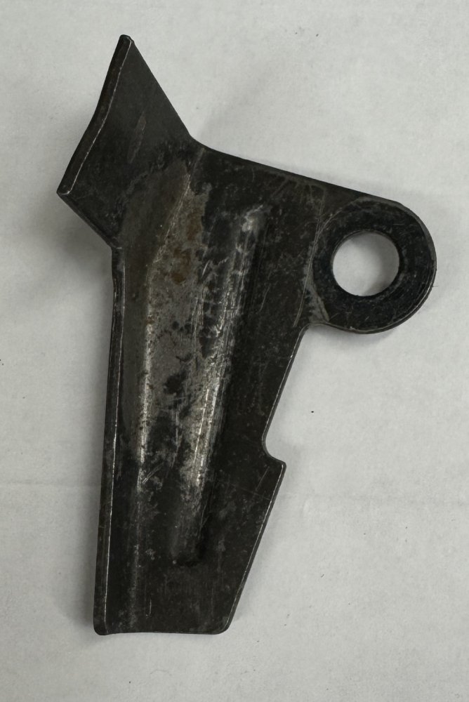

I remember removing this bracket but now I can not rememer just what position it came from.
I tried a search using the part number and I can find pictures of it, and also of an entire PS mounting bracket but no explanation of whence this unit belongs.
It does have a slight rub mar on the tab that hangs out 90* but I cant find, or, remember just which bolt location it came off of.
I was thinking it was fairly low on the PS pump side.

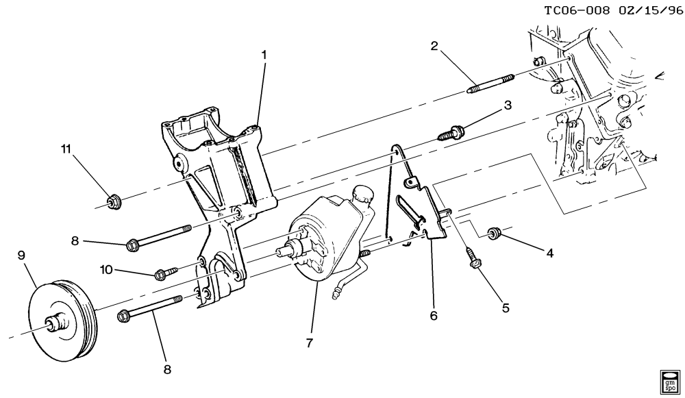

when I searched the part number I found this image. not sure if this shows this piece but I'm wondering if it's part of the bracket directly behind the pump maybe something to do with the slot in that part?

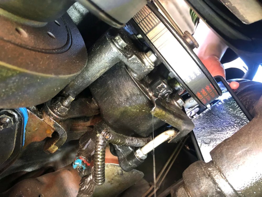

It bolts to the P/S pump to support the pressure hose with EVO equipped trucks.
Thank You very much. That is most helpful.
What Glagulator said makes better sense. that mar is where the the pressure hose was being supported.
Yup, why that 90* tab has an arch innit too. 😀
