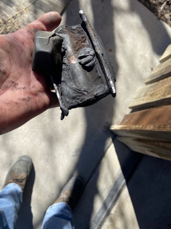

If that is a 30 gallon tank, be right next to $200.00 to fillit up.![]()
