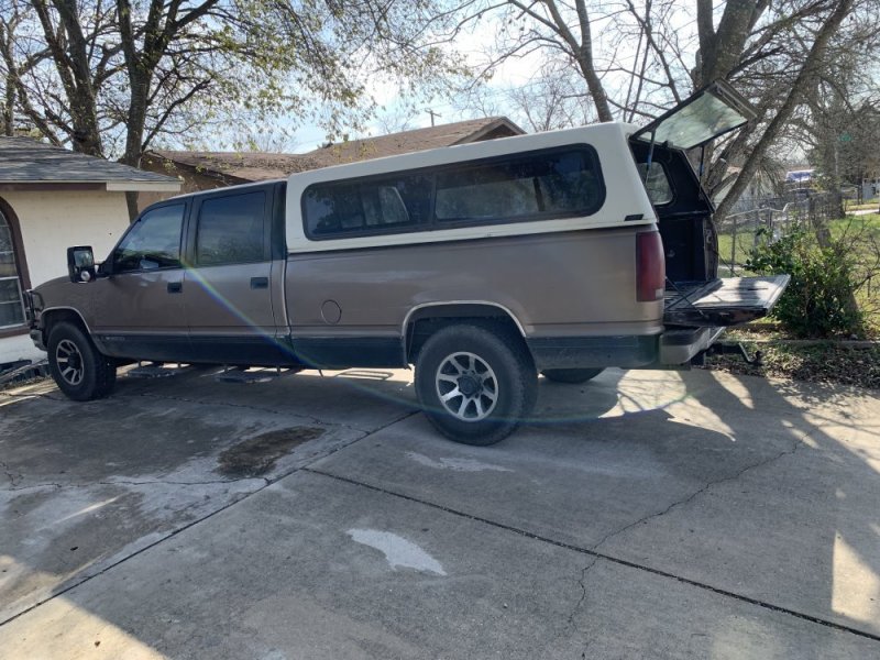

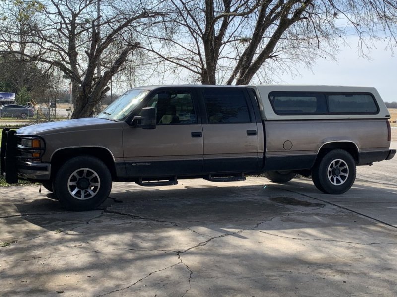

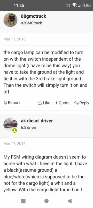

PICS ? ? ? ?Finally got around to putting on the camper shell back on my truck today, it's not a perfect fit as it hangs over the bed rails by about 1-1/2" on each side, but for scoreing it from a junk yard for $35 im not complaining lol. pulled the center cab tail light out and wired in some leads to the cargo lights (bulbs were burned) so I can have the dome light work inside the camper. I discovered that the cargo lights only work when the switch is on and the door is open. as soon as I shut the drivers door, the cargo lights go off. I was hoping to have the switch work the dome in the camper for things like tailgating and when I needed light to see working on something out of the back. Might end up running a separate power wire from the fuse box to the bed for that unless I can figure out how to rewire the cargo light switch.
