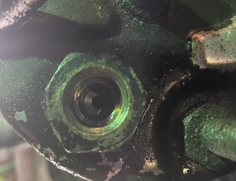

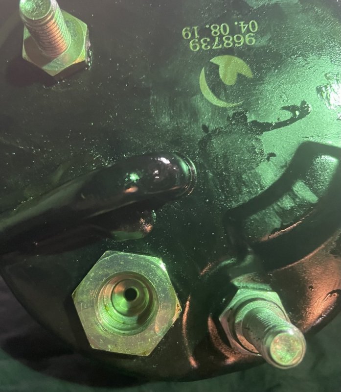

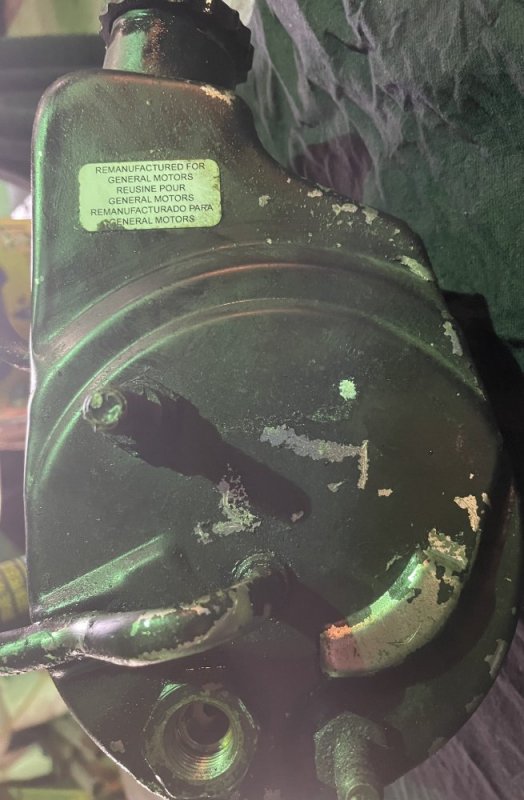

With a hydroboost in the system the orifice size should be a larger size for added flow and set for a line pressure around 1200-1400 psi max. I had this issue with mine a while back finding that the one I had was the wrong one plus ordering a new pump came with the smaller size. I ended up doing a load of research finding out how to attempt to fix it. ended up drilling out the orifice to iirc a 11/32. Don't quote me on that size, I will have to do some digging around to find where I got the info. these saginaw pumps are rated for 1 - 3 gpm if im not mistaken, the size orifice is what sets the flow rate. pressure is adjusted my the valve and spring, but you shouldn't have to mess with that.
Not that would have been nice to know awhile back.... When I changed gear box and power steering pump..about same time I changed hydro boost.. wonder if I got the right ones in there...lol
one way to tell is if you have somewhat stiff steering or the steering gets jerky or acts like manual steering when pressing the brake pedal. but these symptoms can also indicate other issues as well. Like a weak pump or blockage in the system somewhere else, so it's not a tried and true testing method. iirc when I did my research I found most of my info on the jeep forums where others were trying to install hydroboosters on their jeeps along with having steering assist cylinders. they wanted to get the most flow possible from the pump having three components running off a single pump.
Dbrannon,
I have the old reman off from rockauto so I took a couple pictures of the new Napa pump in the same area so does this look right to you?Thanks for your help by the way👍

I don't know much on the electronics for the variable steering, but from the photos the orifice in the old pump looks to be larger. get you a dril bit and use the but end to verify, use whichever is the larger without modifying anything. a 1" socket will unscrew them from the pumps. if using the old orifice as you are unscrewing it, there is a spring behind it. it's not a strong spring, but if not expecting it, it can shoot out and fly a few feet and surprise you plus get lost. clean up the fitting / orifice well and lube the oring before installing. might even swap in the oring from the new one for good measure. use the spring and pressure valve that came with the new pump as it was already tested with those installed. last thing you want to do is use an unknown possibly weaker spring or a pressure valve that might have debris stuck in it which could possibly destroy a replacement pump. you can however keep the old spring and valve when you return the old pump in for a core just in case you want to do any pressure modifications later on.
Thanks very much 👍.I’ll definitely get back to this in a few days as I need to get another pitman arm anyway.That too was sloppy this morning when I got the steering box off.I think it’ll be much better when the replacement box and pitman arm is back in place.I’m amazed the pitman was also bad.I greased it a few times since it was installed but it didn’t last long at all.
The truck might have 6000KM on it since I went through it back in 2014 so it hasn’t had much usage.I replaced everything up front except for the steering box.Has a brand new genuine GM 6.2 660 short block I picked up from eBay back in 2010 or 2011.The guy had three brand new 6.2 engines on pallets in Wisconsin.It’s all equipped with a new DS4 from kr_services on eBay.
Actually This truck never had that wiring connector but I scrapped down a 97 gmc that had that feature on the pump when I removed it.
Yeah, You dont want that feature. It can be eliminated. There are kits available and, I think that the units manufactured before that, the fitting and hose can be salvaged and installed onto the VOV pumps.
