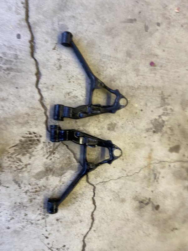

I am picking a set of forged LCAs off a '99 K2500 Suburban today at the LKQ boneyard. So I will have a set for sale when I'm done with this project.

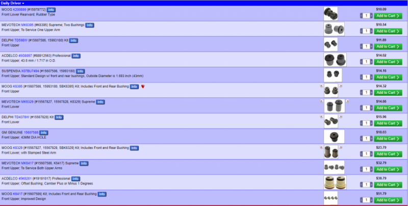

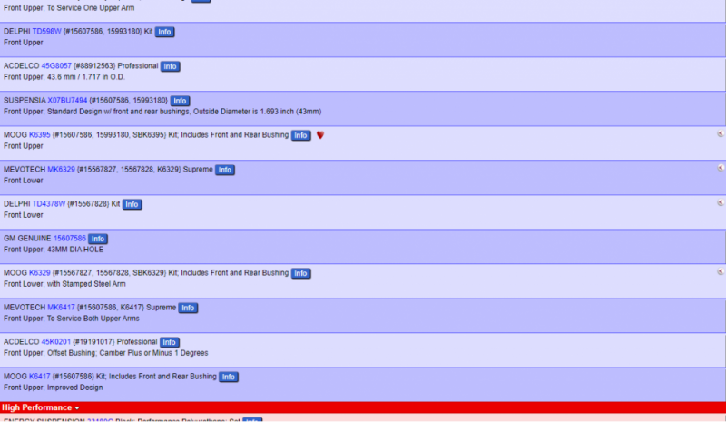

These are the bushings I ordered from rock auto for the forged arms which I never got, so not sure if they are the right ones. At least they're not too expensive if they are not the right ones.

RockAuto only has the lower rear one which is the top one in your second picture. I already have that one. BTW they list it as K200899. I can't find the lower front one for the forged LCA.

OK, I was able to find AC Delco 46G9213A front lower on Amazon for $16.24 each with free shipping. Only problem, I punched the order and the default shipping address is my home in Montana and it will be delivered 12/1. We will be up there 12/6 for two weeks, returning to Fullerton, CA home for last 2 weeks of the year. Given that I'm working next week and the part was going to be delivered next week, regardless of location, this has now become a Xmas project.
I can still go and harvest the forged LCAs, but I was going to do that simply to push out the old bushings so I could match the part. LKQ list the total price at $34 plus tax or about $37. Plus $3 entry fee and shipping costs. Let me know.
Search “46G9213A”, that is the set of lower bushings for the forged lower arms. May not be availocally, but you can buy them online. Amazon has them for example.
ACDelco Advantage 46G9213A Front Lower Front Suspension Control Arm Bushing https://www.amazon.com/dp/B01MUZSX1T/ref=cm_sw_r_cp_api_glt_fabc_WBFXZBMGWS7FPBMFX4PV

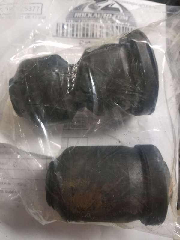

The 46G9213A bushing looks exactly like the one in the Mevotech set I bought from rockauto.

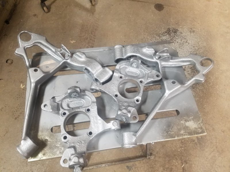

Yesterday afternoon I took the GMT800 lower control arms outside and burned out the old bushings. It wasn't hard but lots of smoke!
I thought I was staying out of the smoke pretty well and it was really windy but still had black soot all over me.
I got the holes cleaned up good while they were still hot and after work today I'm planning on painting them and tomorrow pressing in the new rubber bushings. I've heard that putting the bushings in the freezer overnight and using synthetic brake grease for lube works well for pressing them in. The synthetic grease won't hurt the rubber from what I hear.
Anybody have experience installing the rubber bushings in the forged arms?
I do have a press so hopefully won't be too terrible of a job.
I'm open for suggestions.

I use regular old silicone dielectric compound, like for ICM on the HEI ignitions for lube on any rubber type of components.
@Grisley1958 I second that! Any petroleum-based grease, even synthetic, will deteriorate rubber and polyurethane bushings. Silicone grease does NOT chemically react with either rubber or polyurethane. I also smear the insides of polyurethane sway bar bushings with it before installation to prevent bushing tears during driving as well as preventing bushing 'squeaks' while driving. Same thing with polyurethane control arm bushings before putting the bolt through to prevent steel to poly friction from tearing the bushing or making noise, unless the bushing has a steel center tube for the bolt to pass through, then I use regular old chassis grease on the bolt. But the outside of the control arm bushing I silicone grease before pressing it in.

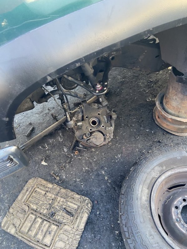

I went to the Chinese Prison to harvest organs for a fellow TTS member:
I was irked that someone pulled the hood off and use it to lay on as it was a rather clean hood and I need one. Oh well, there are more. I'm staring at those black fender flares and thinking mine could use those.
I think if I was going to go to a pick and pack, I would take along one of my many cardboard creepers to lay on.
I would be too lazy to remove a hood to lay on.
Heck, My truck too could use a hood. The one on it is sort of waverly, like someone has pushed, pulled and beat it straight then did a bondo job to cover the rough 💩. 😹😹😹
