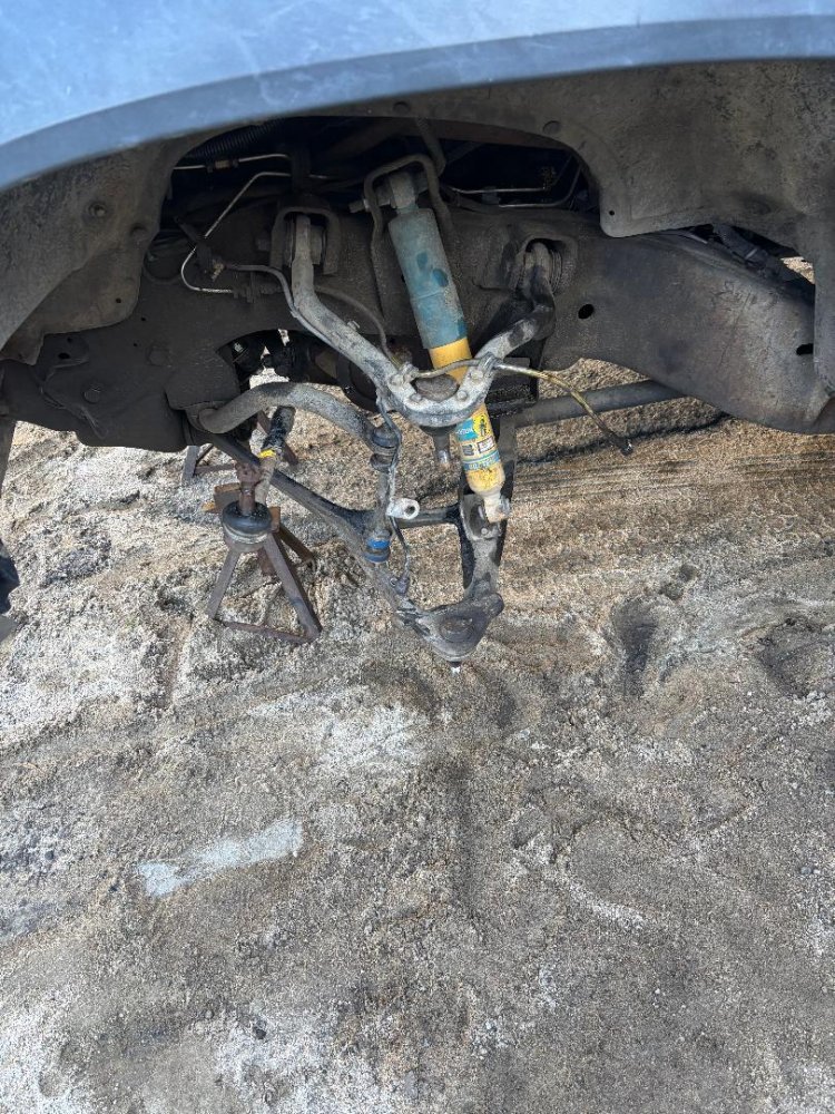

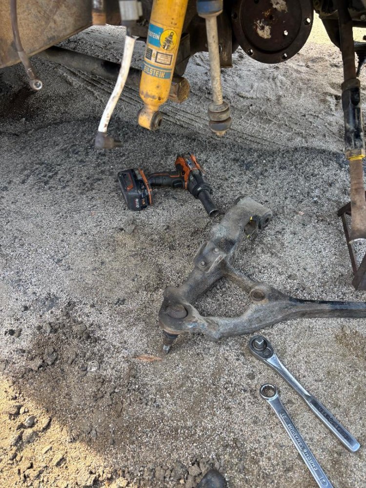

Suddenly this job jumped to the front of the line in front of upper and lower control arms on my wife’s 2014 4Runner. Can’t do any work in the yard as it’s too muddy from all the rain.

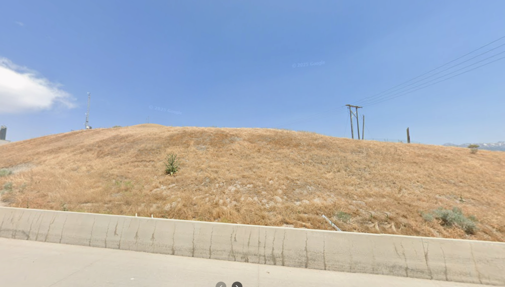

At least, when it happened, you weren't approaching a 90 degree curve to the left with a truck that suddenly only goes straight...through the curve's run off gravel...towards a steep drop off.
Good thing it wasn't at night in late November and snowing...no...wait.....
I said the same. I was lucky.

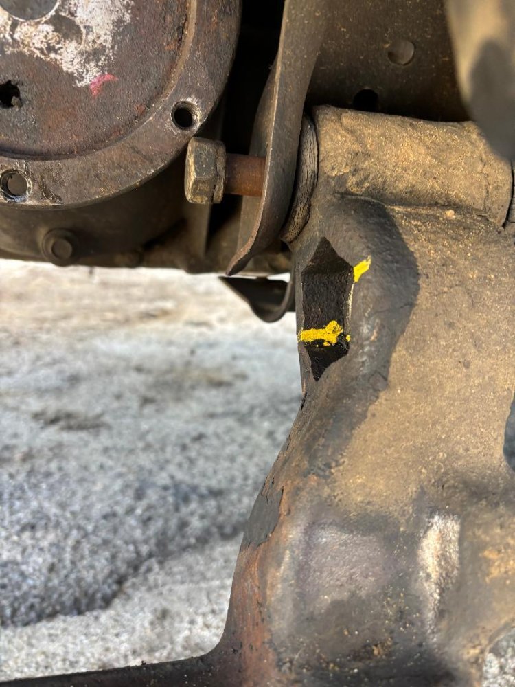

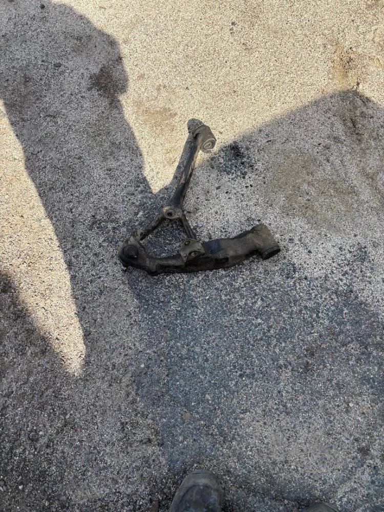

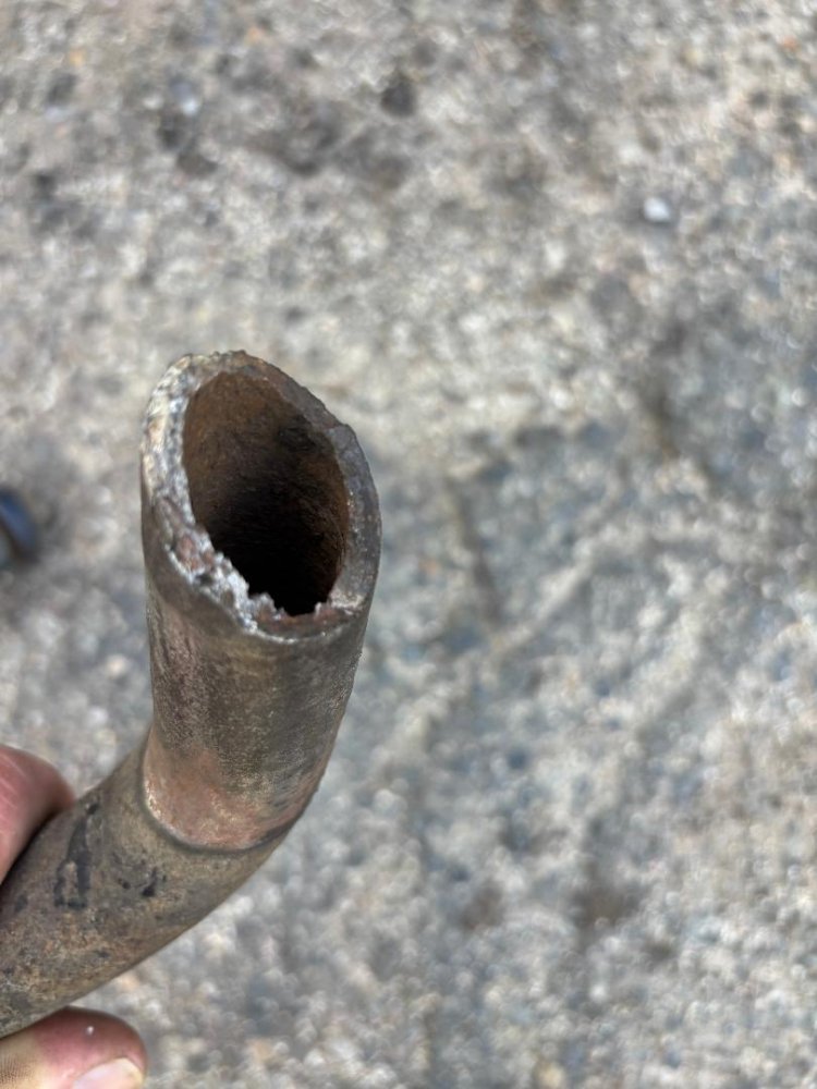

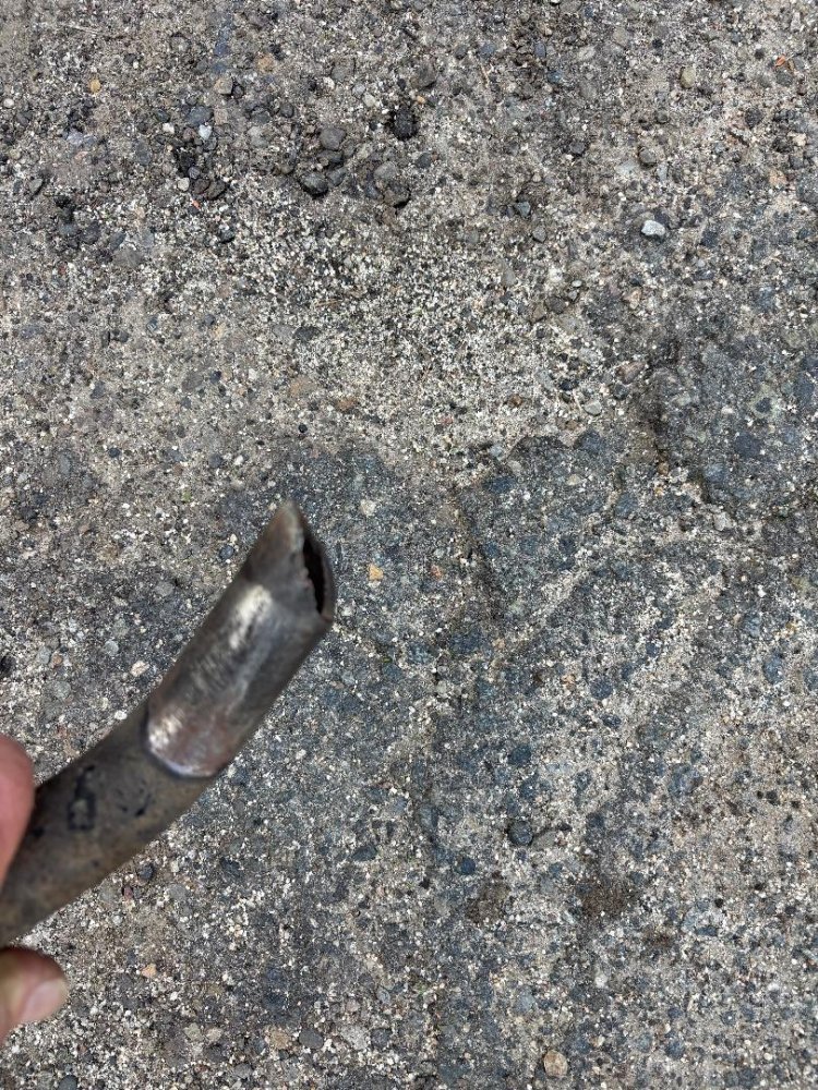

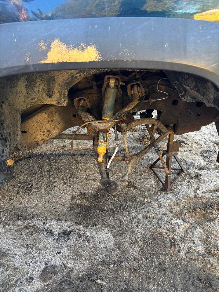

That was a clean break. did you hit something to cause that?

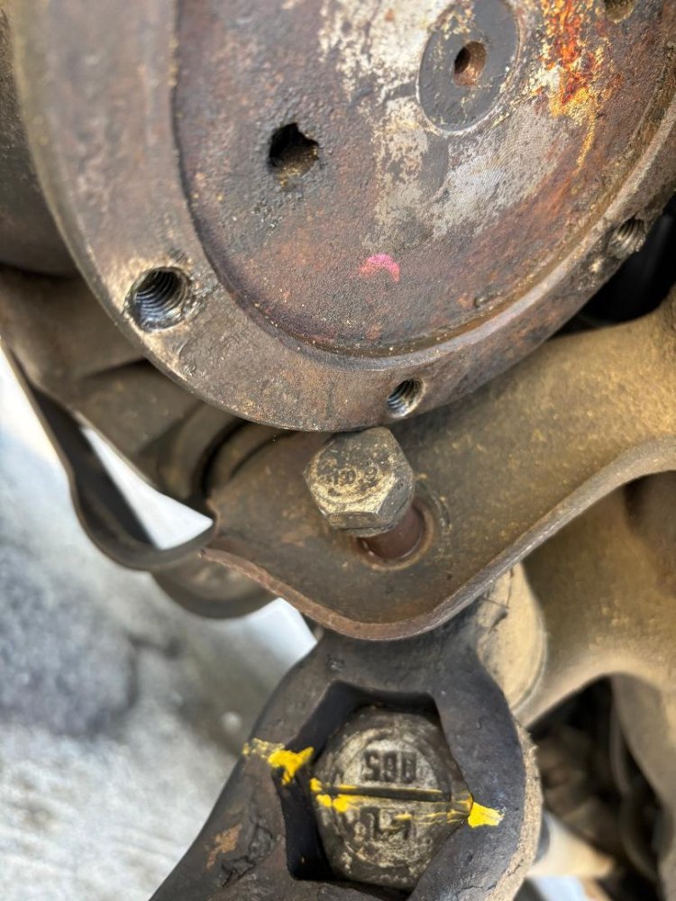

It was due to fatigue. I overdid the ream in the knuckle for the GMT-800 brake conversion and ended up with looseness there which caused wheel wobble and vibration at highway speed and obviously metal fatigue in the tie rod.
Second half of this video shows the play in the tie rod that I was experiencing:
