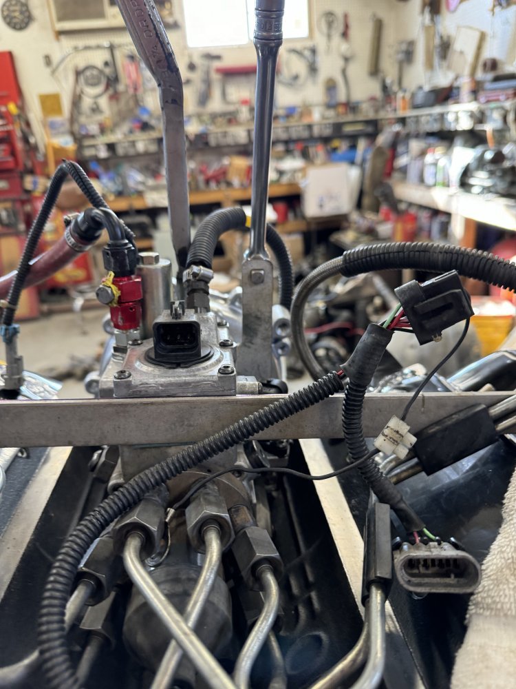

Played with the 93 some while I was charging batteries. wired up the cold advance on the IP so it would work. had to splice in a diode to the fast idle solenoid that pushes on the throttle since I have it wired into the AC so it bumps the idle with the AC running. tested it out to make sure it wasn't going to back-feed into the relay I had for the AC and electric fan. That all seems to work fine.

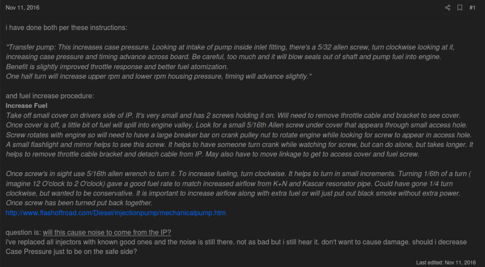

I also was reading up on this 93 and found what exactly the PO did with turning up the fuel on the IP that's in it. both the transfer pump adjustment and the fuel rate adjustment have been moved. increasing the transfer pump pressure (adjustment inside the IP fuel inlet) also limits the amount of timing advance the solenoid on the IP gives. this would explain why when I manually energize the cold advance solenoid it hardly changes anything other than me seeing fuel flowing faster in the clear return line.
I wonder if I need to attempt to un-do this so it can work properly. I also need to figure out if a fella like me with limited knowledge can get it done without pulling the pump. Maybe @Will L. and @Rockabillyrat can give me some input. whether I should attempt, and if / how to know it's close the normal again.
Last night I searched up and down on the innerweb for the instructions he used on the transfer pump but could not find anything about adjusting it, even on a test bench.
Here is the link to the thread and a screenshot of the post.
DB2: Increase Case Pressure-Turn Up Fuel: Questions...........
i have done both per these instructions: "Transfer pump: This increases case pressure. Looking at intake of pump inside inlet fitting, there's a 5/32 allen screw, turn clockwise looking at it, increasing case pressure and timing advance across board. Be careful, too much and it will blow seals...
