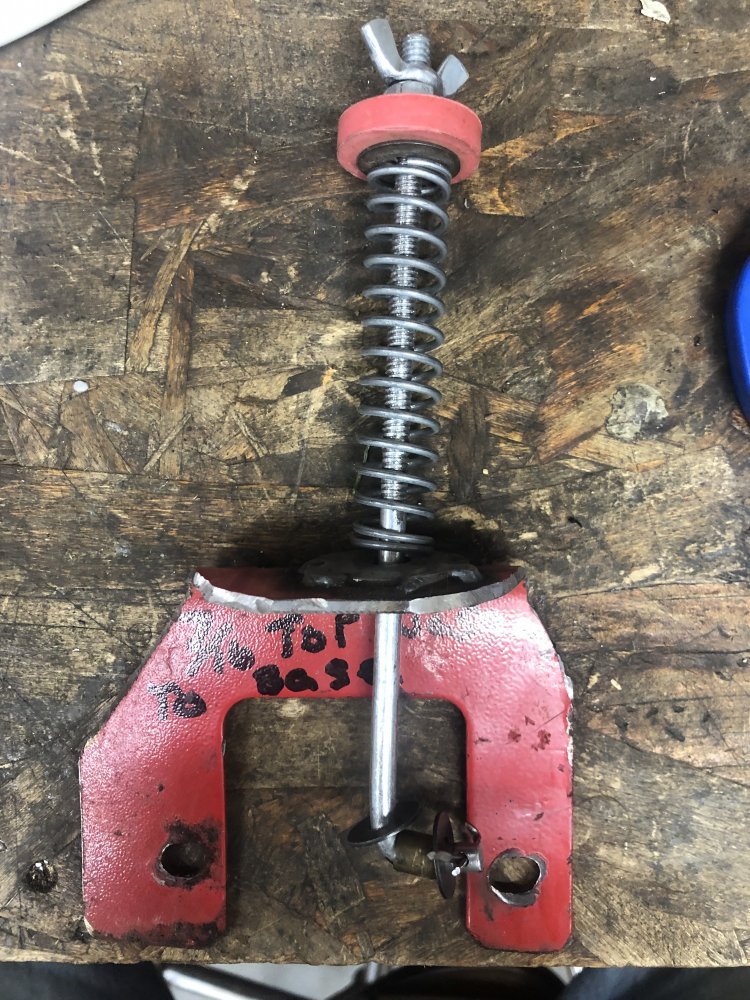

Cleaning out under the seats of the truck.
Come across this manual waste gate controller that I had built from some odd n ends that was laying round.
I used it for a while until I got enough to buy a vacuum pump. Now with the ATT turbo I no longer need this device.
If someone needs one a these then let Me know, I’ll ship it.
It is marked 7/16ths from the top washer to the base and that always got the boost real close on My truck.
This is made for the GM8 turbo. I’m sure the spring, rod, washers and etc could be used to build a controller for any of the other model of GM turbos.

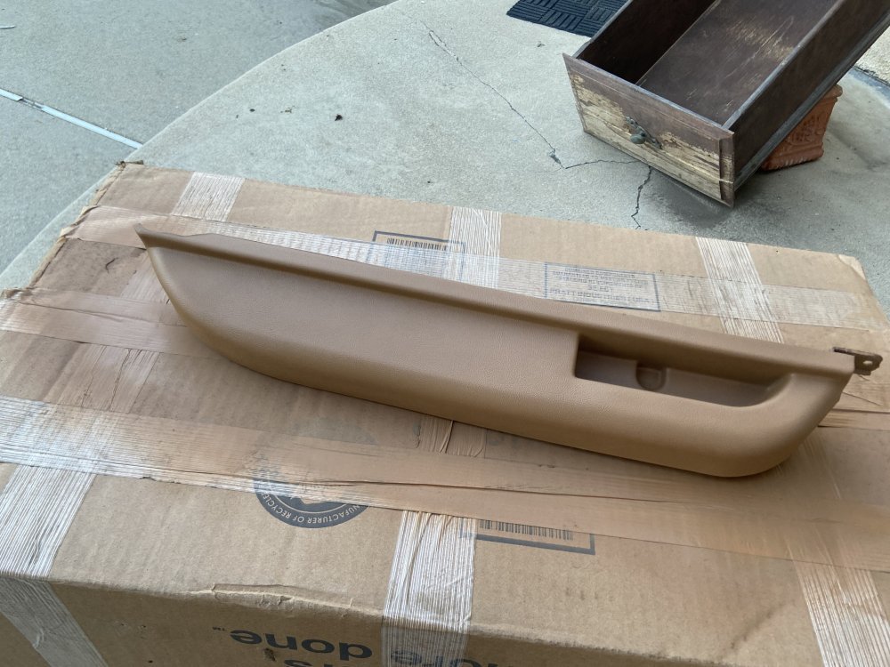

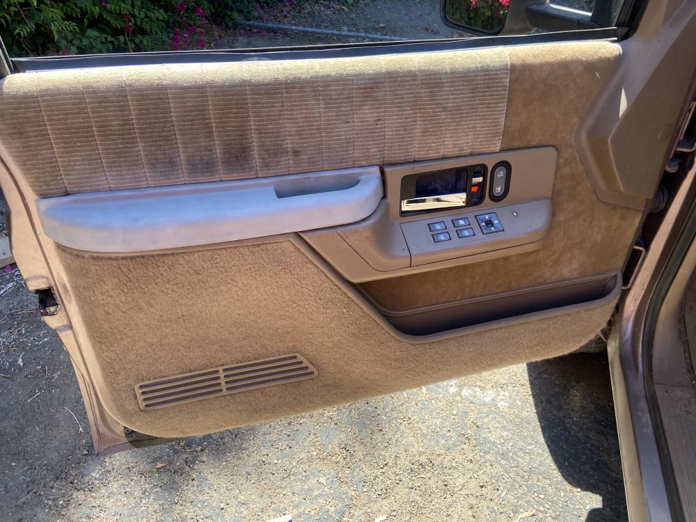

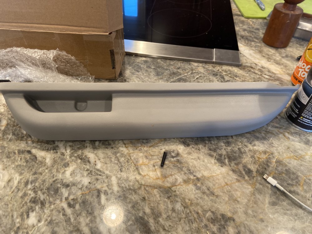

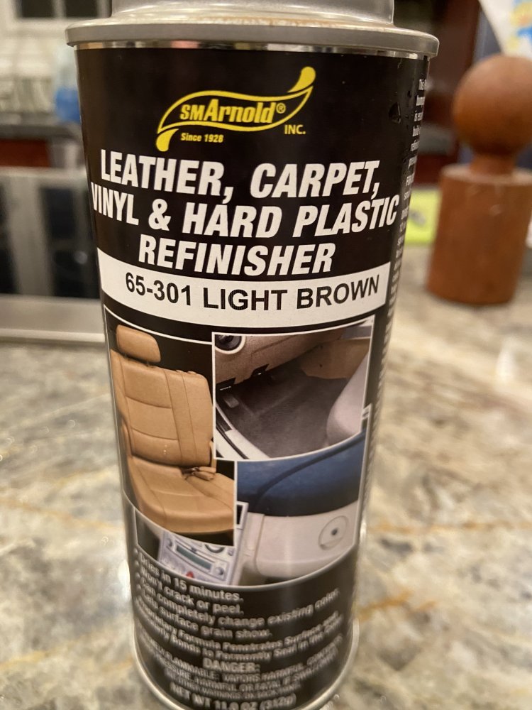

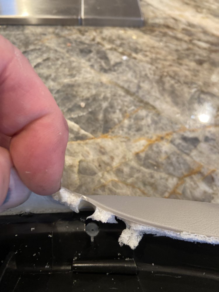

Got the arm rests for the ‘94. The passenger side had one of the plastic pins broken off, so I will need to send it back. I sprayed the other with leather/vinyl refinisher AND the stuff does not stick.
View attachment 76889View attachment 76890View attachment 76891View attachment 76892
the new arm rest material might be empregnated with some kind of oil or preserving stuff to keep it from dry rotting while sitting in a warehouse. try some rubbing alcohol by weting a clean lint free rag and giving it a good few wipes. do it 3-4 times after letting it dry. then try the vinyl paint again.

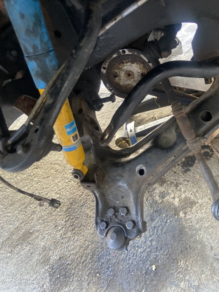

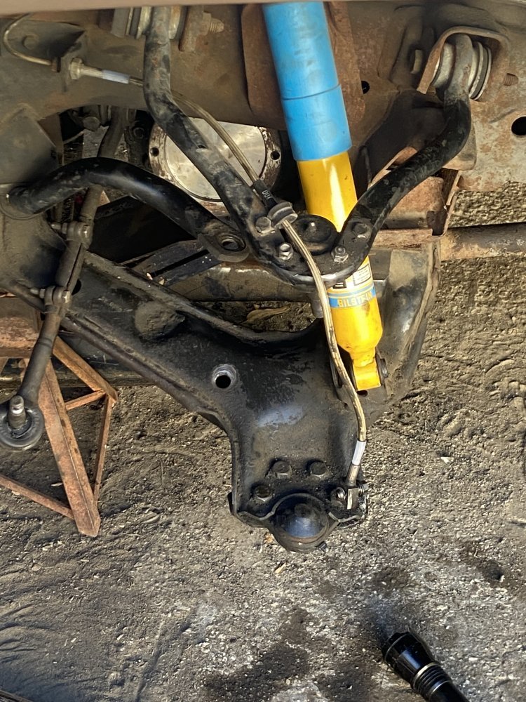

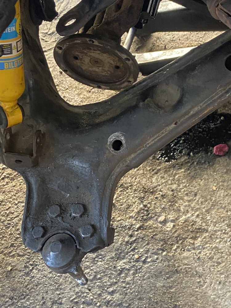

Trying to swap out the LCA’s on the ‘94 Suburban. Down to removing the rear bolts on the LCAs. No one answered in the suspension forum, so I will ask here: DO I HAVE TO DROP THE FRONT DIFFERENTIAL TO CREATE THE CLEARANCE NEEDED TO REMOVE THE REAR LCA BOLTS?
OK, got all the bolts out holding the LCAs. Remind me how to drop them? Last ones I did in the wrecking yard were forged and they dropped right down.
View attachment 77035View attachment 77036
Watching videos on this and I need to remove the torsion key bolts. I have the tool to hold the torsion keys. Just paint a white mark on the torsion key bolts so you know how far back they go in on the reinstall.
Once I drop these things, it’s time for grinder w/ cut off wheel to cut them off the bars. Once they are off, the reinstall should go fairly quick. The forged ones never stick to the torsion bars.
This work just beats you up and I am using a cordless impact on most bolts.
