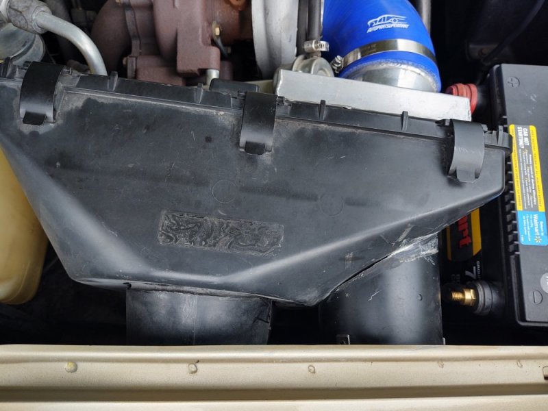

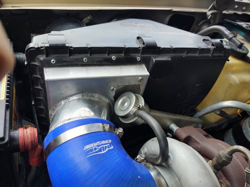

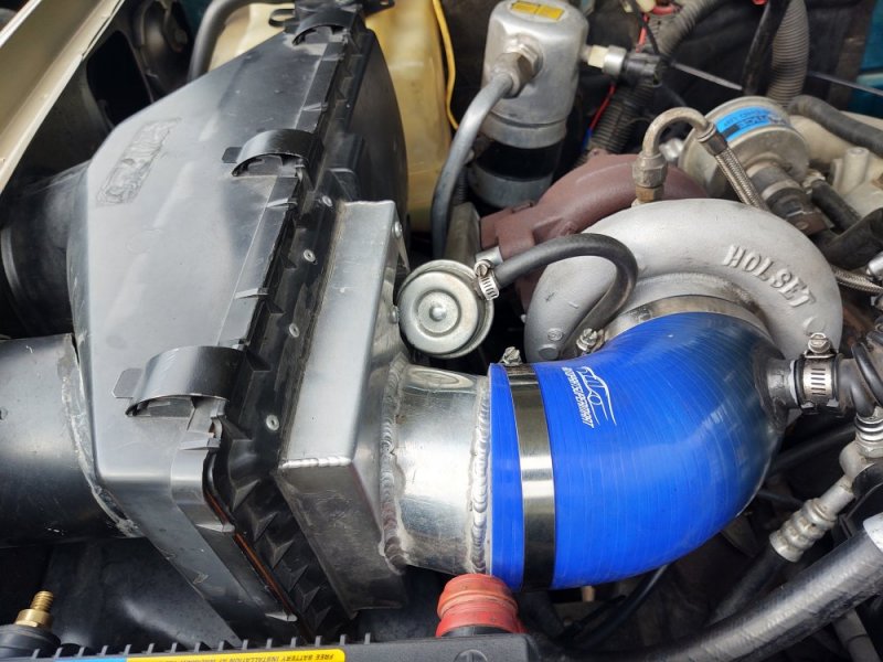

I drilled a 4" hole in the fender, then attached a piece of sewer pipe. Cutting the hole in the back of the airbox was a challenge, and my alignment is off about 1/4". I then formed the aluminum portion and had a co-worker tig it together for me. I figure I doubled the amount of air available to the filter and (for the most part) the air only has the make 180deg of turns before it reaches the turbo (90 out of the fender and 90 through the silicone elbow). Unlike the k47 factory box and the aftermarket units which require 360deg of turns.
@93detroit I like this approach. I have been running the factory air box with a spectre cleanable filter in there for a bit without any issues but my box keeps popping out of the tube that connects it to the inner fender leaving a gap open to suck hot air in. the rubber 90 is 27 years old now and is getting rather hard to flex. it's a PIA just to check the air filter. having to loosen everything and pull the entire assembly out.

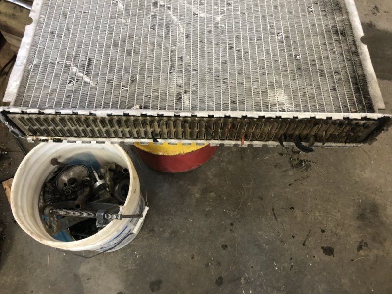

Pulled the tanks from the radiator I removed from the 2000 K3500.
I have never used any type of silicone sealant on this engine. There also is some kind of a rubberish looking material, thinking it might be the coating from offa some original thermostats. Didnt look it over real well. Maybe later today or tomorrow when the back gets better.
I did replace the radiator with a new thermal coated Champion from Twisted Steel Performance.
Expand the pics to get a real good look at what all is jammed in there.

The thin and shaped black rubber pieces is from the OE thermostats. Dont know why they would peel like that.

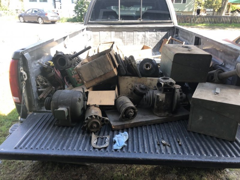

Have a bunch of old electrical equipment, motors, generators and all kinds of junk. Going to break it down best I can, without too much trouble, then haul it in.
If anyone wants any old Delco generators, speak now cause tomorrow I’ll most likely not get started on it until tomorrow.

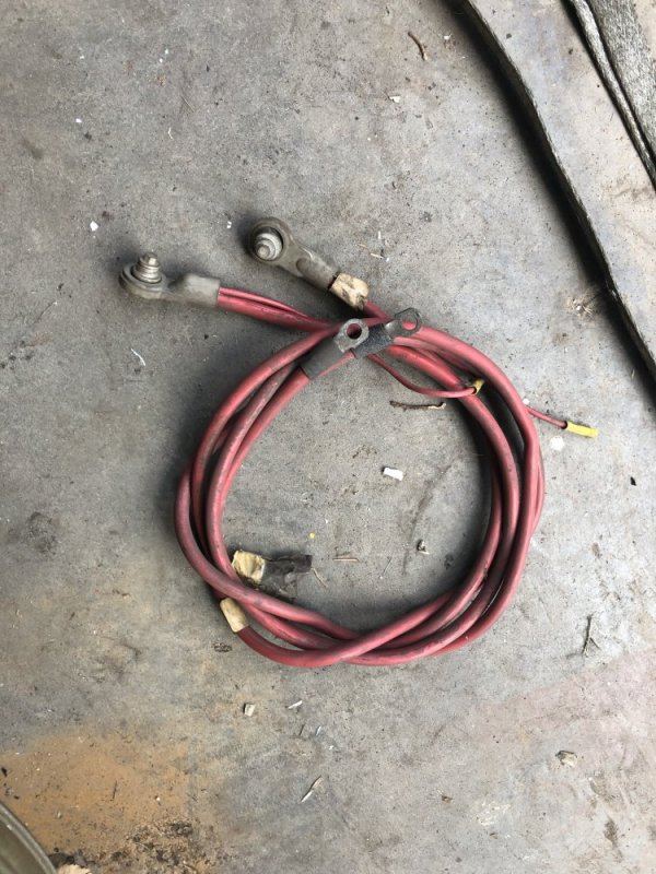

A phew new battery cables. The long ones laid out are + top post but could be squeezed down for a negative. Those are 63” long. The shorter ones both have a N marked on the post end. They are 48” long. The two coiled one looks to be a + and the other a - and they are heavier dutier than the others and are 48” long. Grounding straps is 36” as is the side terminal cable. Aint tossing them cables. 😹😹😹

I'd hang on to them battery cables for a rainy day if I were you! it never fails for me... haul all my scrap collection off and the very next day I find that I needed something I tossed. especially when it's something not easily found and me thinking "I'll never use that"
