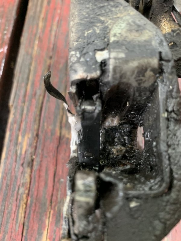

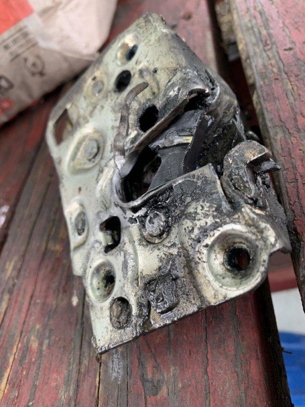

Here’s a couple of pics of my old latch. Look at the grove that on the inside!! I cleaned it up some with brake cleaner to see just how banged up it is!!
View attachment 74097View attachment 74098
YUP.She gone!
Unless the hinges have been replaced, there is but one adjustment. Straight up and down and bottom in/out and same with top.haha! yea it has seen better days lol. the new junk yard one looks much betterI went out and looked closely at the door and held the handle up while sliding it open and closed again. it seems the striker is riding on the upper part of the latch like the door is sagging a tiny bit. I wonder if there is any adjustment in the striker or I need to look at the oversize bushing and replace them again.
