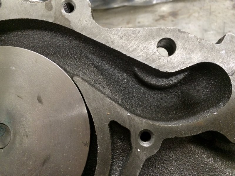

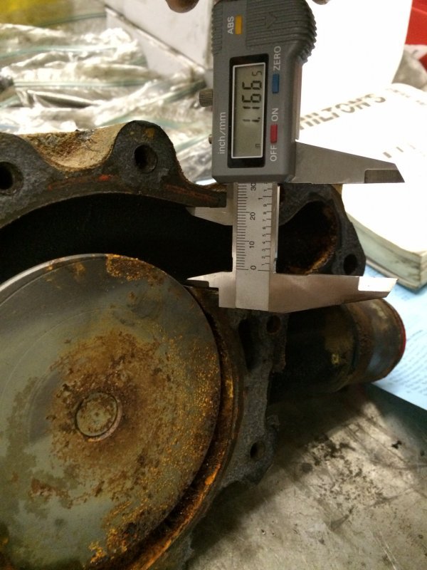

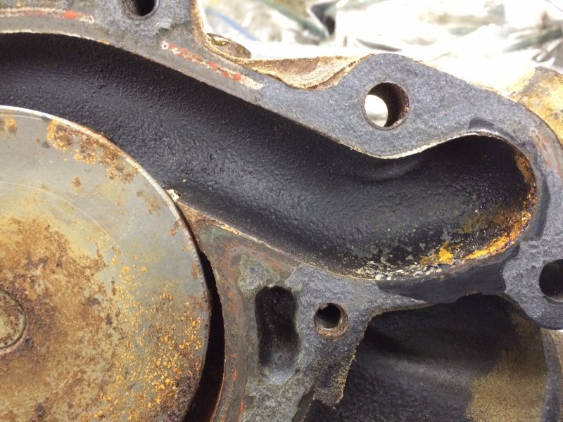

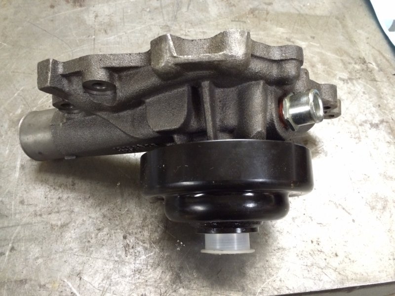

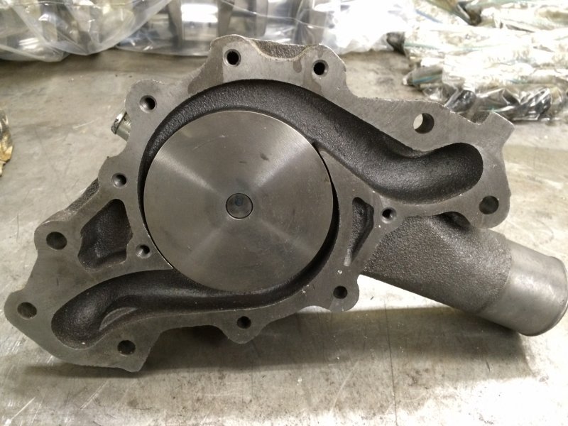

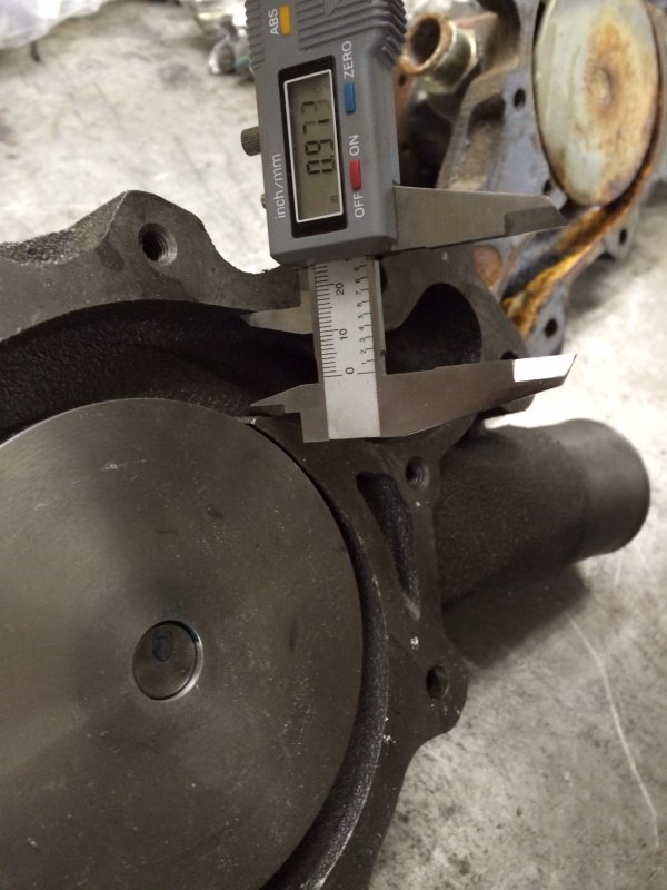

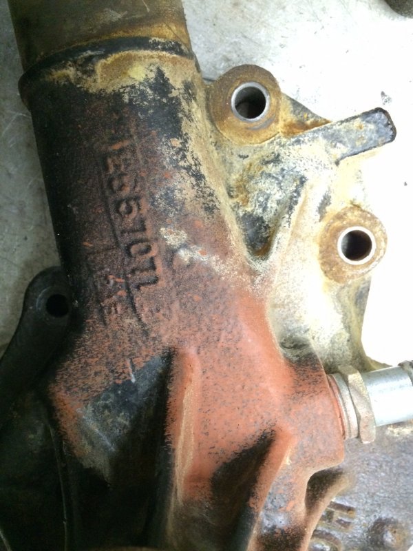

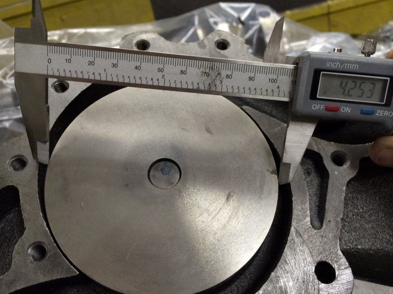

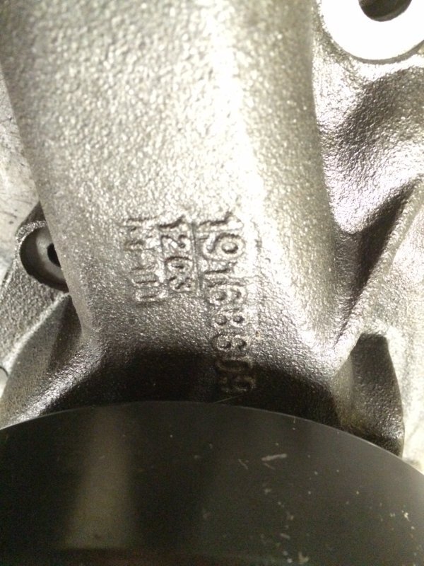

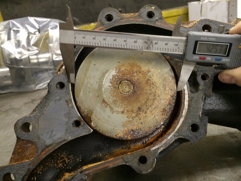

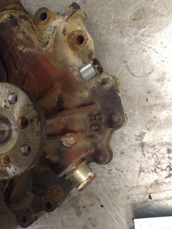

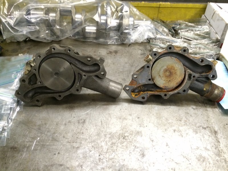

Also I just got a 2000 water pump for my build that is supposed to be the one Heath recommends. I took some pics of it next to the HO pump that came on my Optimizer if you want to see. I don't want to pollute/hijack your post so I'll only post them if you want me to.
Post away this way others can see what it is too.

Ok here ya go. Let me know if there are any other pics or dimensions you want and I'll get those for you too.
00WP1.jpg 00WP2.jpg 00WP3.jpg 00WP4.jpg 00WP5.jpg 00WP6.jpg 00WP7.jpg 04WP1.jpg 04WP2.jpg 04WP3.jpg
