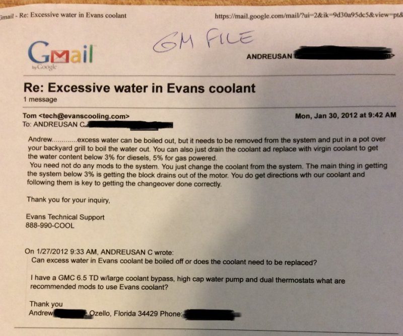

Use a refactor meter reading of 3% & under is good. I have an old email from their tech dept "I asked if I needed to add water 'say because I was somewhere remote had a leak fixed it and added water' do I need all new EVANS or can I remove the water by boiling it off at a later time then just add enough EVANS to fill system? Response, "water can be removed from EVANS by removing it from cooling system and boiling off the water" haven't tried this because never had a leak or excessive water show on meter.
