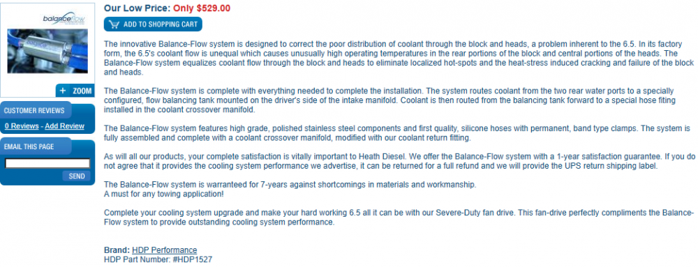

I still wish there was some rebuke of the original Balance Flow kit in writing. There was a nod to it in the beginning of this article, as well as the multiple temp probes, but no direct mention and no mention of it not actually performing as sold to do. Just crickets...

Yer talking about if someone would- but we did and did it years ago. Gm tried every configuration conceivable using the rear head ports and heater hose routing. Some folks figure they just wanted to spend beyond ten million bucks just for fun. Chris has a descent theory they swapped just for the speed of assembly line but it doesn’t account for the plumbing alternations, all the different thermostat crossovers tried, etc.
