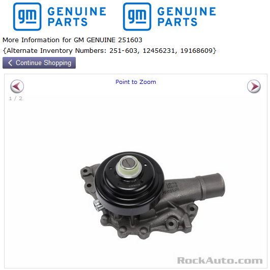

the AC Delco pump from a 2000+ 6.5 will get you all the updates that GM did balancing the flow. This will get you the spin-on style pulley where you will need to use a different clutch. two good options here. If you go with the Hayden thermostatic clutch you will need ether the 9-blade steel fan (I have one available) or the d-max plastic fan. the second option and one of my favorites is the electro-viscous fan clutch coupled with a Hayden electric fan controller. Just lookup the application for a 2010-11 3500 express van with the d-max engine for both the clutch and fan blade.

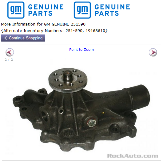

not sure about the balance flow but iirc the best pump was deemed as the AC Delco 25-1603. it's shown on the 1999 and 2000 6.5's on RA's site. 98 shows a Delco 25-1590 which I am not sure what the differences are between the two.
Correction: the 98 pump 25-1590 is a bolt on hub for the clutch and has two ports on the pump the 99+ 25-1603 is a spin on hub with pulley and only has one port. I need to look at mine, but I think mine came with two ports and a spin on hub.
it wouldn't surprise me if the hubs could be swapped since they are both press fitted on the pump shaft
