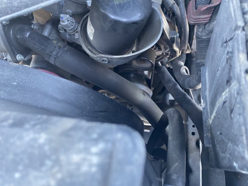

Job is done and no coolant leaks. However, what I thought was an oil leak dripping down over the starter, is a fuel leak. Probably an injector line or return line. Will have to tear that inner fender out and get after it next weekend. Probably should order some return lines. F!
Fuel leak definitely not FFM. Completely dry underneath it.
It's coming from the front passenger side of engine. Dripping onto frame and drips mainly from the front lower control arm bracket to the ground. I replaced the return line from the front injector to the hard return line. Old was cracked, but new one did not stop the leak. I cleaned up the frame and I can see it pooling down the frame starting from this rubber lined clamp I have for the glow wires and a cable to the starter. I'm going to pull that clamp, clean it up and further trace the source.

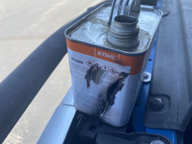

Yeah, nothing to be embarrassed about there. Things like what I did on wife’s fj cruiser oil change- that is worth being embarrassed over. Oil filter is upside down and there is a drain hole for the spilled oil. I put a catch can under it. Finished work and forgot it. 2 weeks later I here a CRAZY sound. Popped hood and found this.B1790485-D3CF-4B71-A7C5-5915B2FBDA5A.jpeg332DB31D-03E1-4D54-93AE-EAFE5E766419.jpeg
