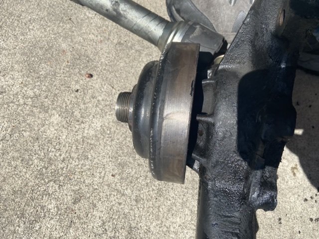

Just noticed after backing the truck up to the garage that it did not leak much at all over night and it was pointed slightly uphill. When facing the garage pointed slightly downhill, it would lose at least 1/2 gallon overnight.
That's a sure sign the WP seal is gone and the bearing ain't far behind.

No leaks from any hoses. It was dripping down onto the Fluidampr HB. Based on inspection of the new water pump, it's coming from the weep hole.
Grab an inspection mirror and a flashlight and take a gander at the weep hole underneath the snout of the water pump. Even if it isn't leaking at the moment, after seeing the pictures you posted with how big of puddles it left and the uphill/downhill symptoms you described, prior leaking from the weep hole will be very evident by light greenish-white streaking and/or crystalline ethylene glycol deposits around the weep hole.
Another sign of impending catastrophic water pump bearing failure is when the engine is idling, can you see any, even the slightest bit of, wobble in the w/p pulley and/or pulley bolt head? If any wobble is present you are on borrowed time.
