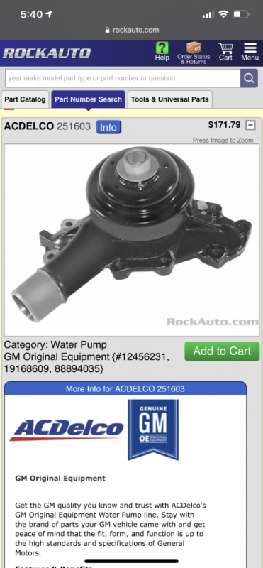

The one Twisted Steel Performance (Chris) shows at the bottom of the list is the correct one.
88894035 - 251-603 - ACDELCO 6.5 water pump-screw on fan, stamped impel.
(19168609, 12456231)
Send him a pm for how to order it and be done without worries.

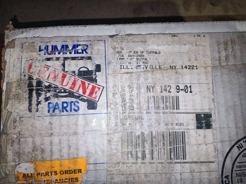

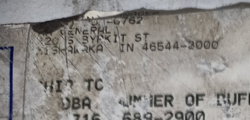

Got a pump today..

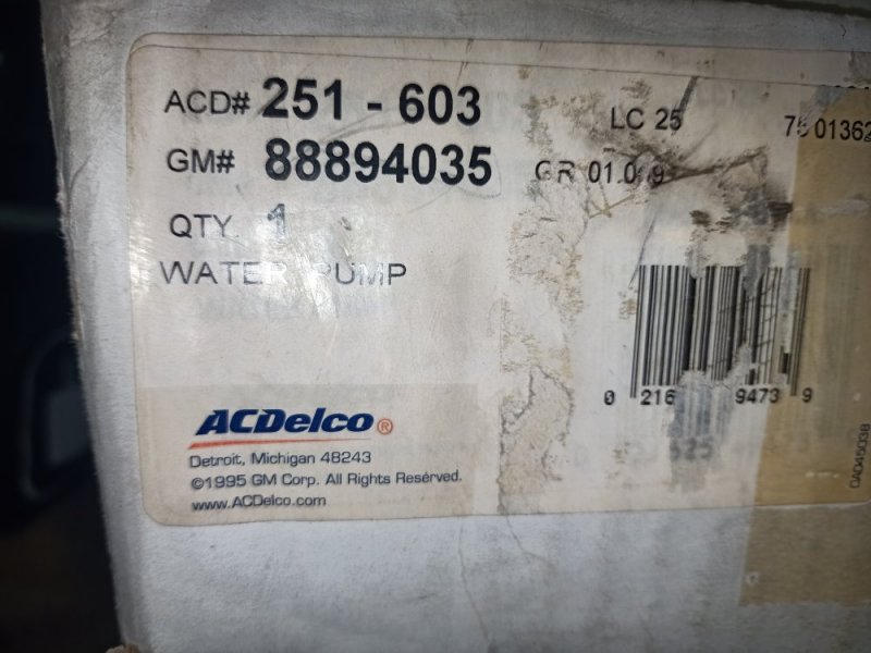

Ordered "ACDelco 251-603"

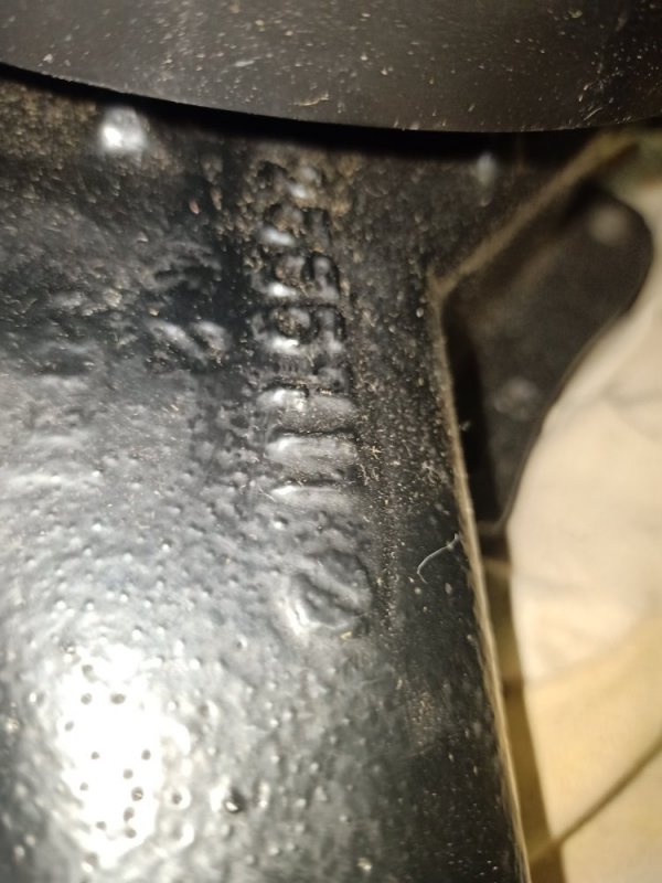

The number 2555711 is cast on the pump.exactly the same as on the Hummer.
View attachment 70188View attachment 70189View attachment 70190
Check that pump over good, I just noticed the sticker on the box showing AC Delco and the year 1995! all the newer delco labeling has a qr code that identifies it not to be counterfeit. if it just has simply sat on a shelf somewhere for that long I would be weary of the internal seals and such. if you look on the ac delco site they show the new labeling types.
The year is the copyright date for the AC Delco name:
ACDelco[edit]
1995 saw a re-branding of AC-Delco. The hyphen was dropped and ACDelco received a new logo and marketing initiative. The "AC" bullseye and semicircular Delco logo disappeared from product packaging
