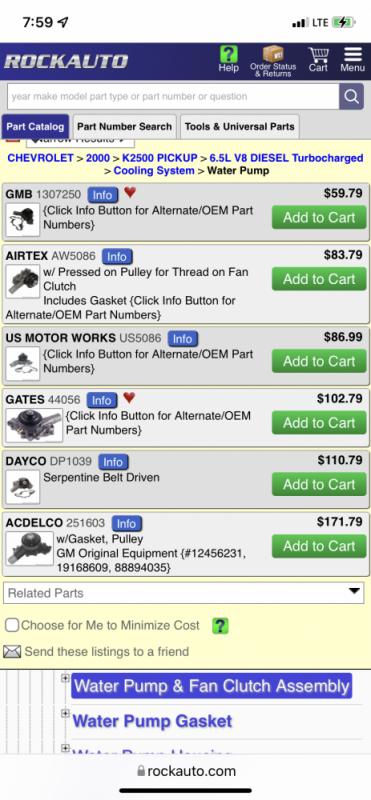

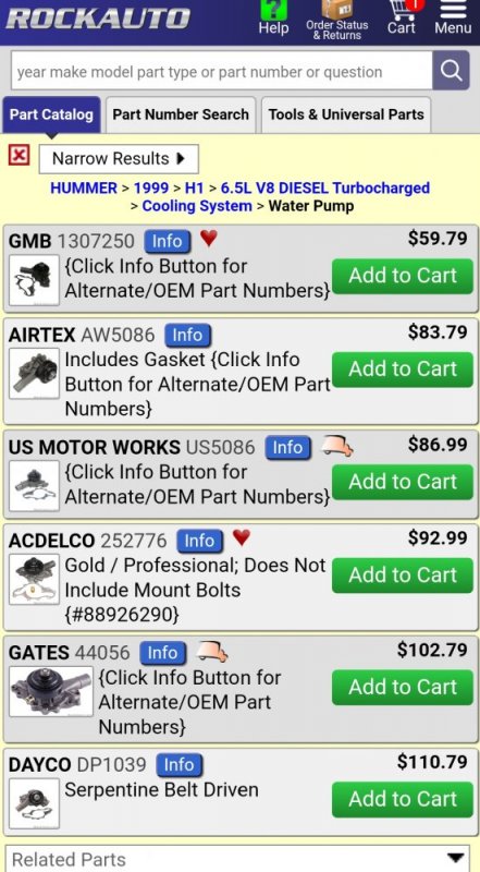

@denata
The one Twisted Steel Performance (Chris) shows at the bottom of the list is the correct one.
88894035 - 251-603 - ACDELCO 6.5 water pump-screw on fan, stamped impel.
(19168609, 12456231)
Send him a pm for how to order it and be done without worries.

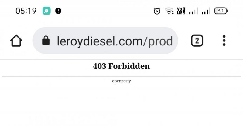

By the way, the link is forbidden for me.
