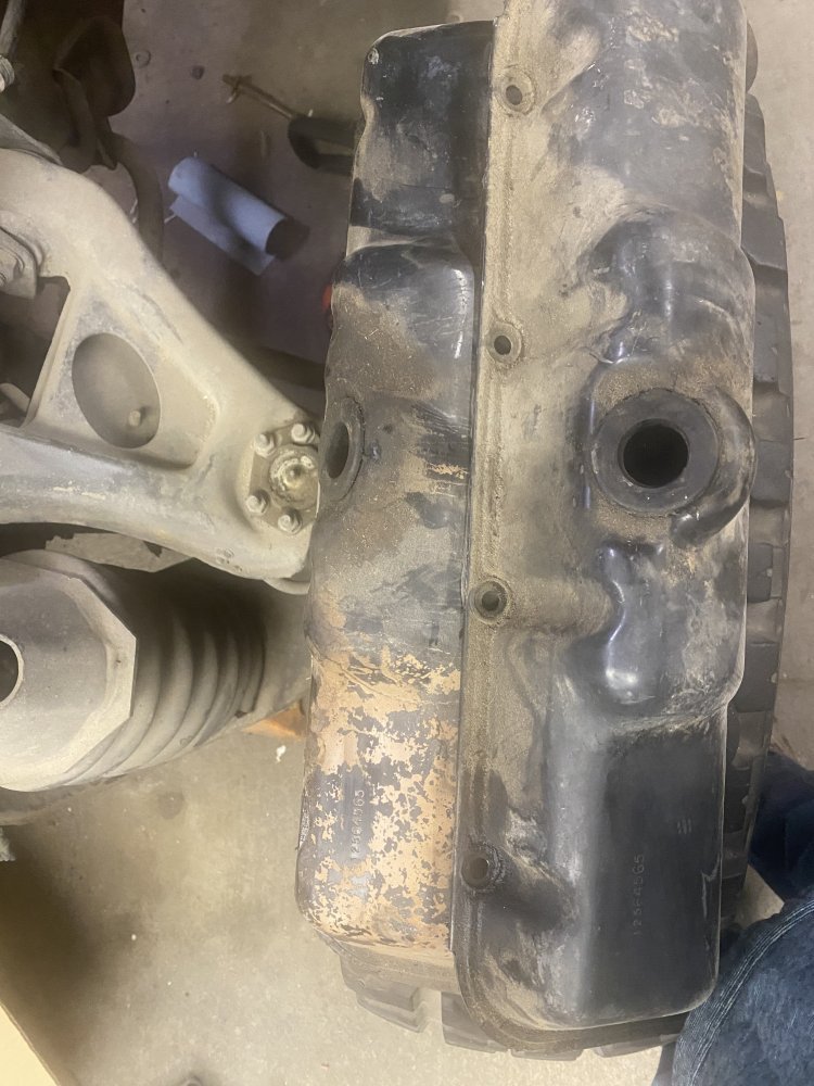

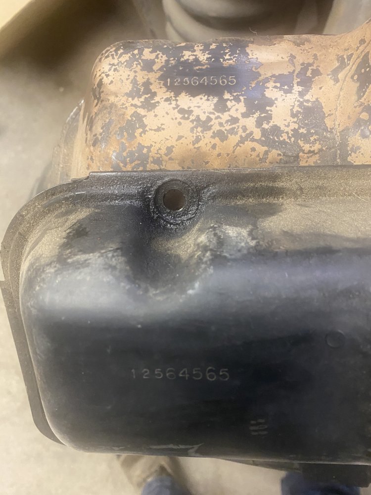

Can someone post a pic of their valve cover showing part number from a pickup?
I have pics of a 2004 GEP optimizer and a 99 GM van with centermount turbo- they are the same.
Just wondering if the normal pickup one is the same. I am using the one with the breather hole..
THANKS!
Yeah- that is what it seems to me. I looked at an 88 6.2 in a pickup and it’s identical too.
But no telling if it got them swapped while it was still a mining truck in Colorado.
I was hoping to get pics of the matching part number from a 90’s pickup to be 100%
I know GEP bought the stamping dies and all from GM. But hilarious to me is even the number 6 being bigger in these is identical- from actually a 99 gmc Savanna (the dirtier one) and my 2004 GEP optimizer. Definitely same die stamp. Haha

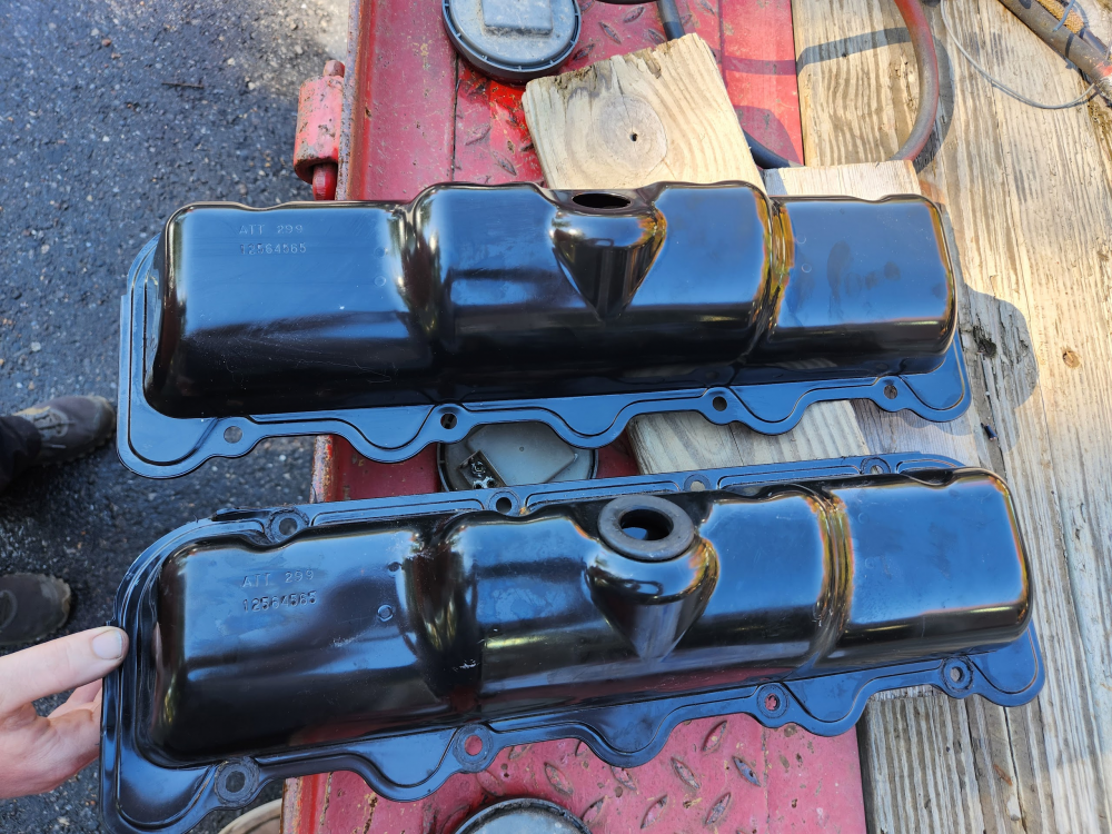

Thank you Will for starting this thread. I have to admit that he likely did it to answer my question - which was "does the H1 have a special passenger side valve cover?" I was told by a H1 expert that the driver's side was the same as the 6.5 truck valve cover, but the passenger side was different. Well, I took a leap and ordered a GM Genuine valve cover for half the cost of what the Hummer parts sites were charging, and low and behold - they're the same. Same part numbers, same dimensions, same finish, same everything. Pictured is one "Hummer" valve cover and one "6.5 Truck" valve cover.
I didn’t think so. Thought maybe There was the possibility they might have done something wonky for the centermount vans and hummers to deal with the ridiculous intake manifold-
But when I compared the 99 van engine I have to mine- nopers.
There is several parts suppliers that simply charge a ‘hummer tax’ = if it says hummer they charge 25% more. SMH

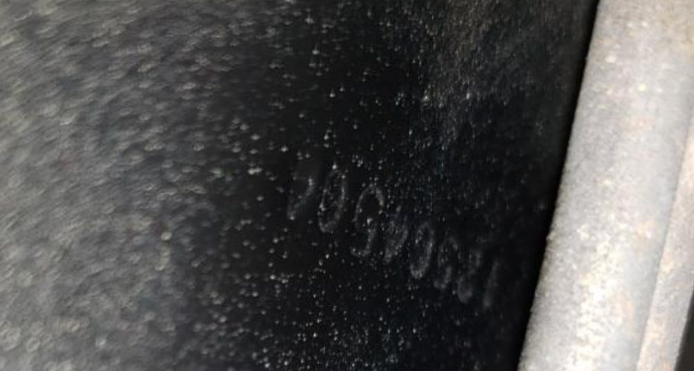

Passenger side valve cover from a 2004 GEP motor - sorry upside down and under fuel lines. Without breather hole. No "GM" stamped in cover like the driver side cover from my pickup. 12564564, I believe.
